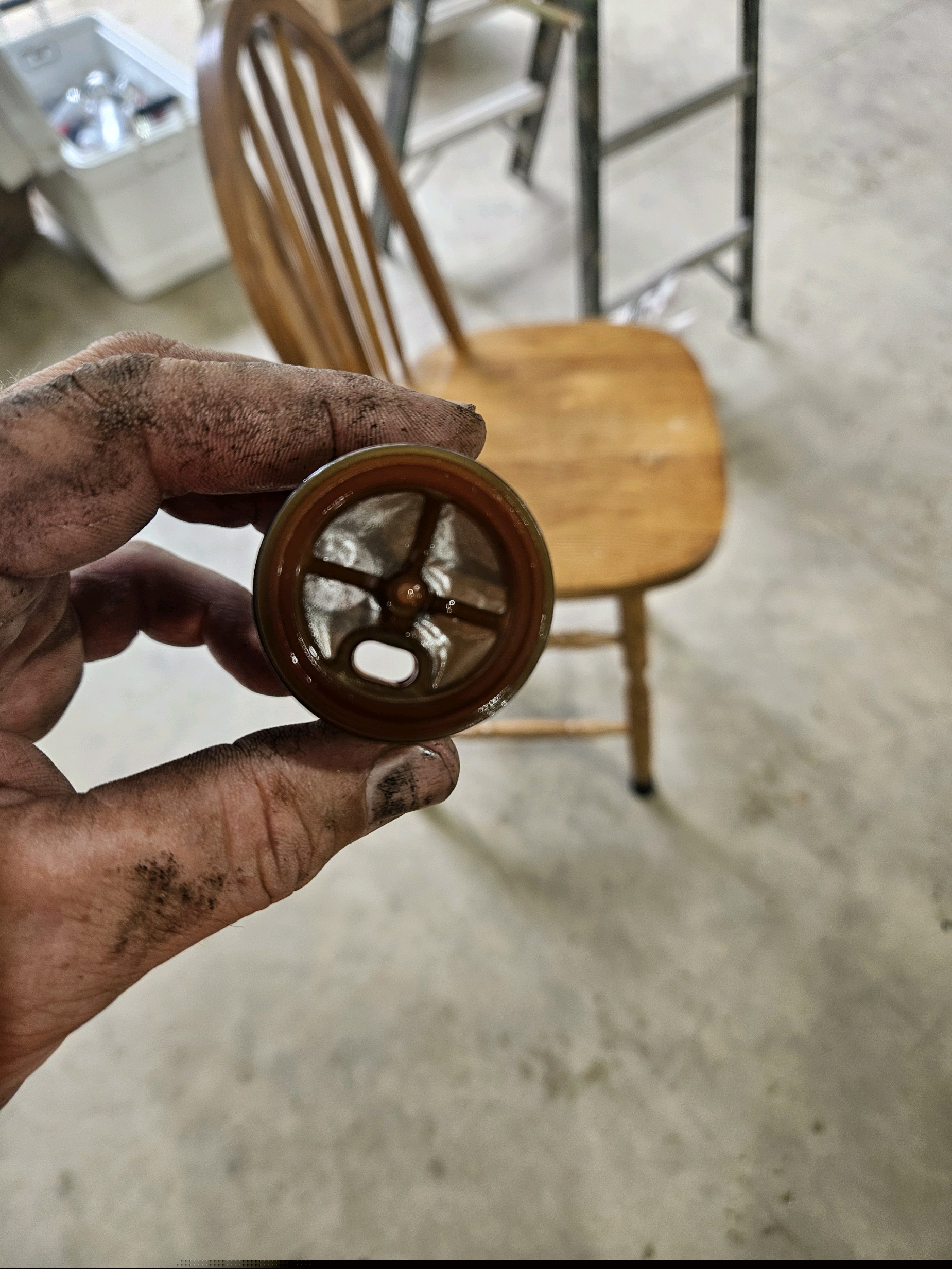

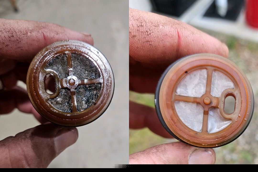

I was thinking last night, it's gotta be the VST, so I pulled it all apart just now, and everything seems clean in it. I drained it first into a clear container and I'm not seeing any water or sediment.
Could I be looking at a low pressure fuel pump issue or high pressure?
It runs great other than the stutter, and then flawlessly afterwards.
