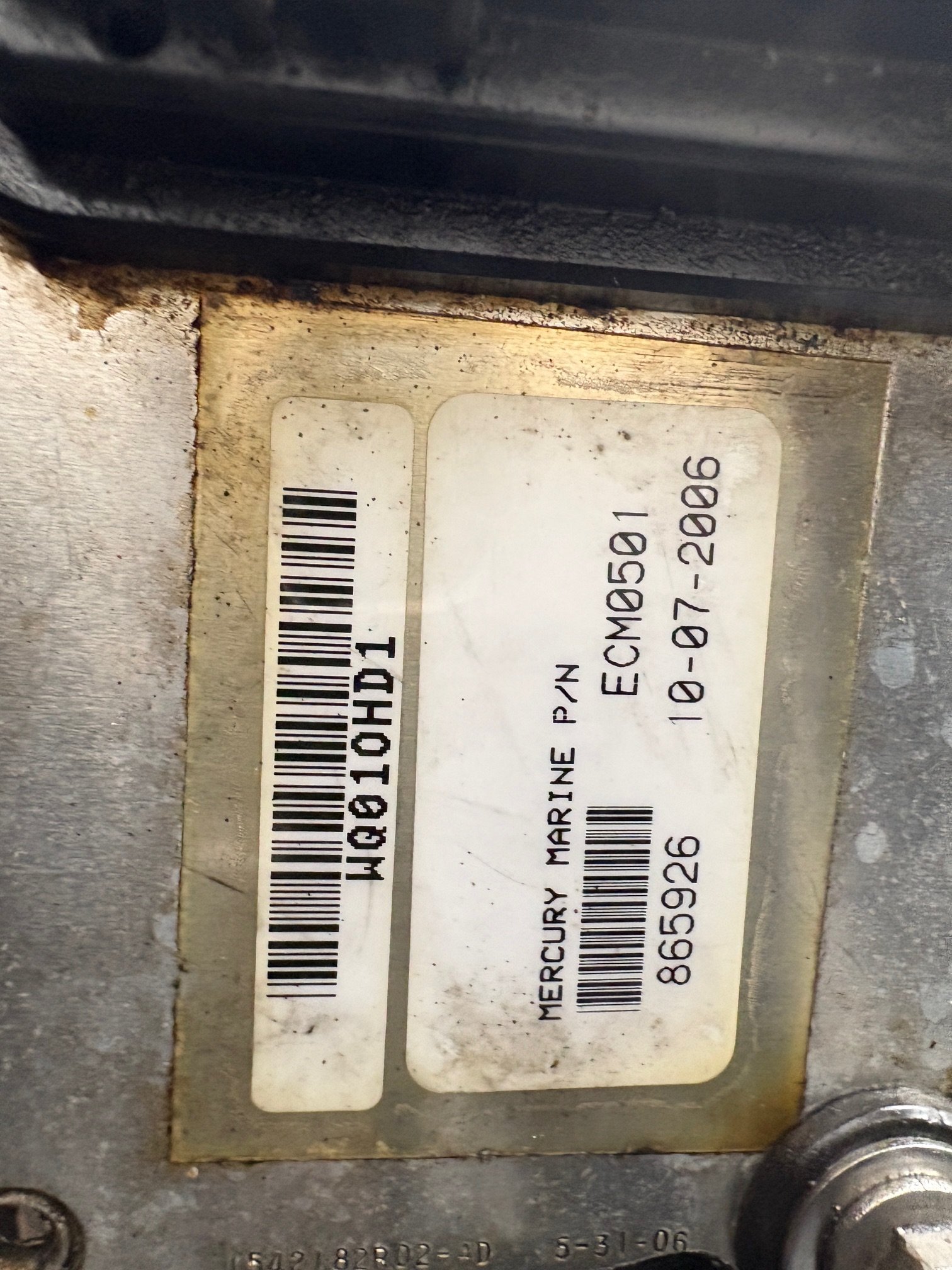

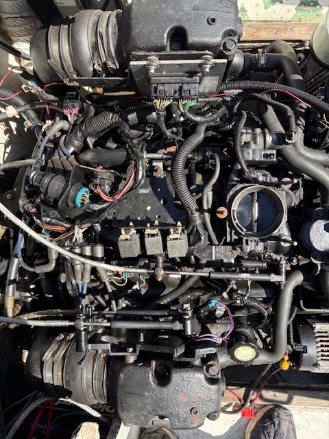

I took a picture of the ECM the other day I will post it. It does say ECM. I understood that the difference between a ECM and PCM is the PCM also monitors the transmission. My boat has a Bravo 1 stern drive. What is in there is an ECM. There are only 2 connectors that plug into it. This engine has been running for years before it just wouldn't start anymore.

Have you tried opening the throttle body while cranking the engine over to sometimes help get added air to the engine should the idle air control valve be faulty...
The plug sticking out of the distributor housing is of a CAM shaft sensor that if searched online could be tested... You also have a Crank shaft sensor that would be mounted down low in the front timing cover under/behind the engine water circulation pump that should all voltages be good and nothing else wrong, basically starts the signal to get the spark going.
Often the cap and rotor can go very bad on this design and creates a weak spark under the cap as they cross arc more so often between coil lead and cylinder 6.
Yes 40 psi should be okey to get the engine started but now you need to find a way to ensure the fuel is getting out (spraying) of the fuel injectors as there are some known blockages that have occurred in these systems. Make sure the battery cold cranking amps are high say close to the 800CCA range with 12.6ish voltages. All battery and wiring connections are clean and tight....pull spark plugs and have a look, make sure no water, damage, etc. is in there.

Is the only way to know if the ECM is working correctly is to try to interrogate it with a diagnostic computer. Can I pin it out to see if it's getting voltage and has a ground?
Yes, only way is with a scanner
You can do several checks to see if items are producing the correct voltage range to the ECM, but your unable to tell if the ECM is interpreting them correctly.
