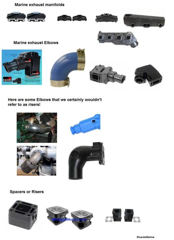

Just to clarify...... your exhaust system incorporates manifolds, spacers/risers and elbows...... correct?
Are the spacers/risers the issue.... or are the elbows the issue?
We will see many companies (in a misnomer fashion) calling an Elbow a Riser. I'm not sure exactly how that got started.
None-the-less, an elbow is an elbow...... and a riser is a spacer/riser.

Hi Ricardo
Sorry for the confusion. My setup goes manifolds straight into elbows. Its Crusader part R029016. The leak is in that elbow.
