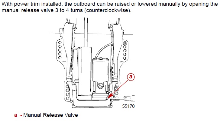

The last 2 trips out to the lake I have noticed the the RPM's are runiing about 5400 wide open. And when I would try to raise the trim of the motor it would slow the pontoon way down if the trim was to high it has never done this before is there anything That I can check on the trim to stop it from coming up so high. the boat was running about 6000 Rpm's last year. Where is the relief valve on the power trim? Sorry for so many Questions. Thanks Larry

Here's a diagram of the power trim release valve.
