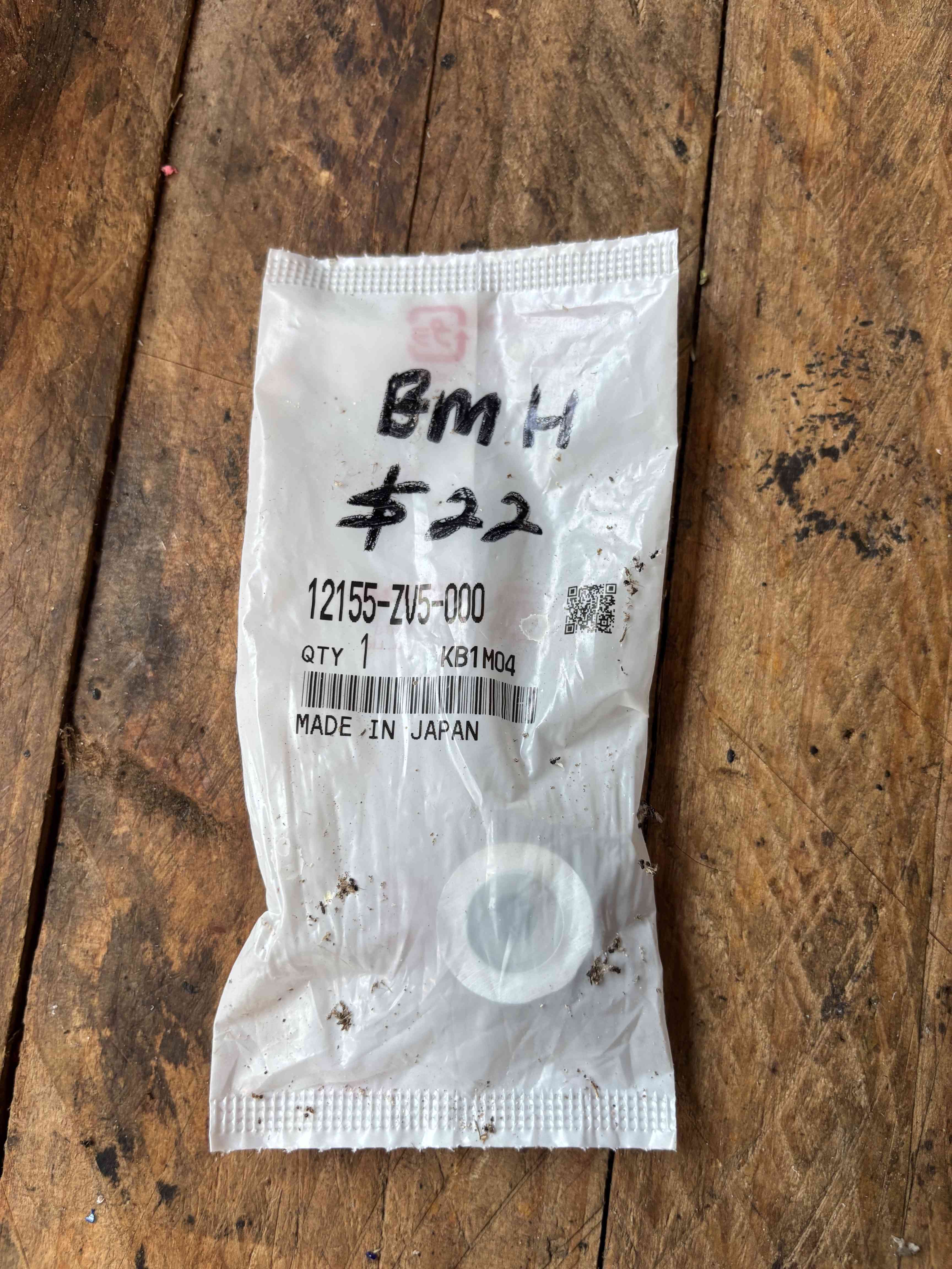

Hi there,
I was supplied all required anodes for my 2014 bf60 by my local Honda supplier
I cannot figure out where this one particular anode is located, I have replaced the internal anodes inside the water jacket and it does not belong in there. If someone could please point me in the right direction that would be great thank you,
Regards
See item 6 in link. I believe that it mounts behind the rectifier assembly...
...item 8 but I'm not 100% sure.
If it does and it's because the rectifier is water cooled then you may get lucky and find part or all of your cooling blockage in that jacket area when you open it up.
Good luck.
Thanks for that, it was spot on so very helpful.
There was build up behind the rectifier, that was cleaned up and new anode installed.
