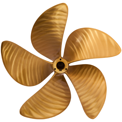

i found a 14.25 x 17.5 4 blade. 17 spline
does anyone know if those props have the the same spline as the vp 270?
its a long drive just to go look at it
close up of spline
VP props ( and most other sterndrive props) have a hub in them that is designed to break a way to prevent damage to the internals.
When and if this happens, the hub is replaceable by any competent prop repair shop.
i was kind of curious why they did that
i thought they were just copying the size of the gear case
the splines on the wakeboard prop dont carry all the way through the hub
Had a friend grab one for me but they're only 16 spline not 17 spline
i have a scrap volvo prop
it looks like the splines are held in to the outer shell with some kind of filler metal
going to take it to the shop and see if i can get it to melt away with propane or acetylene
ive 3d printed motor shaft couplings before using those rubex kits and machine out the shaft of the nibral prop
Yes, I cut one open with a zip blade, the rubbers glued to the outer shell and the internal insert is too large an od for what I wanted. I think there's enough material to broach a vp spline in the nibral but not worth it. Marine Engine has the 15x17-4blade for about $130 usd or about $250 cad after shipping
