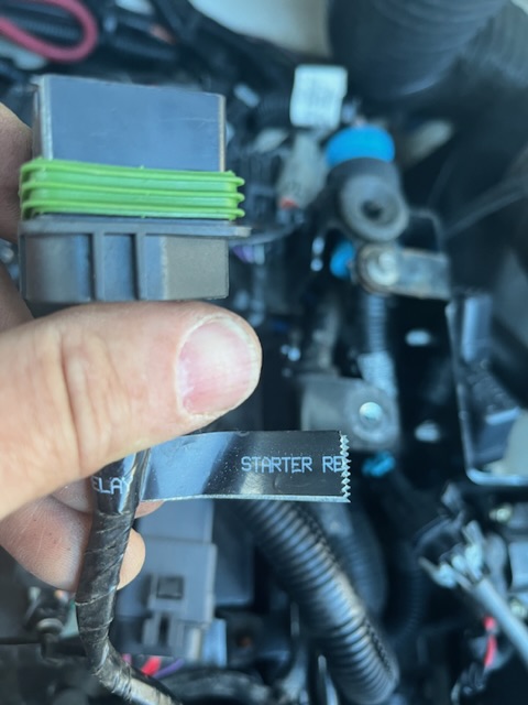

Here’s what I found. On my engine I don’t have a slave solenoid, but relays for the main power, fuel pump and starter.
The starter relay was clicking when I turned the key. I swapped it with both the fuel pump and main power relay and all three clicked. I plugged the main power in as well as the starter and it still didn’t crank.
I keep going back to the Fault Blocker System Voltage error being the issue. As in the post I noted the PCM has power but the MPR doesn’t have voltage.
Here are what the relays look like

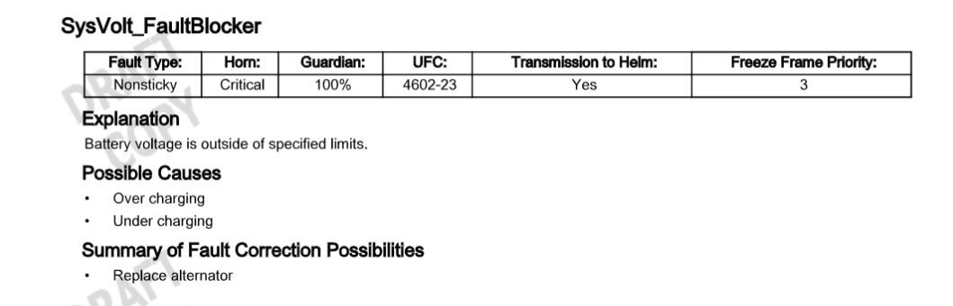

I am NO expert with EFI systems but this is what I found (see image).
It points to LOW Voltage. Could be weak connection at battery or ground.
I would Load test battery or if you have a spare, swap it out with a fully charged battery and retry.
