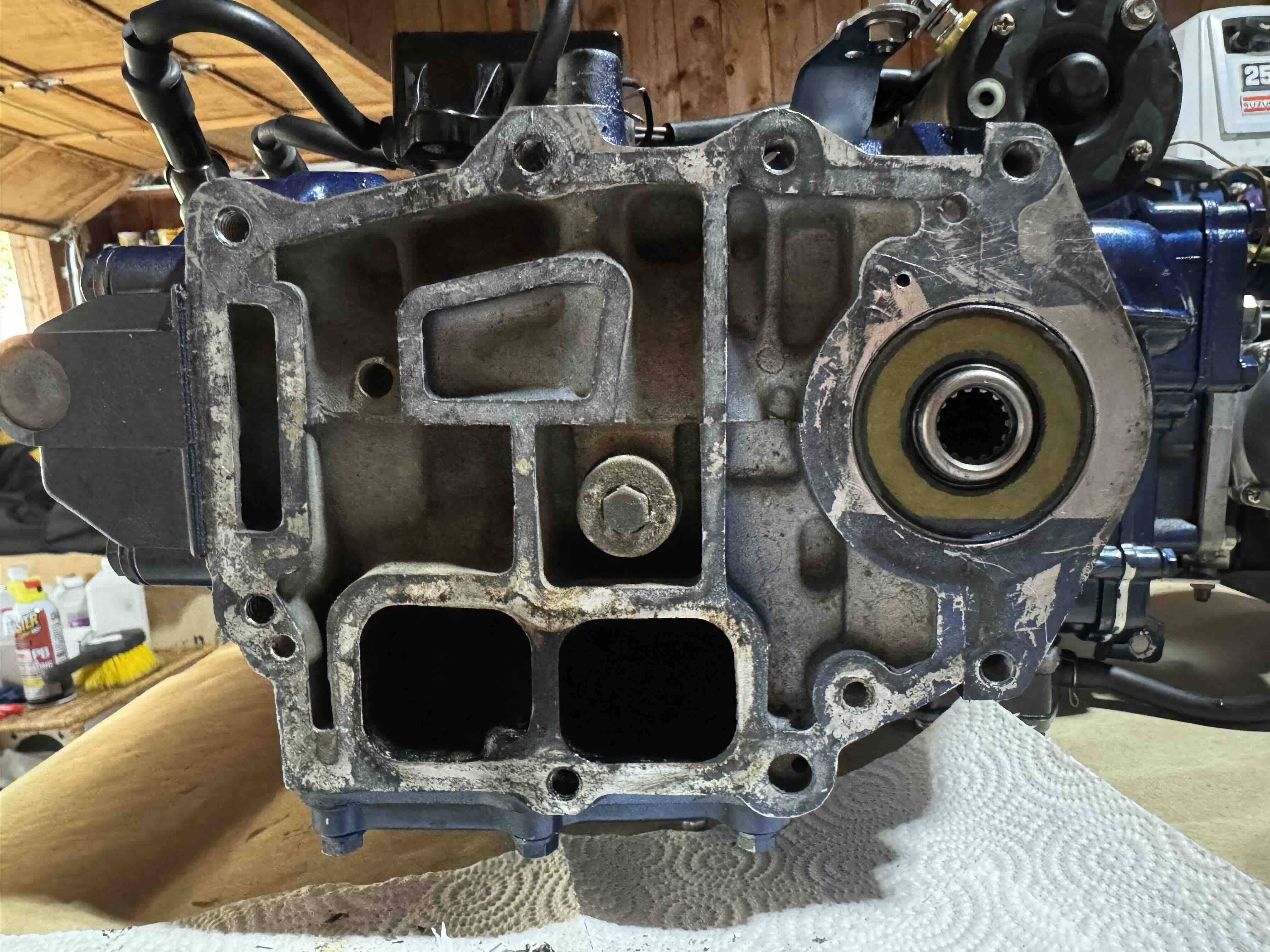

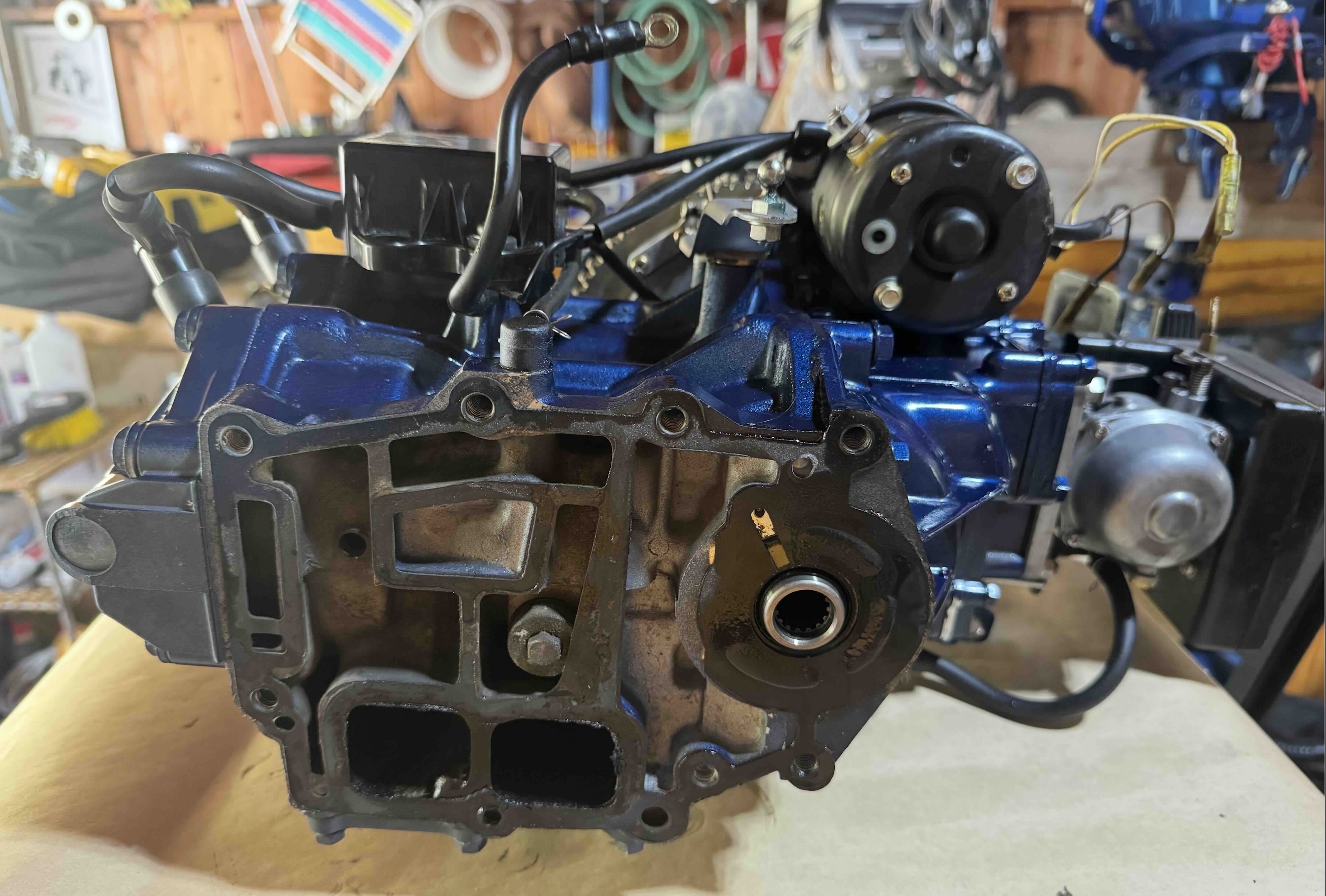

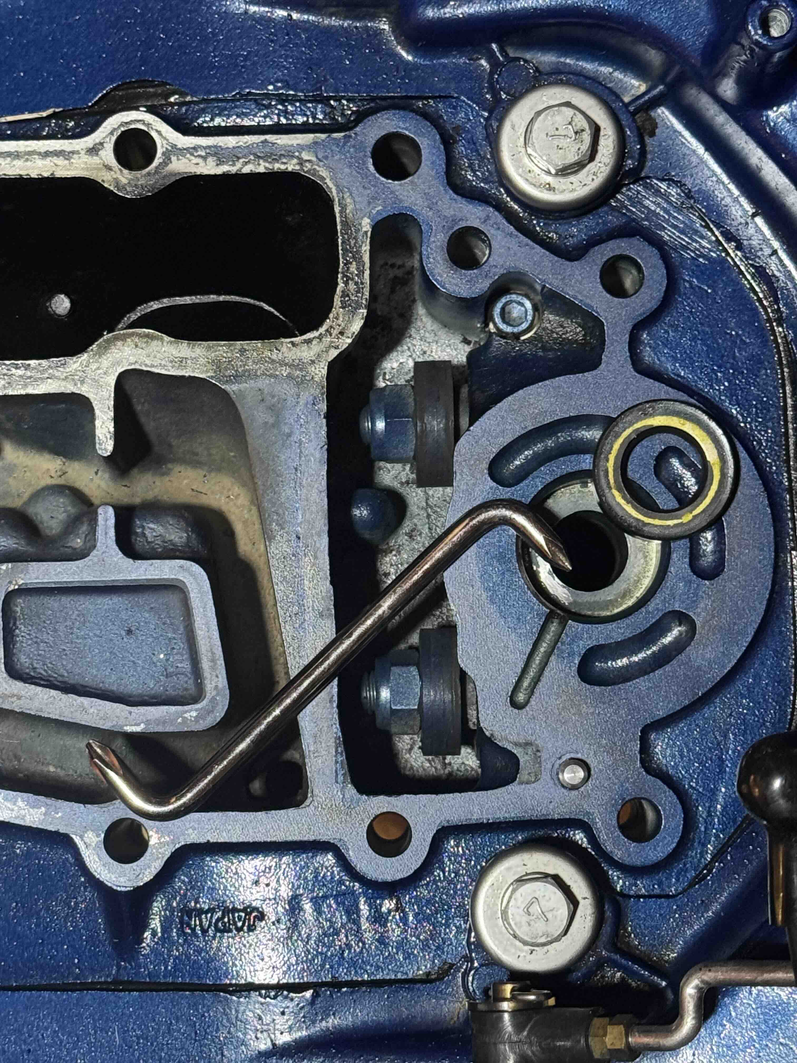

Having performance issues with my 40C. Idles fine but slow to accelerate and not reaching the rpms it should wide open. I've played with props and engine height, checked timing, cleaned carb and have gone through the fuel system. My boat is a light 16ft aluminum console. Got a tach installed. Should fly but only reaching about 4800rpm. Can hear a whistling sound when accelerating that seems to be coming from the motor. Noticed oily residue around engine base seal and gasket so pulled the head thinking a leak could be throwing off the mixture. How do you tell if the crank oil seals are bad? Would rather not replace them unless I know they're leaking. Hoping just a bad base gasket. Have not checked ignition system other than spark gap tester which seems to jump fine. Compression is strong and the same on both cylinders.
Cleaned up most of the oil before taking pictures.

Put some oil into the lower crankcase.----See if it pours out the bottom seal.-----Hard to tell but in picture #3 the seal looks iffy in the 6:30 / 7:00 o-clock area.
Parts came today so I went ahead and removed the two seals. Fortunately they came out very easily. The right angle screw driver worked like a charm to pry out the shaft seal and for the crank seal I drilled a couple small holes and carefully screwed in two fine thread metal screws. Did the drilling upside down to reduce risk of spreading any metal scraps. The metal on the seals is very easy to drill through. Then pried out with a lever and small chunk of wood. Will tap in new seals with plastic pipe or something like that. I'll report back after sea trial.
