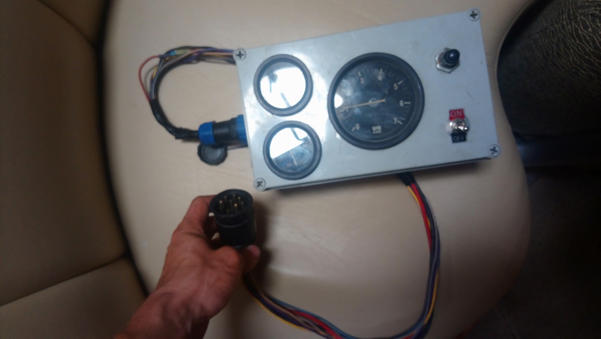

Can you ellaborate on "ran the engine from separate harness and key switch"???
did the "complete reman long block" ever run as expected after it was installed?
No, it never ran right. Previous engine also ran like this. I thought the issue was in the longblock so I got a new one.
Separate harness and key switch aka boat in a box, see picture
