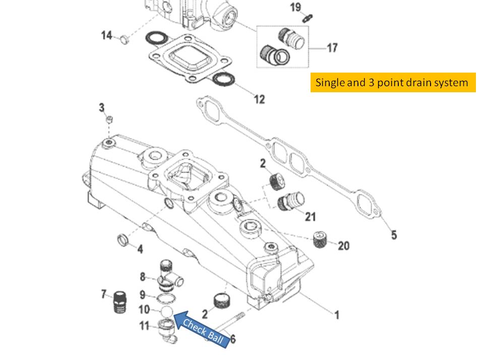

Fitted new manifold/risers and new t-drain manifolds. First trip out and the starboard bowl on the t-drain blew off and flooded the bilge. What could cause this? Faulty part? Popped it back on and made it to the mooring at slow speed. Is this part of the single drain system? Can it be easily deleted? Seems like a potential weak point just a plastic bowl press fit into a metal tee.

I think your talking about the check valve, and if so look for the ball in your bilge
It can be removed but you need to remove all of the single point system and convert to 5 to 7 point system
Would need your serial number to determine what would be needed

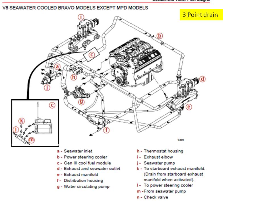

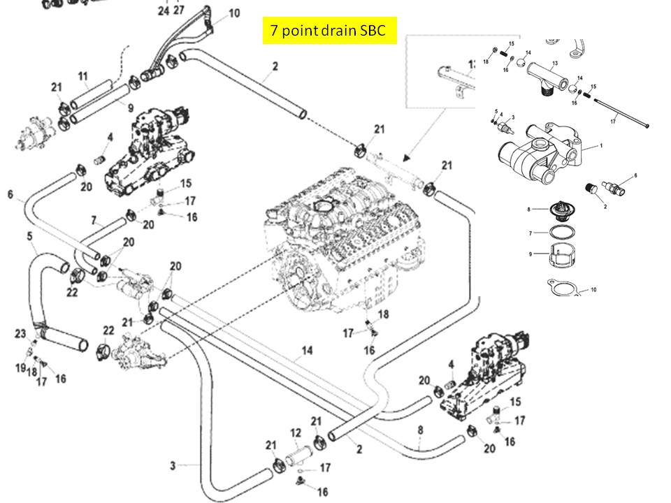

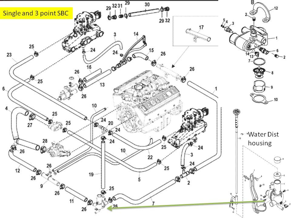

Maybe, I'm not seeing how your system was done, there are a few different ones

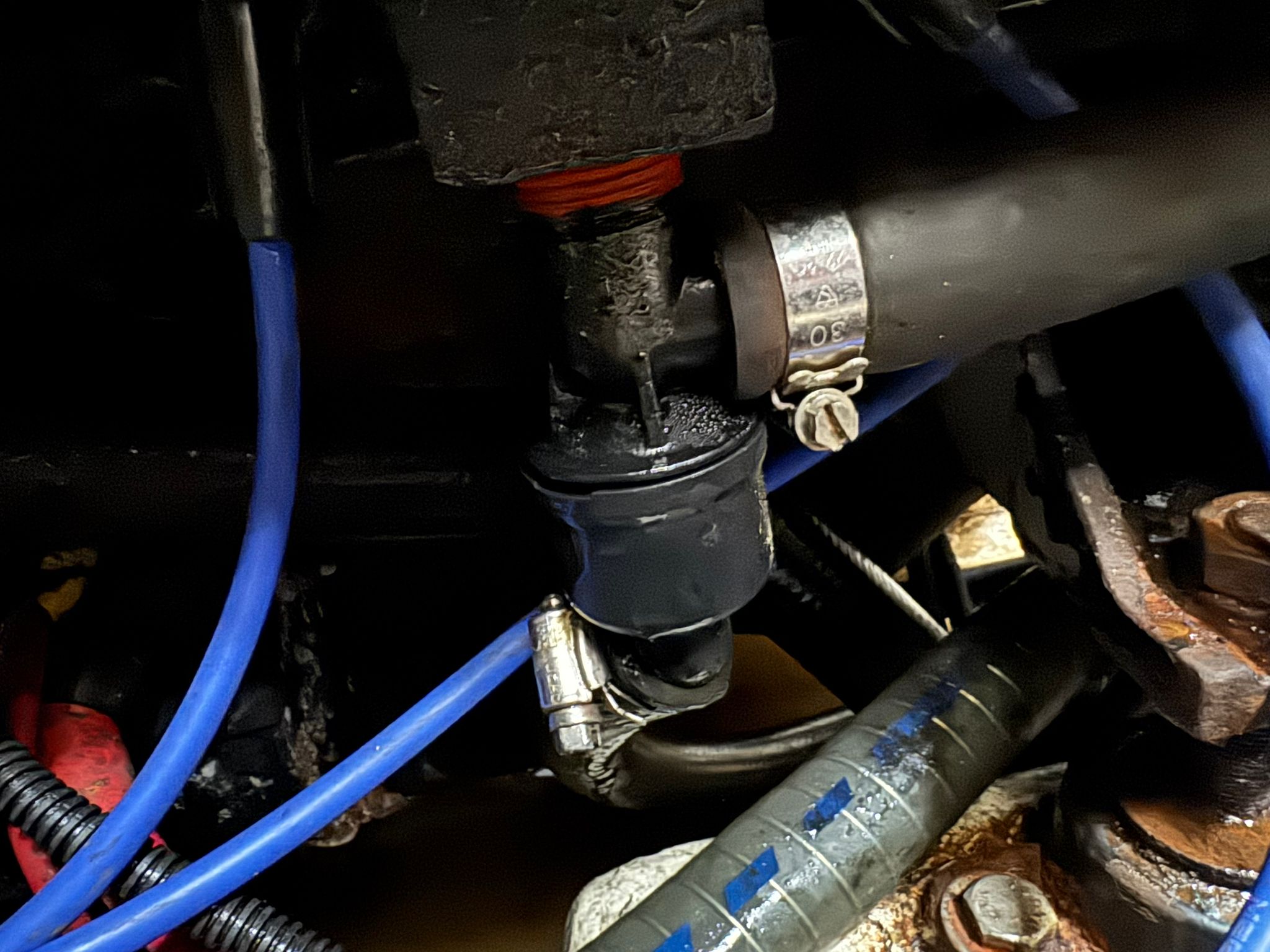

This is the offending part that disassembled itself. I grabbed the old ones out of the bin and they seem like OEM parts and much better. I'll probably put them back. The bowl just clipped back on. The original 2 on the bench are much more solidly built.

I'm hoping the issue was actually just a faulty new part. The build quality difference from the original OEM ones I took off to the new clone ones I put on was shocking. Didn't really pay much attention when changing them but side by side after the failure the old ones were nice tight fit bowls but the new ones popped off as easy as tops on an aerosol can.
