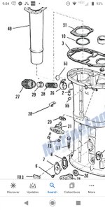

Hello all, I have been able to run my 1965 Evinrude 40hp in barrel. I noticed the 2 pee holes have water residue around them but I didn’t see what peeing from them. Is it supposed to be a stream? I am worried I ran motor and didn’t get proper cooling.
What should I do? Pull lower unit and inspect impeller, I planned to do this anyway. I noticed some smoke from exhaust is that normal?
Any tips recommended what is needed to replace? Impeller any gaskets or orings?
Part 27 will spew water/exhaust....no pee hole on this old girl. Won't know till you get into it....be cautious. Might be that aforementioned part is broken off.
