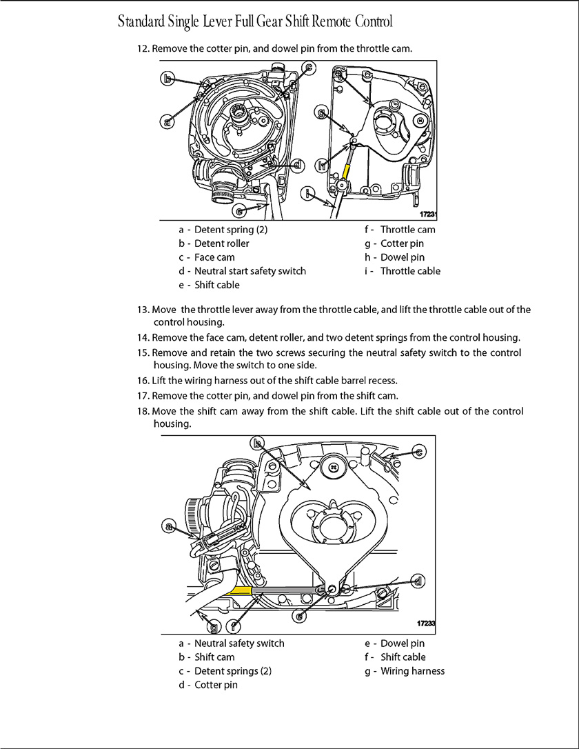

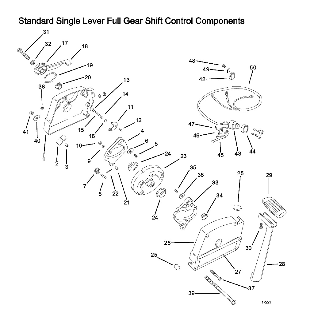

Here's an exploded view of the box put some Merc 2-4-C with Teflon on the moving parts

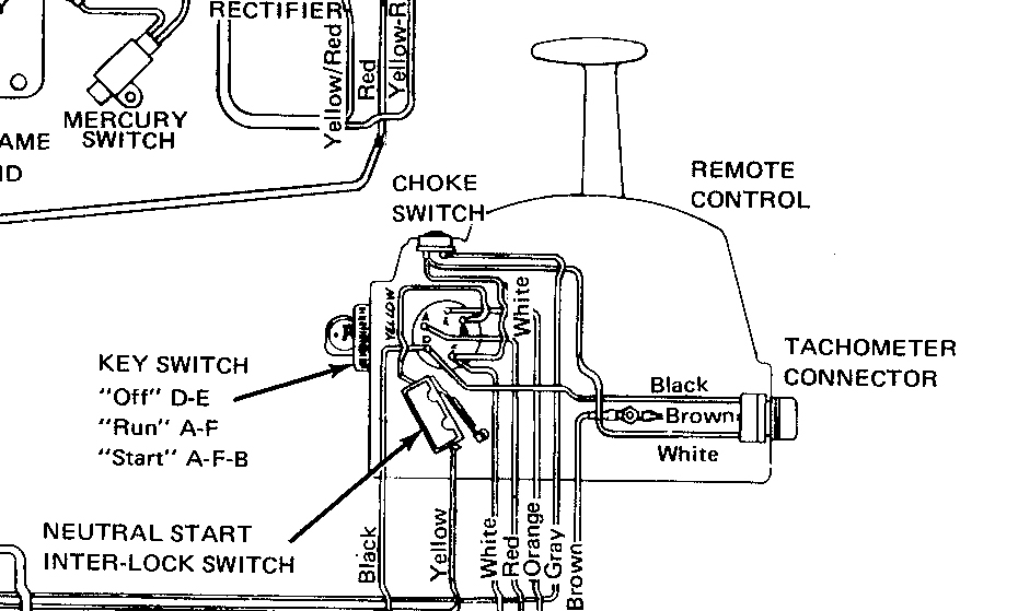

I'm not sure what all fell out of mine when I took it apart. I know there's some springs that came out and I need a new harness. Wire insulation is mostly gone and wires corroded. Found that from CDI.
Figured might be cheaper to get something new that came with the harness rather than fixing the one I have, if someone made one.
I'll use this diagram to see what fell out of mine. Do you have a link or where I can find the parts at?

How much slack do you have in the wiring? If you have a foot or more of good cable just solder the new wire on to the switch, choke and neutral safety switch.

Insulation is mostly gone. It was all wrapped in electrical tape. I connected a new battery, which promptly melted down from the power and ground that were shorted together under the electrical tape.
The engine harness side was the same. I made a new harness for that. Suppose I could do the same on the boat side.
I'll see if I can get the parts for the control box and put that back together. Needs a key switch as well, full of corrosion.

I attached a picture of my controls. Only springs I see are the detent spring. I did find 1 of the springs.

Looks like it's for the warm up lever. Should I even worry about that?
Also missing the detent roller spring for the main control. I'll get a new one of those.
Nevermind. Not sure how the detent springs for the warm up would come out. The plate is still being the lever.
I have no idea where those springs are from.
