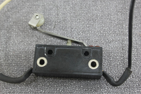

Shift interrupter switch not engaging...
Boat ran just fine first outing, shifted like butter all day.
Second time out shifting issues. Drive will go into gear but won't come out with engine load on it. Shut the engine off, back into neutral, restart, select gear, drops in fine but won't come out. On the trailer I noticed the notch that actuates the arm on the interupter switch barely moves when shifting. The plate with the notch moves freely by hand but barley moves when moving the shifter at the helm.
I adjusted the brass barrel out of curiosity, 10 turns out got the notched plate to move enough to engage the switch but it stayed engaged and only for reverse which I know isn't right. Its just interesting because the boat was shifting fine a week ago and Ive done nothing to it since!
The shifter isn't soft or spongy.
Shift cable is dead on at 5 7/8'' barrel to stud.
Idle set around 600rpm.
Any ideas?

1. On a trailer the interupter may not engage as there is no load on the prop and prop shaft. it has to be confirmed in the water under load
2. if you activate the switch only ( anytime on or off trailer) does the engine stall?
