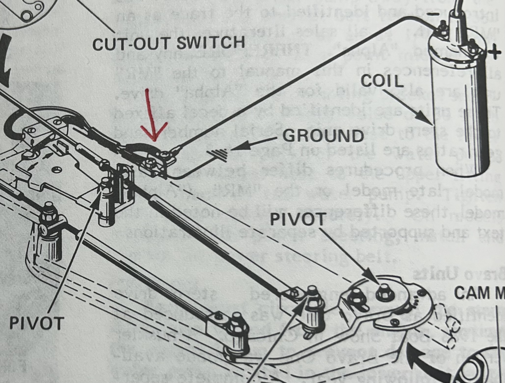

Wire to Coil - is not ground.
The wire from interupter switch that goes to the coil gets shorted to ground when switch closes.
So if you suspect the wire from switch to coil all you need to do is, while running engine in water or on trailer is depress switch and if engine dies, wire would be good in my opinion.

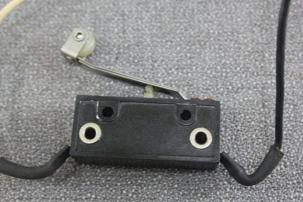

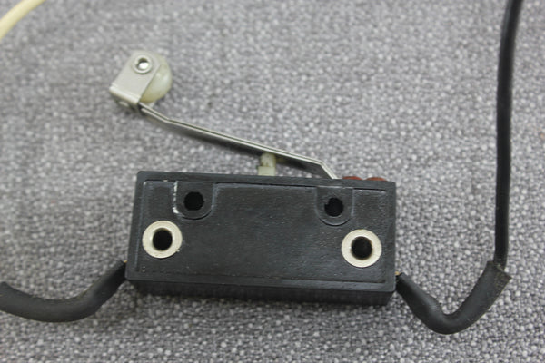

A picture would help.
Also those switches are very hard to come by and if found sell for far more that the switch itself is worth. Its worth is only with Mercruiser shift brackets.
Part Number is, and all years that used this type of switch the part number is the same.
39670A28 - Switch Some prices are anywhere from $50 -$100+​

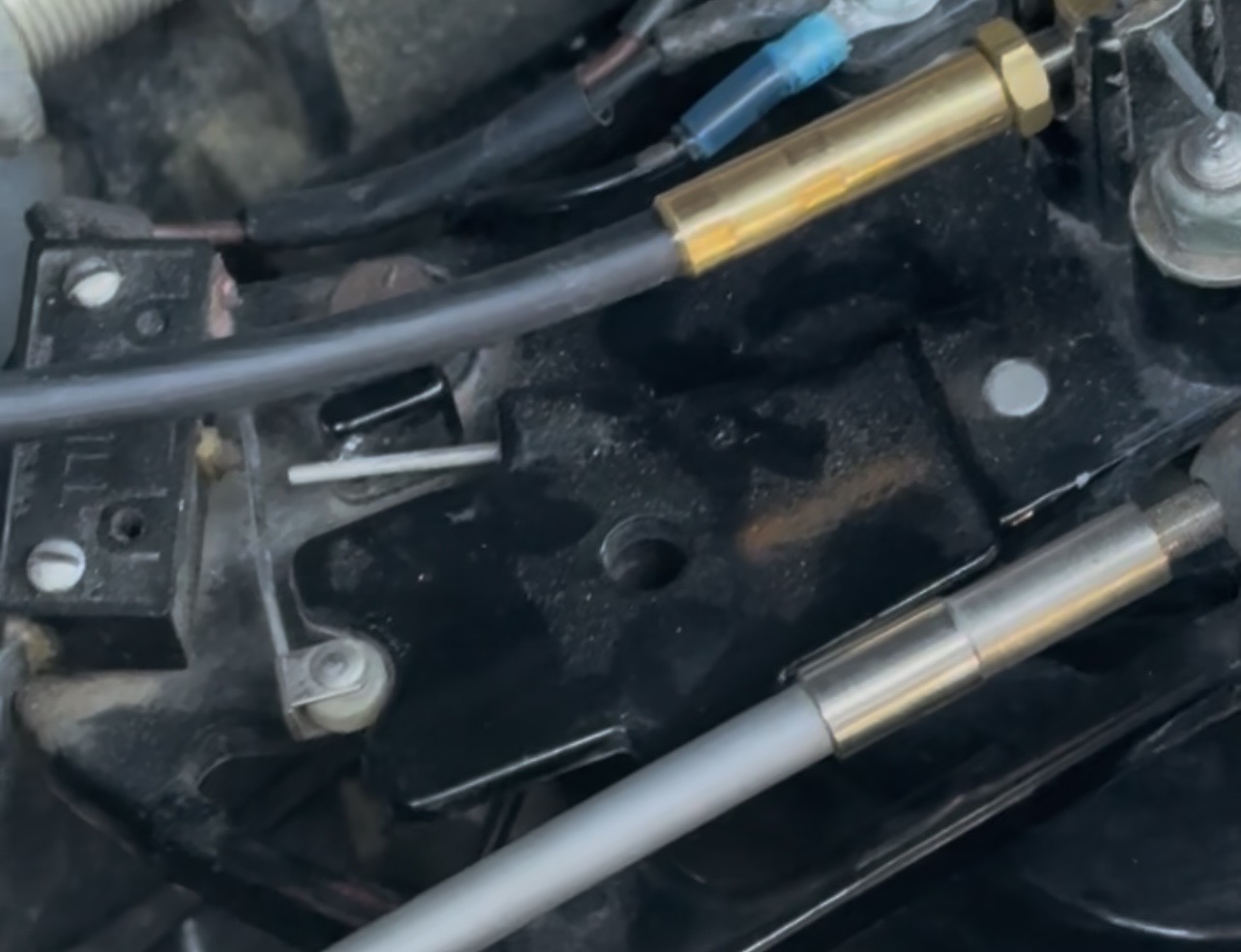

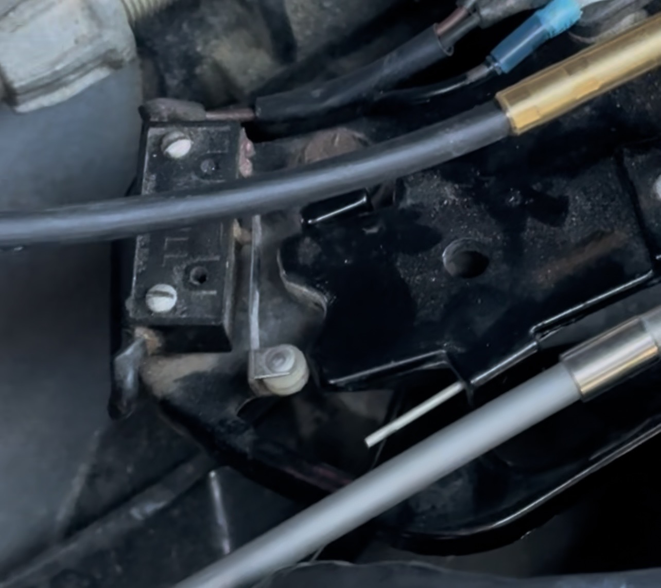

Heres a before and during shift screen shot from a video I took during a forward shift. I ordered a “new switch” and am going to verify wiring as soon as the boats back at the house where I can look into it.
Again, the boat shifts fine. It’s coming out of gear that’s the problem so everything is pointing to the interrupter switch and or it’s wiring.
