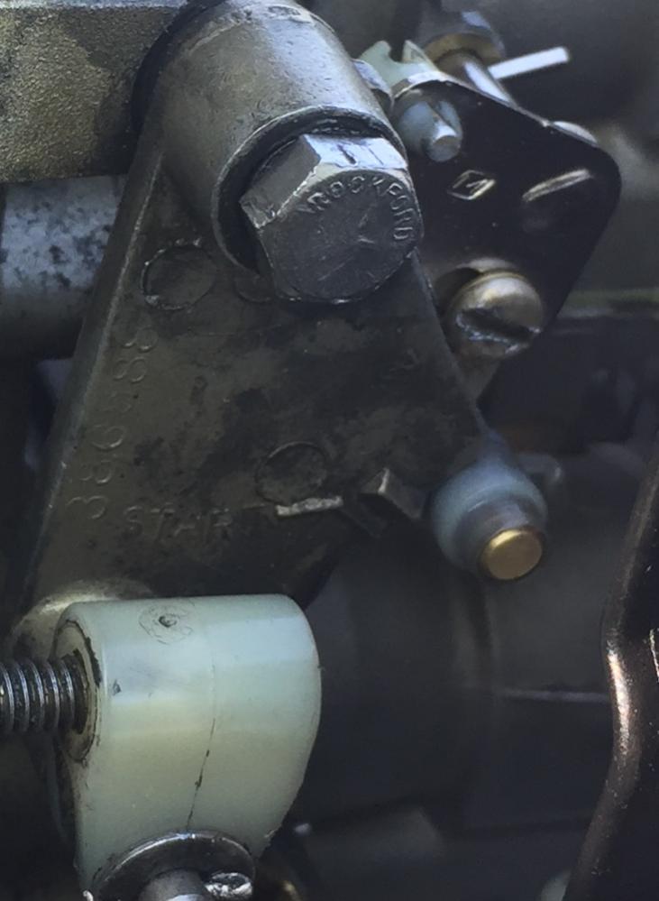

CEC9D60D-E1D0-4D24-AF98-917ADA85A926.jpgHere’s what the setting is for the throttle... can’t go lower as it will stall the engine but the motor goes into gear... kinda high rpm to do it but it goes (just)
My 2c is that that motor is not running on all cylinders and the popping etc indicates that you may also have electrical issues on top of carb issues. I have had bad power packs cause similar things.
Have you checked electrical system with a spark jump test? Can you wire a timing light to check for spark when it does that pop and chug?
You should also check all connections, coils and the power packs. A bad diode can cause an idle like that as it causes erratic and intermittent firing
‘the CDi site has a real good trouble shooting guide.
you have quite a few posts so I hope I haven’t missed where you might have done this stuff already.
my final 1c, is that the Lync and sync needs to be precise, these motors will bog every time on the water if it’s not perfect. As an example if throttle advances too early vs the spark advance it will die.
