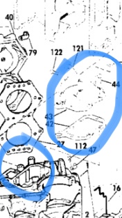

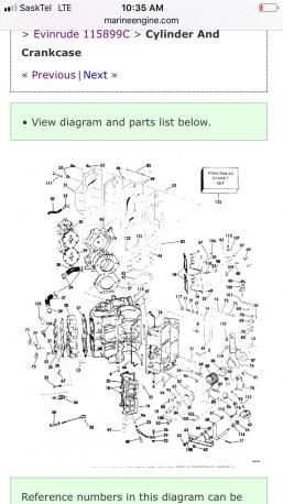

Thank you. Found it. It’s right where YouTube said it would be. Blah. How do you recommend me takin it out? I’ve seen YouTube comments saying you don’t need to cut the cowling. Just take out the top 2 bolts and then bring out the bottom two until you can’t anymore then just move the housing down the screws that are still in there homes. Is there going to be enough room to remove the thermostat? Do I need to replace any gaskets when I do this? Will those gaskets be a pain if I do end up needing to replace them? Should I bring the dremole just in case? Hahahaha.
Also. The reason I though the thermostat was on top was becuase there is a bolt called the thermostat housing bolt and it is number 43 on that parts list. But yes, I’ve found the actual.
Hahahaha-----Just another example of mistakes found on parts listings.-----And if you do not know that it is a mistake then----I consider changing out those thermostats to be a simple job !!!

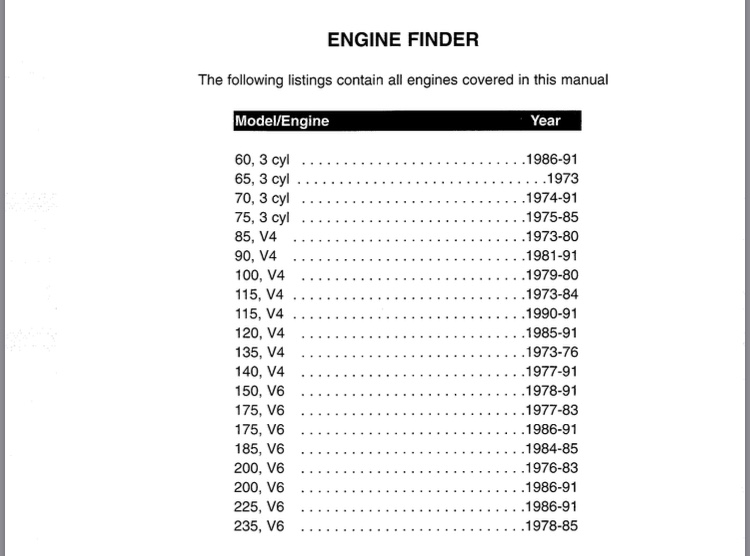

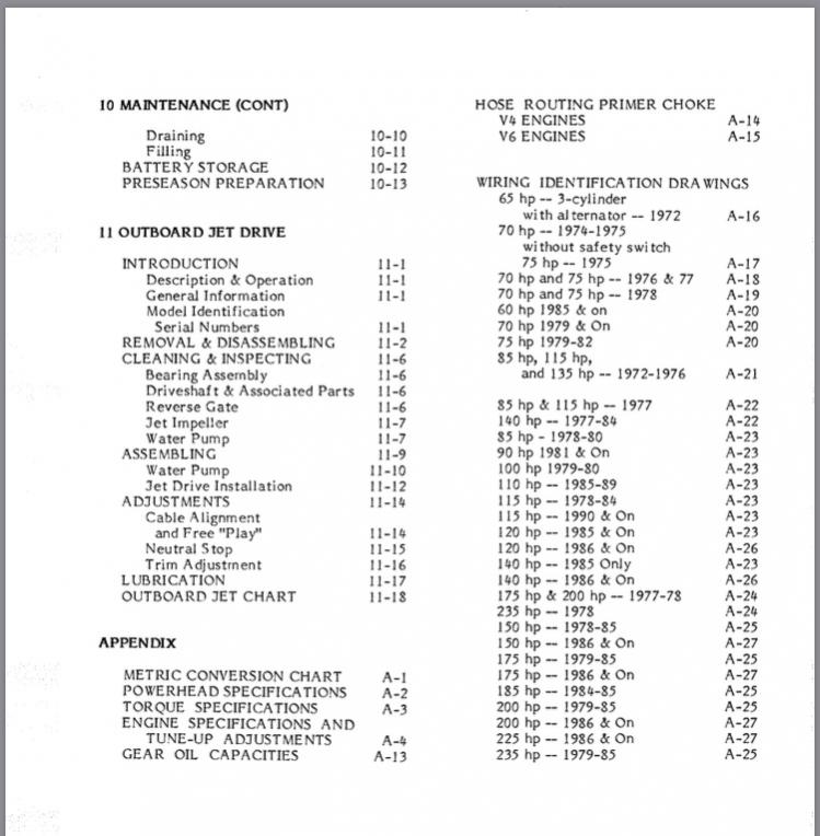

This is a Johnson/Evinrude service manual
What’s a PITA? And what’s (bubbleback guys) mean?
OK I tried.
Seriously?? You tried? None of what you wrote makes sense too me. Making me feel stupid is ignorant. Did I join the wrong forum? Is it too much or not worth your time to explain in simple terms? It’s like going to a doctors office and they start rambling off technical terms and expect you to understand. How does that make you feel when they do that? Thanks.
If your motor has a bubble back exhaust its hard to access the t-stat housing bolts (PITA=pain in the arse) The Seloc manuals makes a OK substitute for toilet paper when needed....and that NOT a OEM manual, its a Seloc.
tha k you for explaining. How do I know if it’s seloc or OEM? I’m assuming seloc and oem are publishers?
Seloc and Clymer are aftermarket manuals covering various years and all HP's. A OEM (original equipment manufacturer) will only cover that year and HP's. ......and it don't offer "good words" in it explanations. You need a paper manual(link below) as a OEM is not offered in electronic form to my knowledge...
