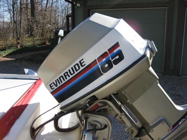

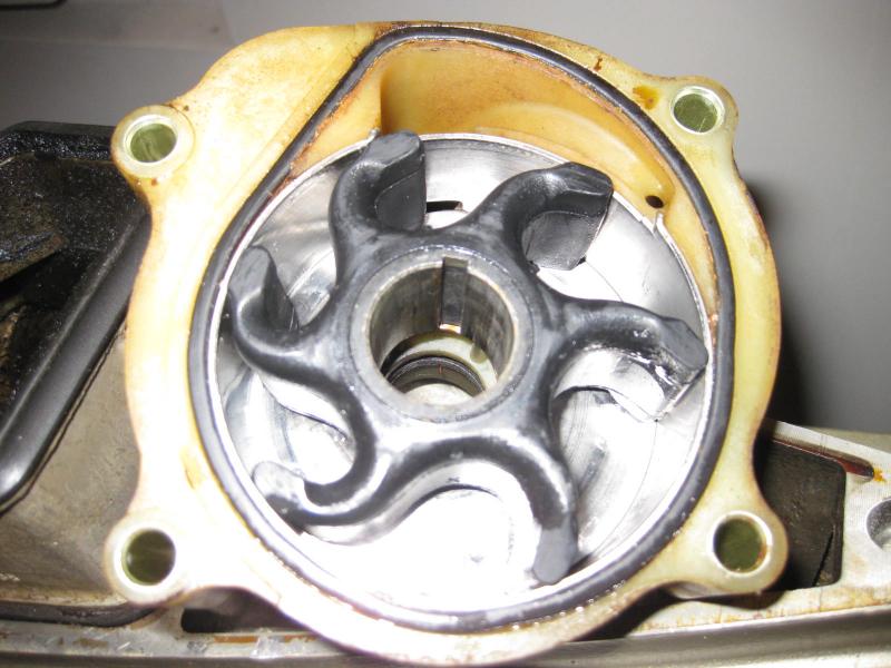

First, I bought this engine new in 1978 and it only has maybe 75-100 total hours, if that, on this engine. Actually it still looks almost new. While it has set for most of its life I have occasionally operated it on my bassboat and have always maintained, serviced, and winterized. About three years ago I replaced the impeller and operated the boat a few times over the season and it runs like a charm. It sat idle since other than running it with muffs a time or two to clear out the carbs. Now I've decided to sell the boat and upon starting the overheat alarm buzzer went off. The sight stream was running strong but I thought I'd just replace the impeller again since I did it successfully once. Nada.....alarm buzzer still goes off. So I thought the next logical step was the crossover thermostat kit. The original 1978 thermostats actually appeared ok although there was some corrosion on one of them. Short story....after thoroughly cleaning and blowing out visible corrosion and replacing the thermostats the alarm buzzer is still going off. I've blown compressed air through the engine block and can feel it coming out the other side, no corrosion or blockage.....the sight stream is strong however it will be cold one second and very hot the next. The one thing I seem to remember that is different now is it seems I recalled seeing water coming out of the exhaust ports before......now there is nothing but exhaust. My question.....what other reason(s) other than the impeller and thermostats could cause overheating? Blockage?....such as not enough water in the pickup tube? It has never overheated before while using muffs. Any advice is very much appreciated.

Next thing. the water coming out of the ports in the back. I've seen this a couple times. Especially after someone puts muffs on and turns the water on too hard. In the top of the water pump there is a seal to the cooling tube. The pump has about a 3/4 in output and the cooling tube to the motor is about 1/2 in. The seal is in that hole in the top of the water pump. If you replaced the impeller you know what I'm talking about. If you pump water in with muffs too hard, it can push that seal up the cooling tube and basically you loose the seal on the pump to the motor. The water pump is pumping water in the cavity along the exhaust tube until it fills up the center section. This can make the motor hot too since it isn't getting enough coolant. You might get enough water to pass the pee test but not enough to cool the motor. Just a couple thoughts. Good luck with that shift linkage bolt...
