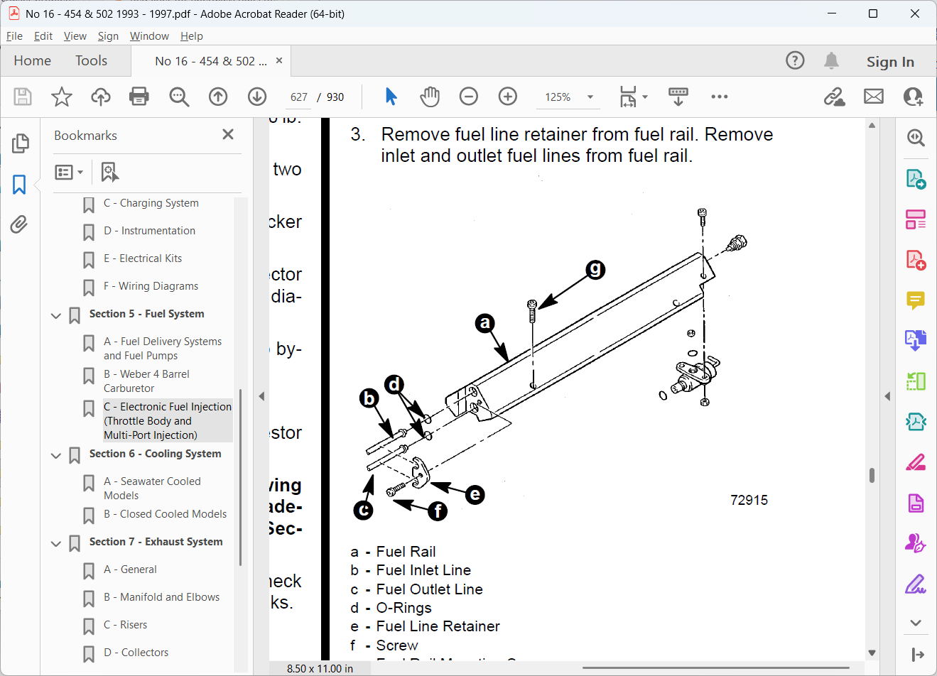

36 +/- 2 PSI is what Manual 16 calls for with the MPIs...TBIs call for 30 +/- 2 PSI...
THE MPIs went up to 43 PSI in 98...I think they changed the flavor of the MEFI unotd at the time, too.
