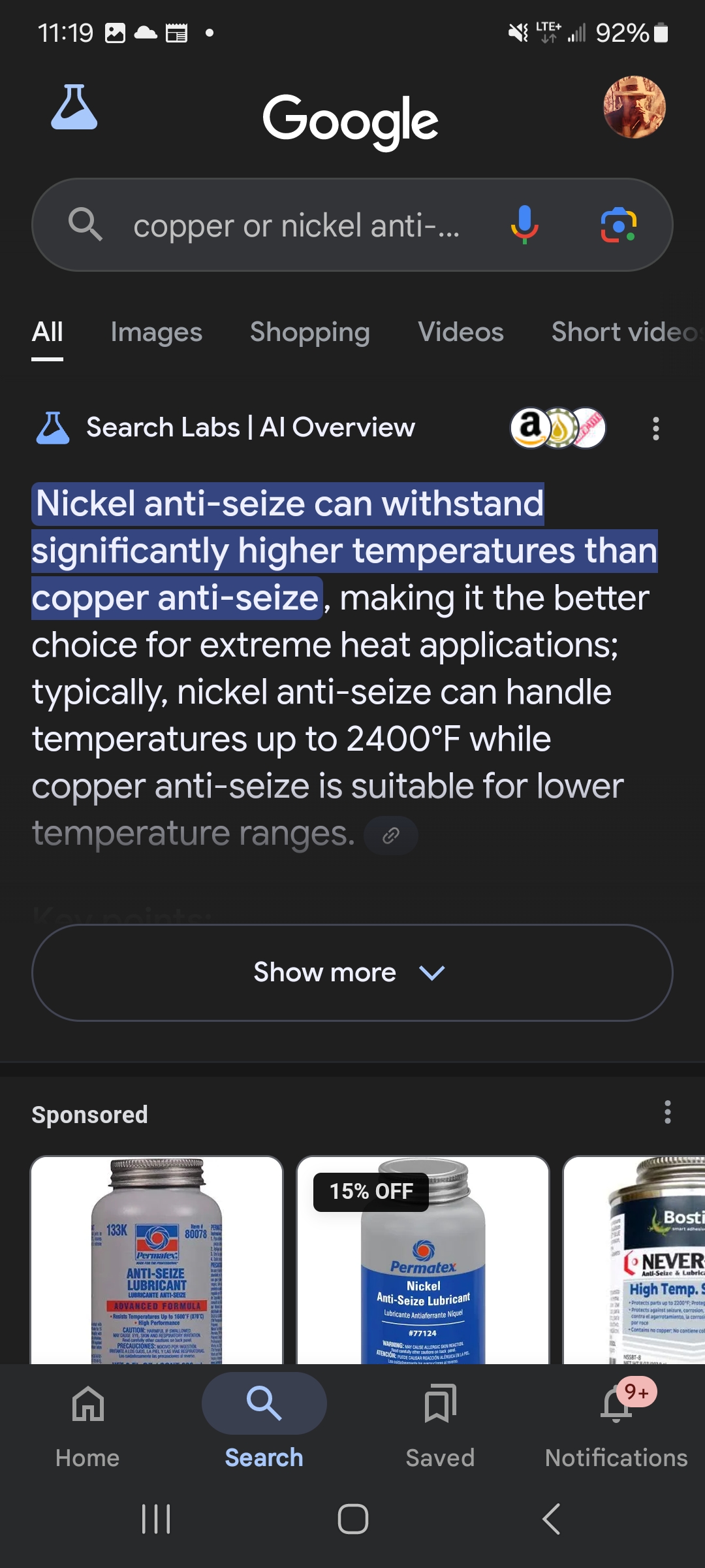

I always use nickel....some will argue....but why argue with success?

Copper is fine, it has been used for decades on automotive exhausts, which run far hotter than these little outboards.
It’s rated to 1800F. Your outboard exhaust will never get near that hot. Aluminum melts around 1200F, if your exhaust got anywhere near those temps, undoing the exhaust screws will be the least of your problems.
Incidentally, the service manual states, “Apply OMC Gasket Sealing Compound to threads of retaining screws. “
This is to keep water out of the threads, controlling corrosion. Antiseize, (copper or Al), also pretty good.

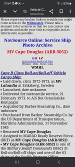

Price is pretty much the same. In major overhauls heavy diesel marine, we keep both on hand. Use a lot of it. 4 years later, on next overhaul, things come apart without problems. Food for thought....a "refresh overhaul" on an 8000 HP Peilstik engine, the boss gets 2 million. Usually start with 7 or 8 guys, then 3 or 4 of us finish up and test run. The engines were designed to run 20 maybe 30 years but many of the ore carriers on lake Superior now are 50 years plus with the Pielstik. Navy has some still running well too. 6 ships are in Charleston Cooper River. Each has 3 main engines, all Pielstik. The Cape Douglas for example was laid down in 1972 out of Sweden....ha! Boss is Swede.
