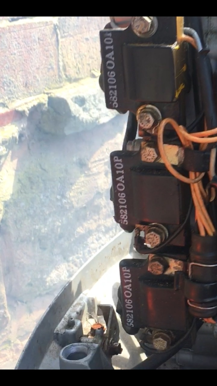

I’m not sure if I’m starting to look for issues but it’s bugging me that at idle cylinder one when performing drop test is not as noticeable and other two.
Compression
127 -1
130 -2
130- 3
New fuel filter

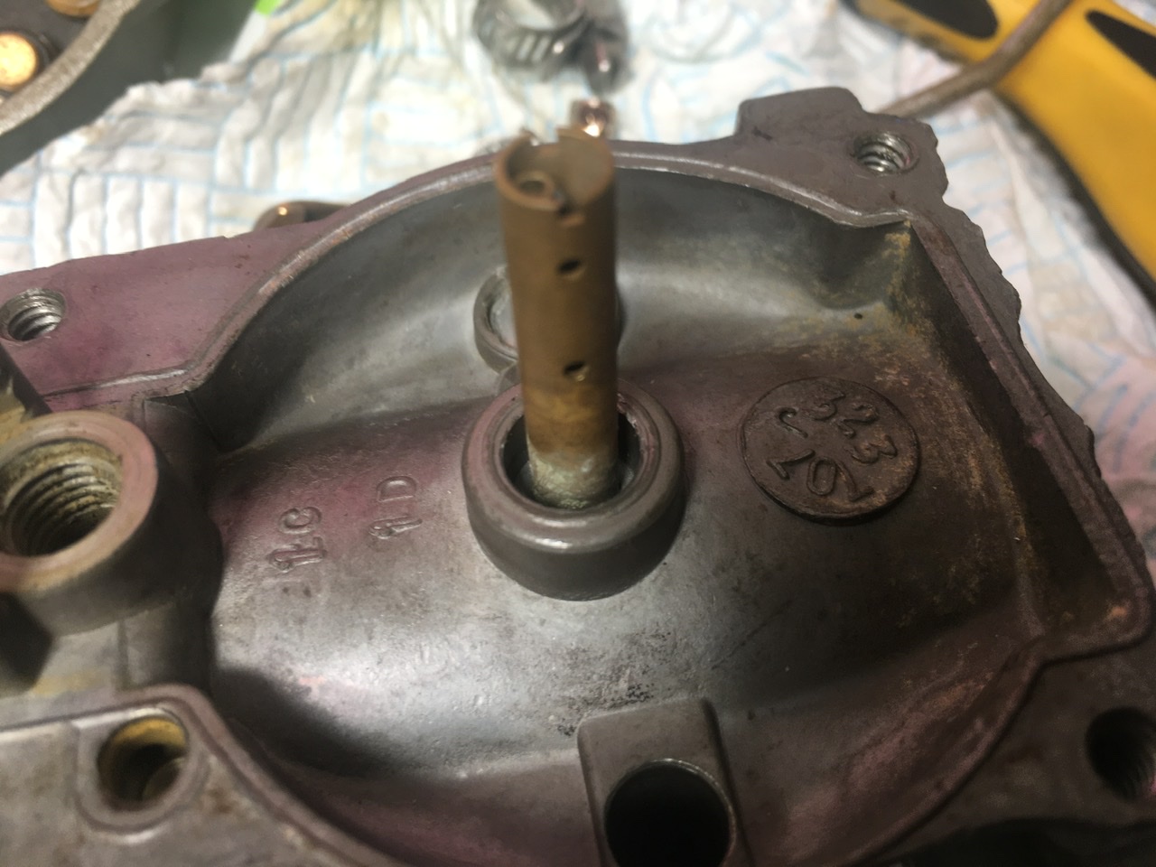

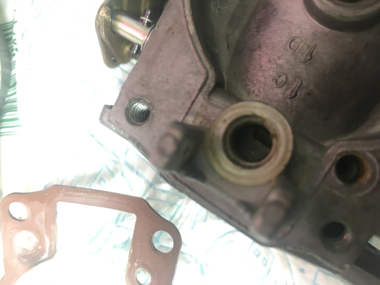

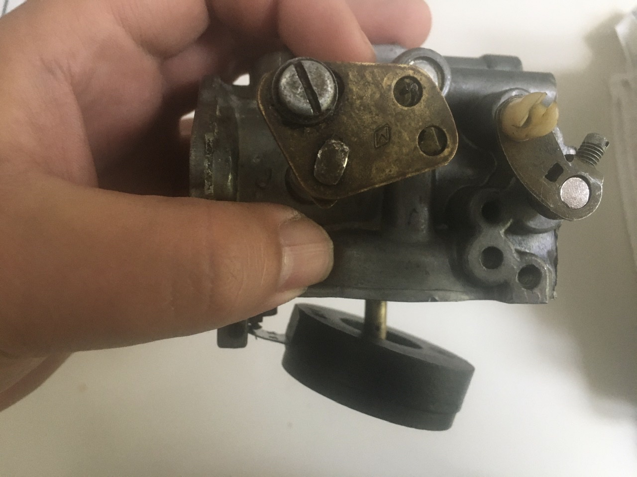

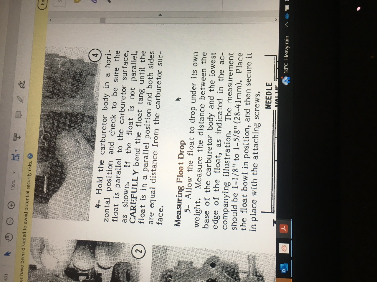

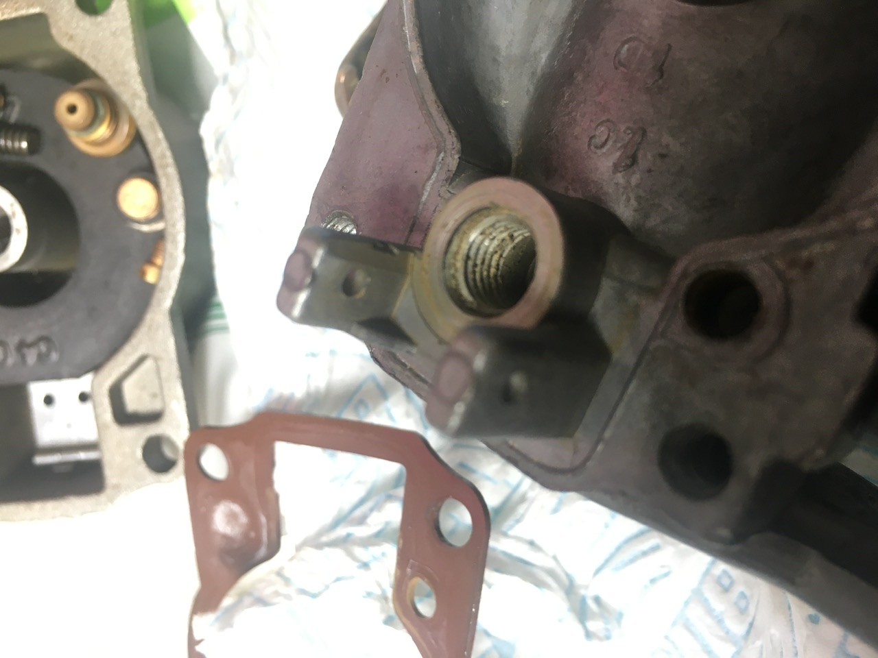

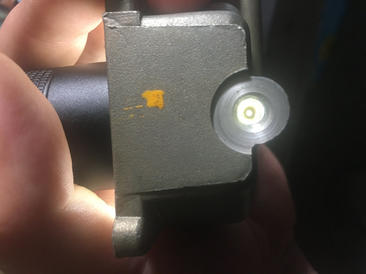

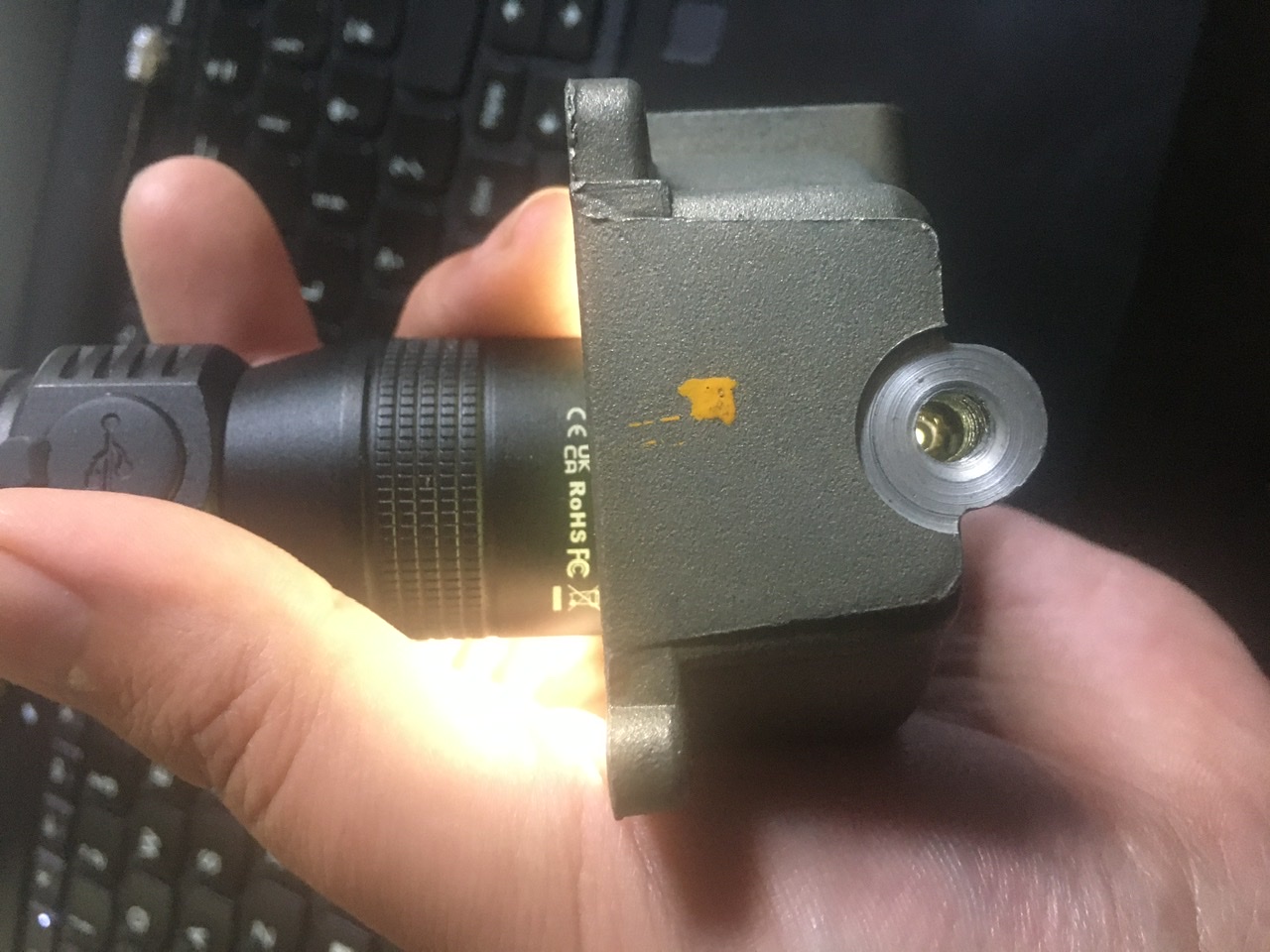

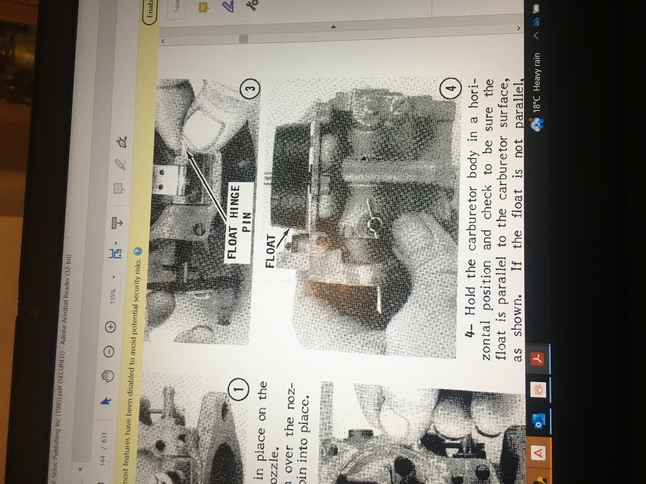

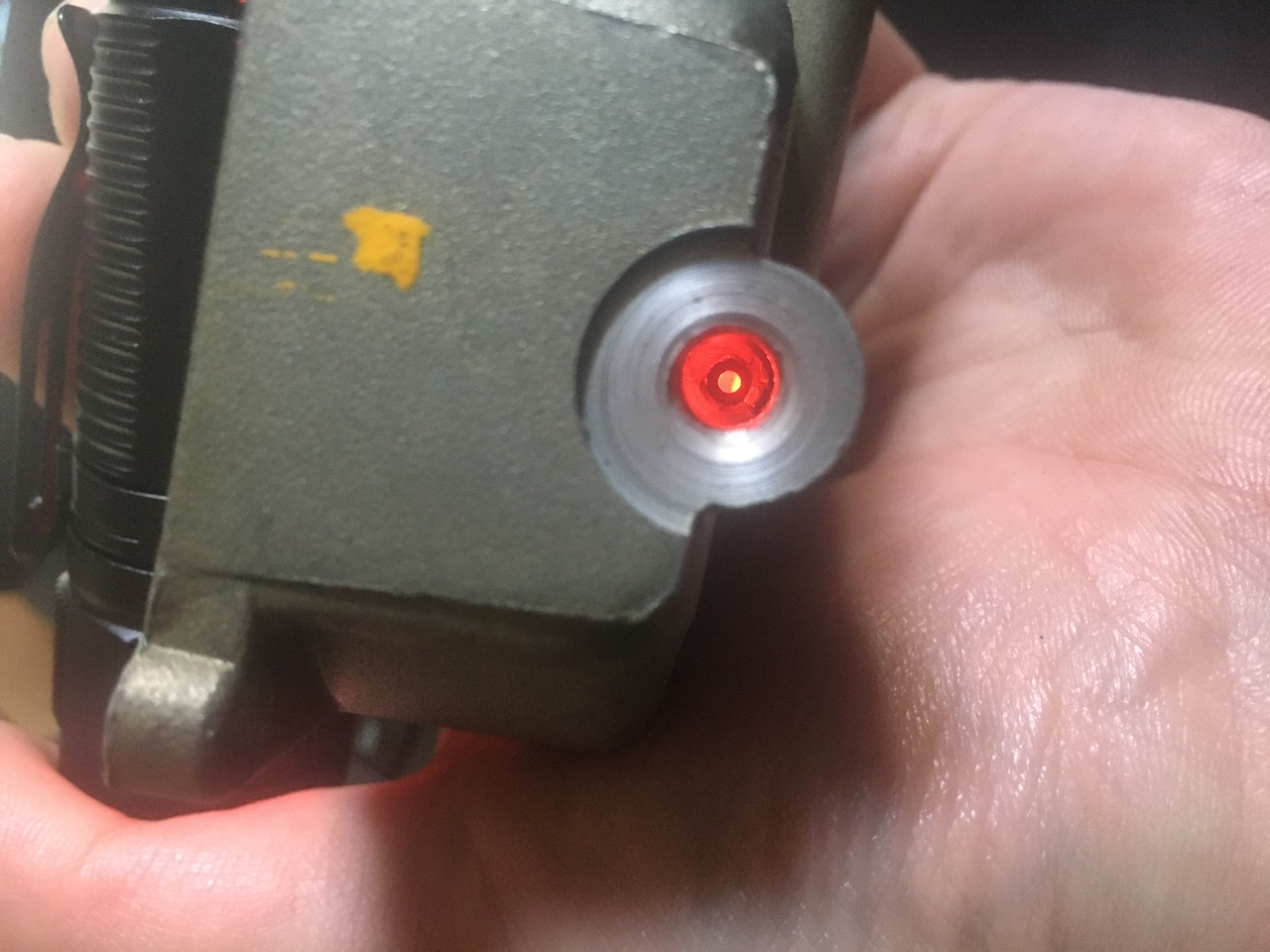

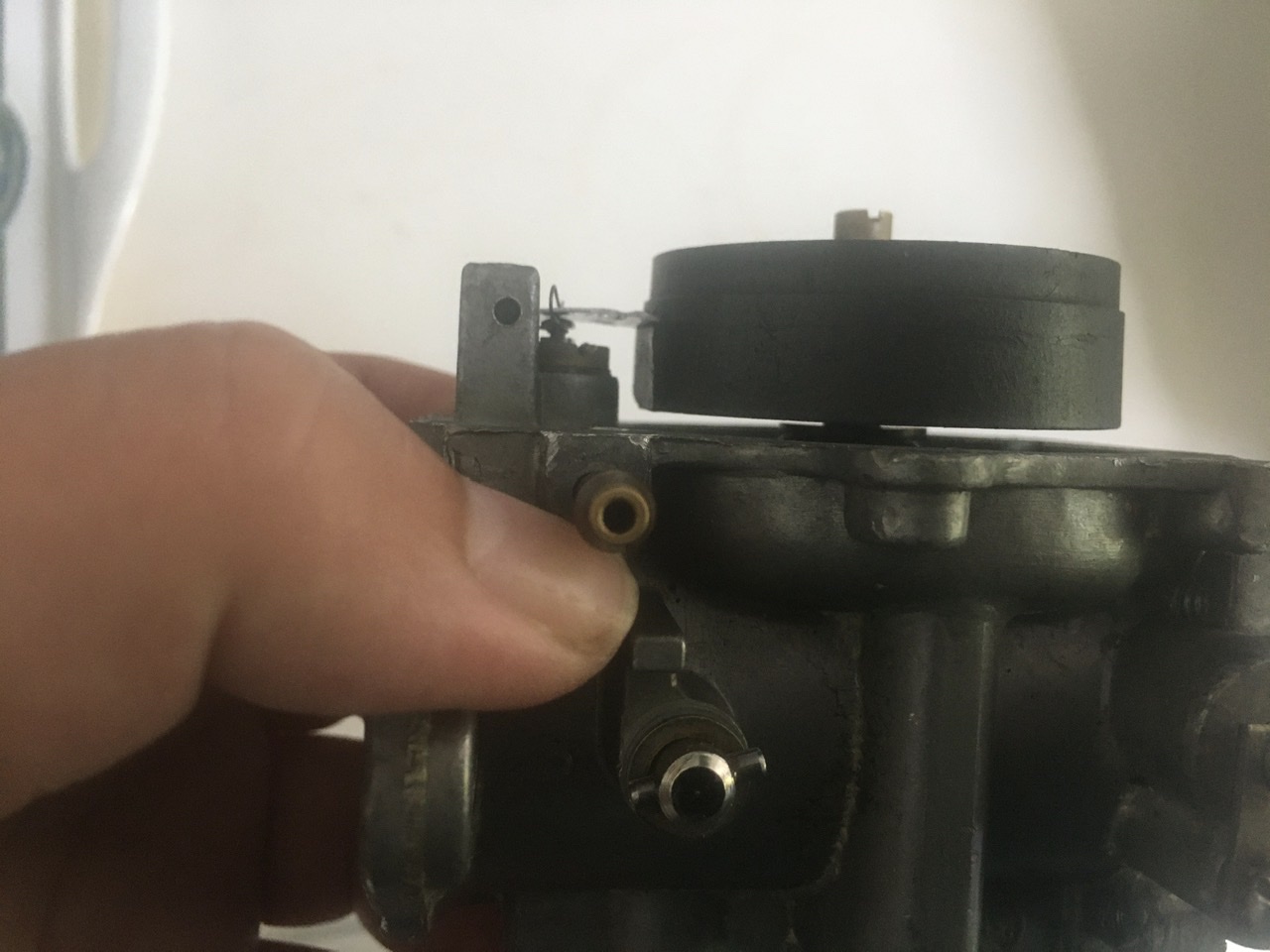

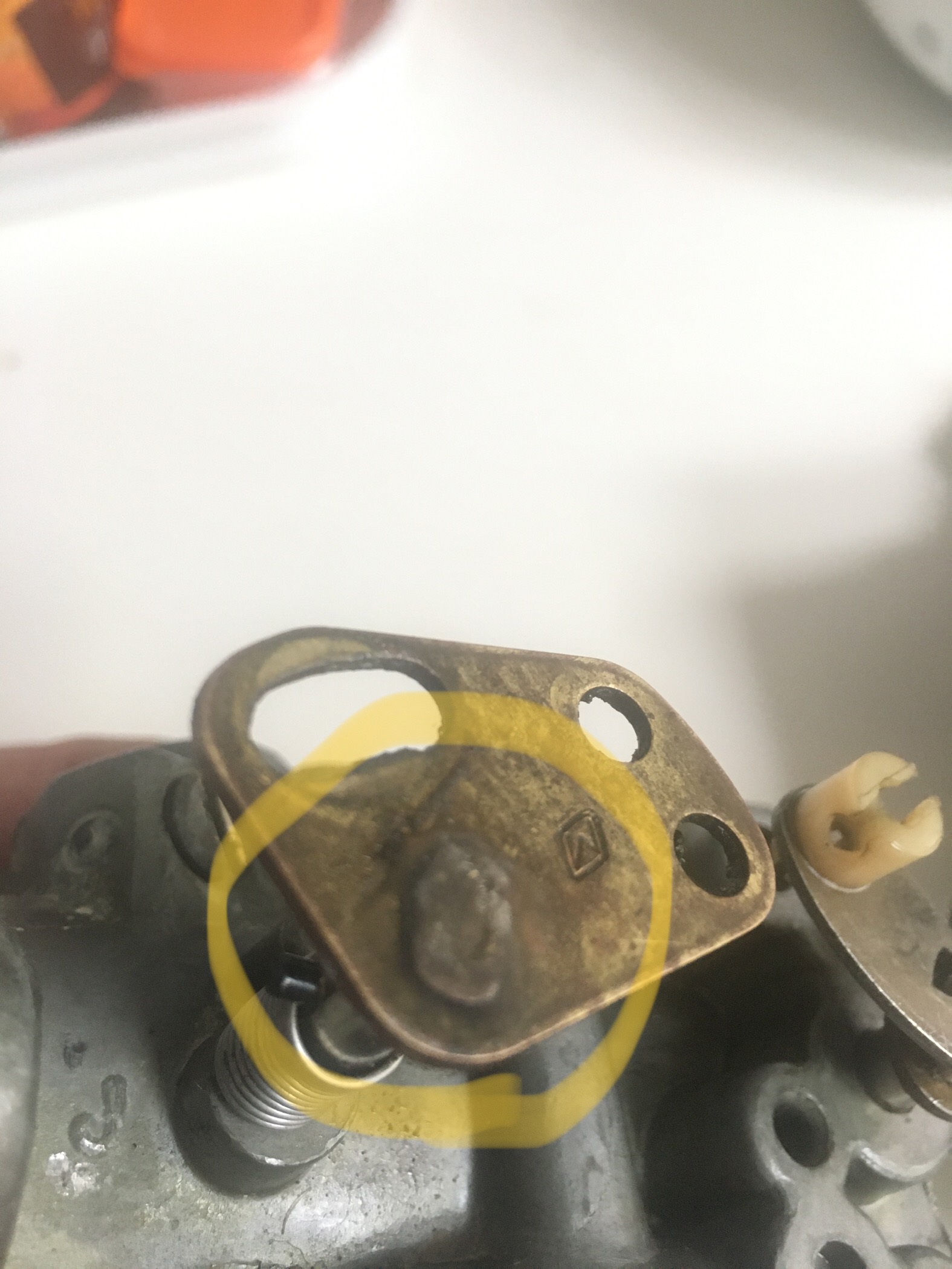

Carbs are clean all jets clean seals new float is right. New hoses too.
New head gasket new thermostat
new pressure springs
New water jacket gasket
New intake gasket
Reed vales all checked and working as should be.

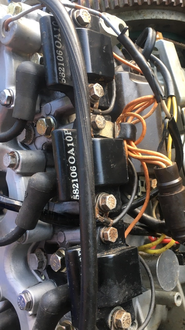

Spark is great jumps over inch gap
Timing seems fine.

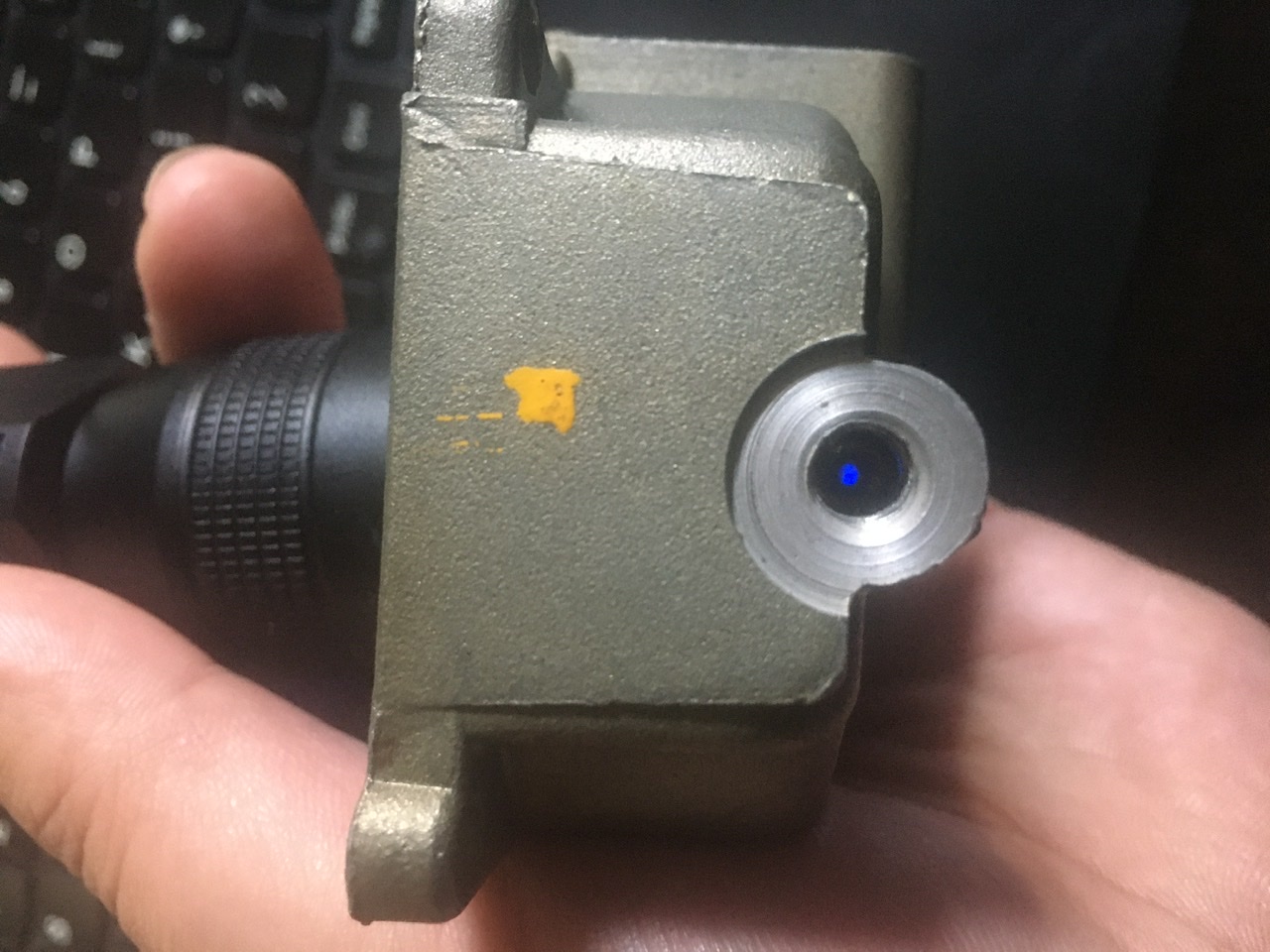

Could it be exhaust housing?
Or any advice on where to look be appreciated!
