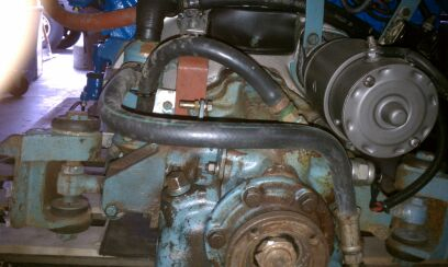

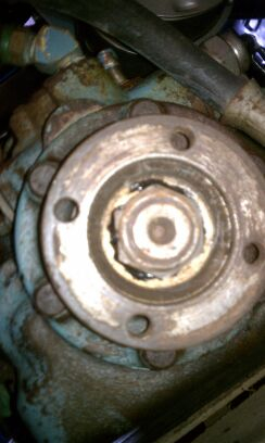

Ric,
I got the seller to take a couple of pics of drive coupler. Can you confirm B/W or not?
Thanks.
Those are original Chrysler exhaust manifolds (ie: old). I would suggest you inspect them where the exhaust comes out of the head to see how corroded they are.
Even with FWCooling, they rust out in this area.
Jeff
