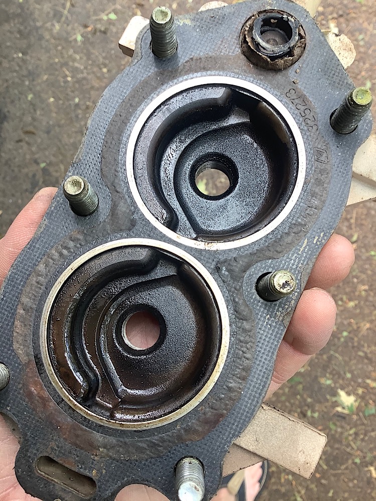

I pulled the head, gasket looked OK, but I don’t know the significance of those bubbles, which are on both sides.Nor the grungy stuff surrounding the thermostat, it seems metallic.
It appears there was some sort of ring surrounding the thermostat, but it now corroded.
It definitely got hot, see the discolouration on the head paint.
The head is definitely warped somewhat, I can just slide an .005” feeler under a straightedge, near the Center of the head.

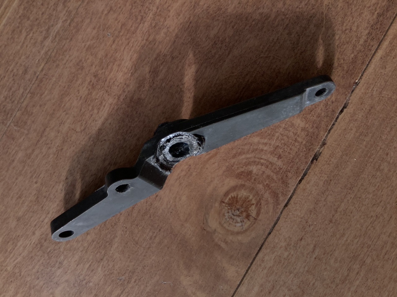

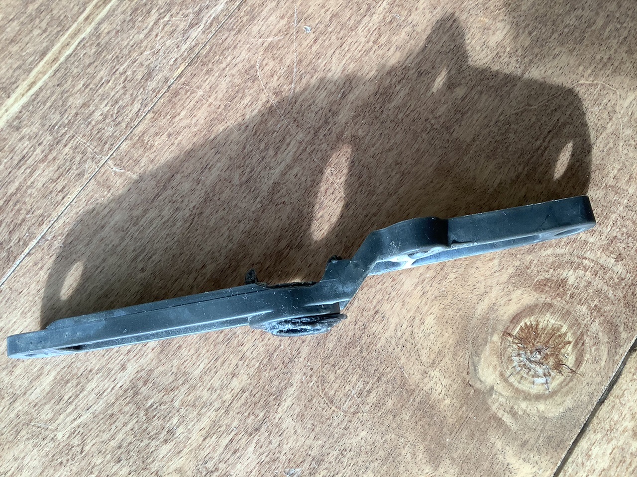

A-Ha. When the previous owner overheated it, it got hot enough to melt the pivot point of the THROTTLE ADVANCE LEVER,(#40 in the parts diagram).
Instead of rotating as you twist the throttle, because the boss was melted, the lever “rolled” sideways, causing the twist grip to bind, & the throttle not to fully advance. I considered JB welding & trying to fix it because
this critical part is no longer in existence, not here, or Evinrude Canada. I scrounged one, installed, (this is where the factory manual was critical), EUREKA, full smooth throttle.

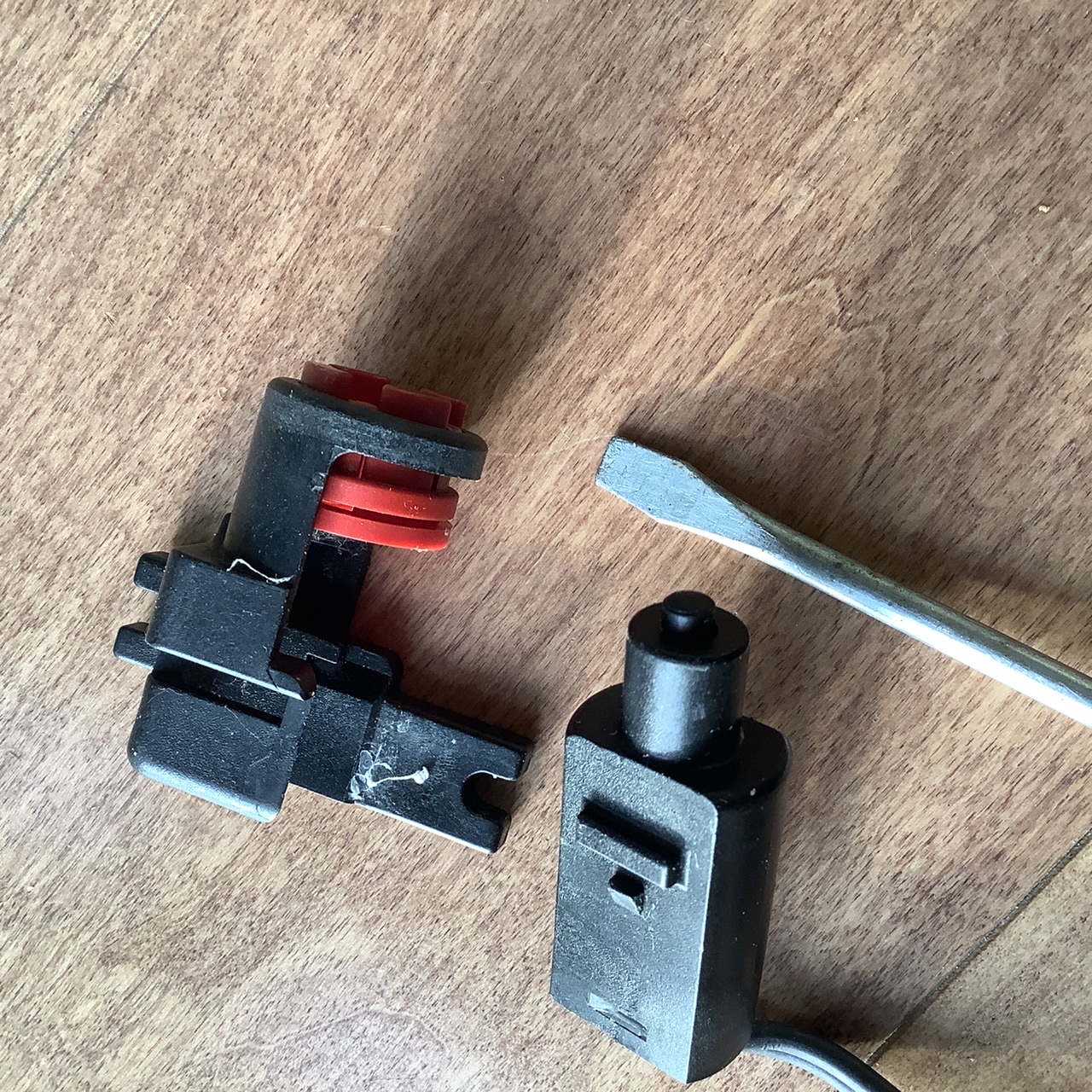

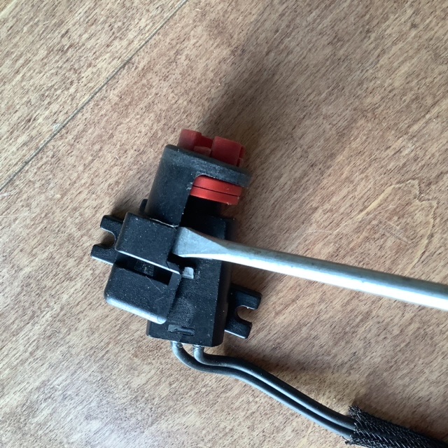

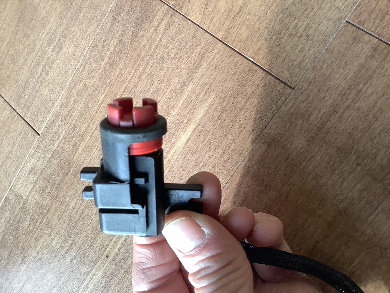

However, upon close observation of the replacement switch, (and being one who leans to the easiest way), these switches bear close resemblance to many automotive switches. There are a couple of small “tits” that actually hold the switch together.
Its actually two pieces that snap together. One part contains the little red buttons, but that’s all it does. The other part is the sealed unit, with a push button that actually makes the connection to ground out the ignition. Using a small flat head screwdriver, in the orientation shown, you can easily split the two pieces.
The RED “button” can then simply be pushed out, inserted into the original fitting, & the two parts snapped back together.
No fishing wires, or splicing if your working pull had the wires cut.
Obviously, this won’t work if the actual sealed switch is bad, but that’s easy to test with a multimeter. If it’s only the “red button”, this makes the job about 10 minutes. You only have to undo the 3 Phillips screws underneath the tiller handle, remove the cover plate, then 2 screws that hold the switch.
