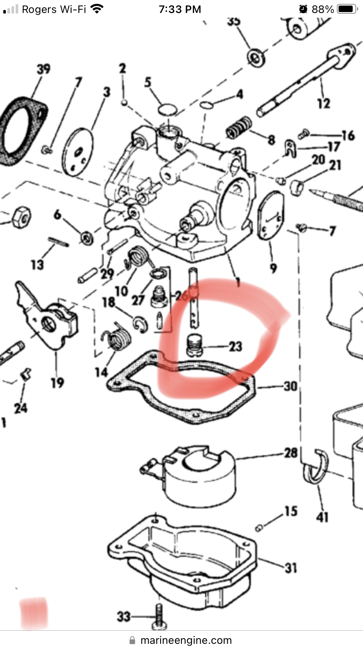

On another note looking at some old pictures of my carburetor I see where I missed putting an orfice onto the bottom of high speed jet. I put the orfice back on and at this point I thought I had some air going into the pump (doing blow test)so I assembled it to motor and gave it a try to start.
It would not.
I will go over the pump assembly again and see if there was anything I am missing.
