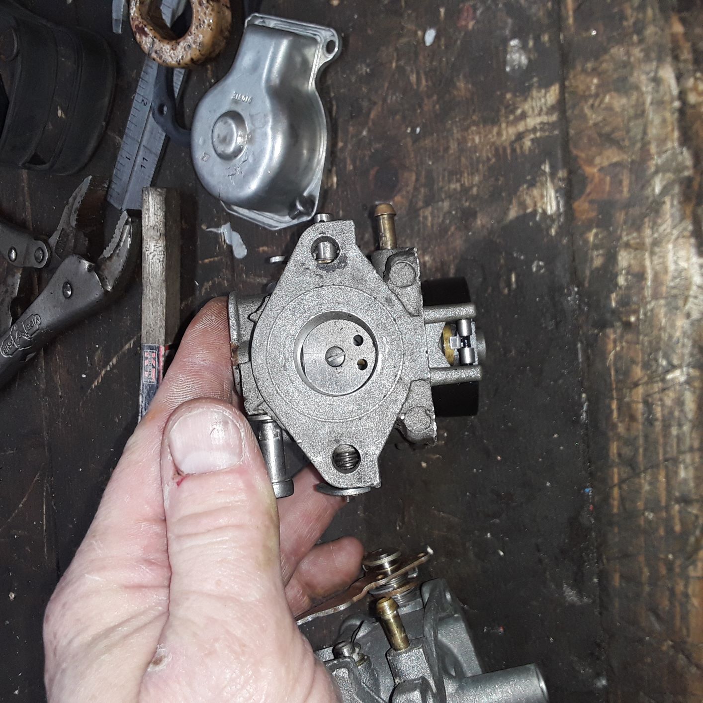

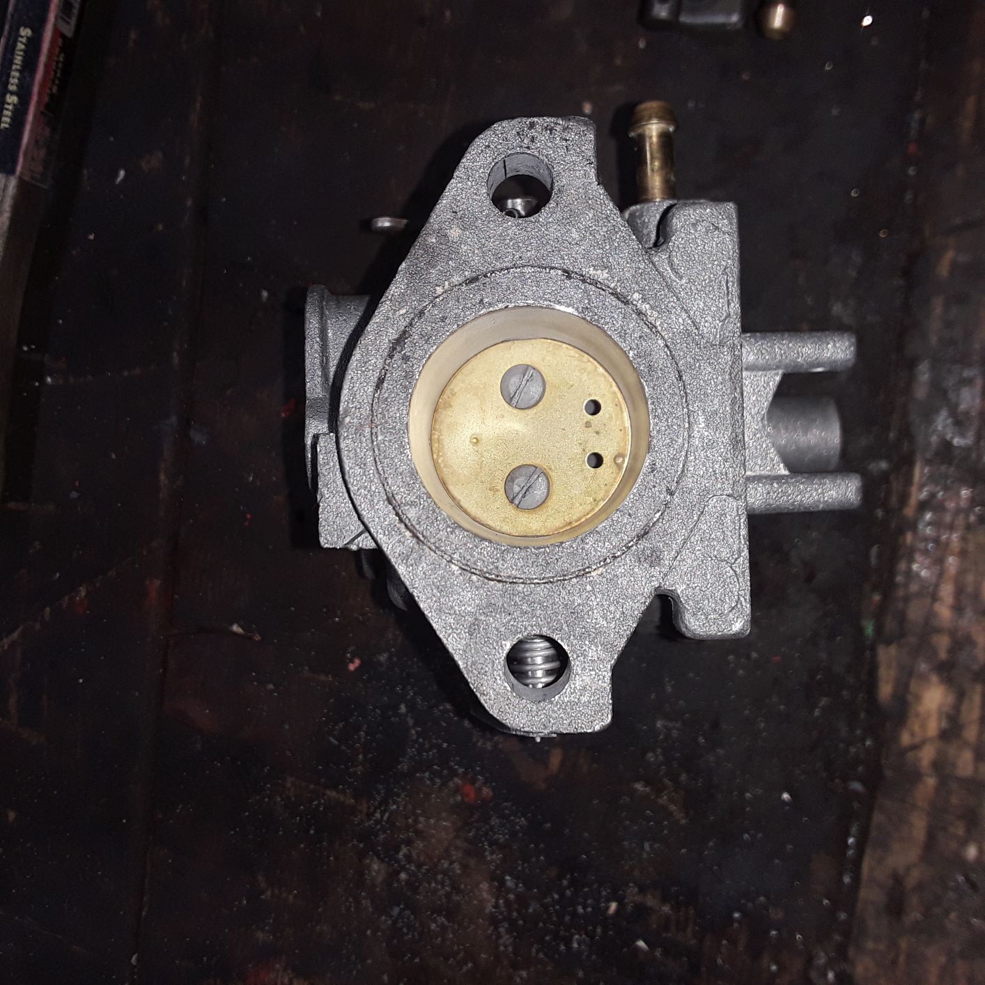

carb A.jpgcarb aa.jpg OK these are Carb A the "15hp"

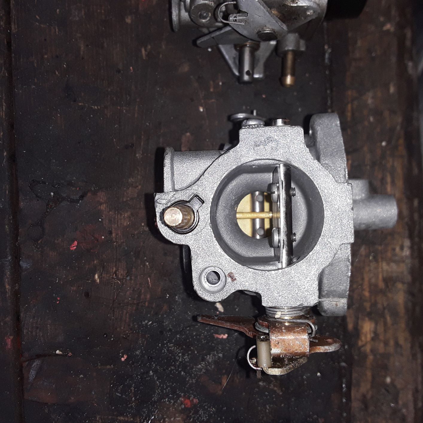

carb B.jpgcarb bb.jpg Carb B "9.9"

UGGGGHHHHH..... Wouldn't you know it. I did one more search, and yes. It looks like I indeed was given a bunk-deal. I received a large bore 9.9 carb. I will wait for a confirm from you guys before i ask for my Peso's returned. Unless I just keep it if this was a better 9.9 carb design and the #38 jet is indeed the correct one.
All my 15 hp carbs do not have the tube through the middle the 9.9 carbs do. Are you measuring in the center of the carb that is where it counts. There is a significant difference in the 2 venturis.
Yep, I measured the inner venturi bore where the brass tubes are. Measured .6875" on old and new-mail ordered one. I thought I had read on one post that OMC made a next gen carb that was for the 15hp that had a smaller venturi than the .875". But that could be the plastic top carb.....
Yes those are both 9.9 carbs one without the tube is newer version. Tell the seller he may refund your money. The problem with part #s on your carb is Evinrude does not seperate the 2 carbs on the parts fiche. The model # of the motor is the part #.
