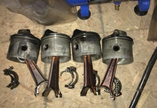

thought i showed u guys what I've discovered in the block. It appears that the cylinders worn out over the years & cylinder 1 was the first to start loosing compression not burning right causing the mixture to leak pass the rings & overheat that entire side of the block. I am left to troubleshoot as to why the heat sensor did not trigger slow mode. I have measure the ring end gap & got .039 give or take a few thou. With that said i plan on going with the .02 o/s pistons hone the cylinders & see how it runs.
