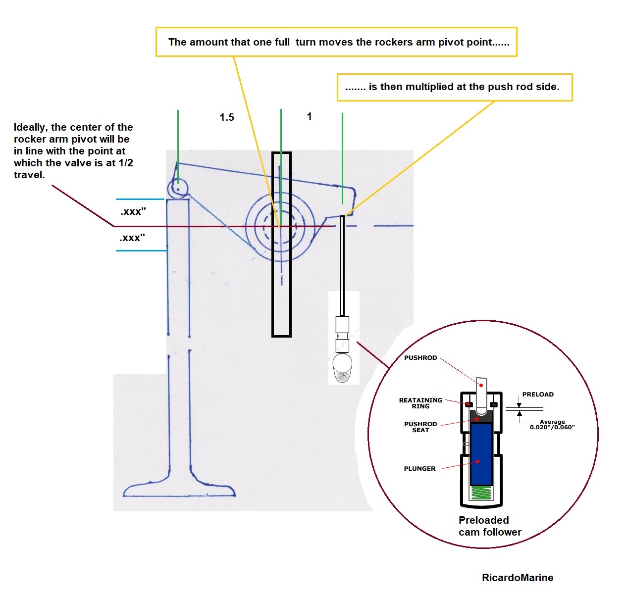

As we know, rocker arm ratio refers to the amount of movement on the valve side of the rocker arm compared to that on the push rod side.
In other words..... X.0 push rod movement upwards (on the rocker arm) equals X.5 movement downwards against the valve stem side.
For example:
A 1:1.5 rocker arm will move a valve 1.5 times that of the actual cam lift.
Let's say that the cam lift is .300".
Multiply that by 1.5 and the valve travel amount is .450".
Now consider the the thread pitch of the rocker arm adjusting nut.
First think in terms of:
.... the valve stem being stationary.
.... the rocker arm adjustment setting the depth of the cam follower's plunger.
If the rocker arm stud/nut is 7/16" X 20 TPI, one full revolution moves the center of the rocker arm .050".
Now factor in the amount that the ratio and the thread pitch affects push rod side, and the number becomes .025" (at the push rod side).
That means that one full nut turn past ZERO lash, sets the plunger into the follower body by .025".
This leaves approximately .075" plunger travel that is un-used.
Add another 1/2 turn to that, do the math, and you will see where this would set the plunger.
Not deep enough, and eventual
component ware may cause the plunger to top out, causing what we call rocker arm clatter.

The affect of the rocker arm ratio (on the push rod side), would actually cause one full turn past zero lash (using a 7/16" X 20 TPI stud thread pitch) to set the plunger more like .062" or .063".
Somewhere I have an old drawing that I'll try to find.
If I can find it, I'll post it.

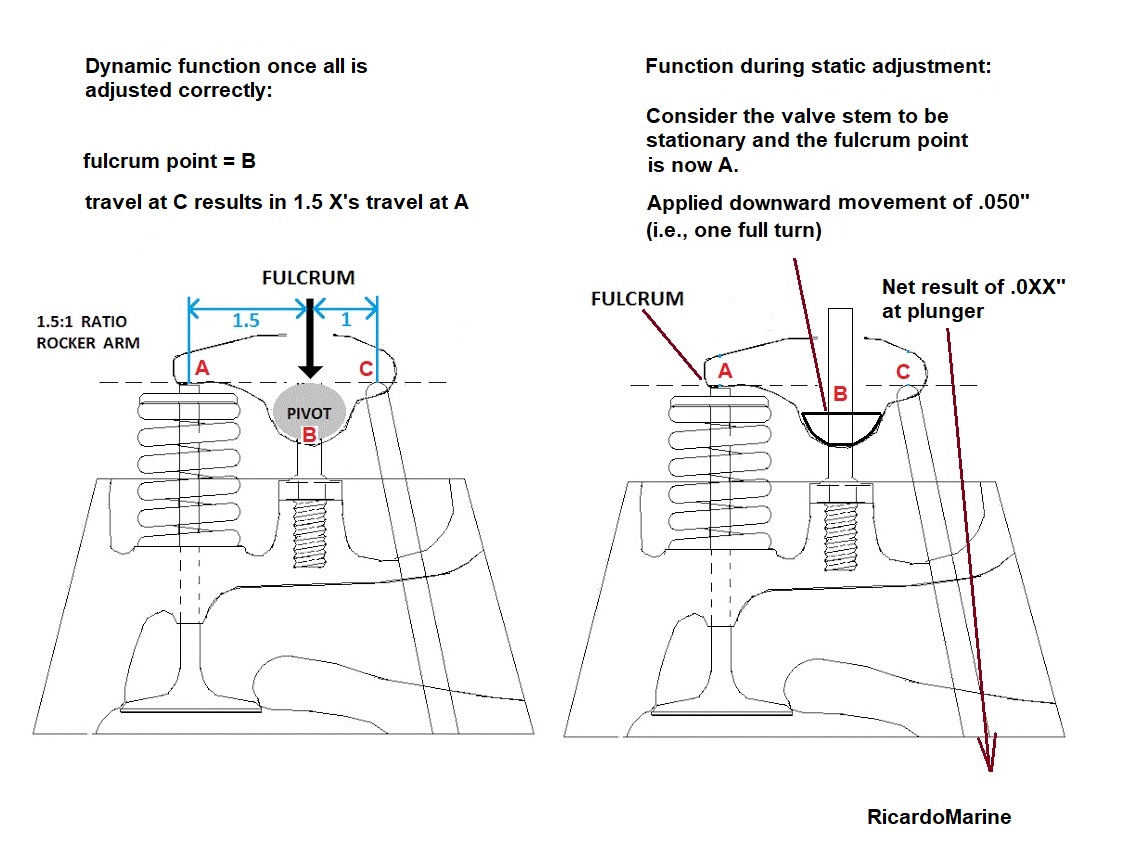

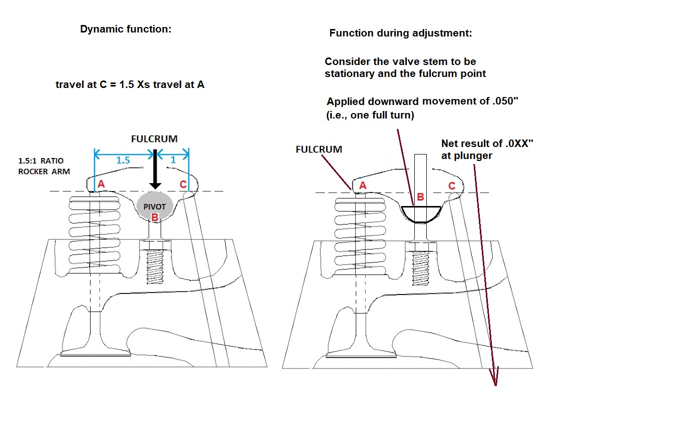

During the static adjustment, consider the valve stem to be stationary and the fulcrum point.
The push rod will be the area that will realize the result of the rocker arm nut adjustment..... one full turn!

probably your geometry vs the math....
Assuming rigid bodies and ignoring the minor issues with non-perpendicular interfaces, here's my view:
with the valve stem tip being fixed, rotating the rocker nut one turn moves it 0.050" downward. the pushrod end will move down even more, in proportion to its 'extra' length from the fixed point. so pushrod moves down by Y = 0.050"/1.5 *2.5 ~ 0.083".
For an alternative view, assuming the rocker starts in a 'horizontal orientation', spinning the rocker nut down one turn caused the rocker arm to sweep an arc defined as tan Ф = 0.050/1.5. The pushrod's displacement is then 2.5 * tan Ф which yields the same value...
