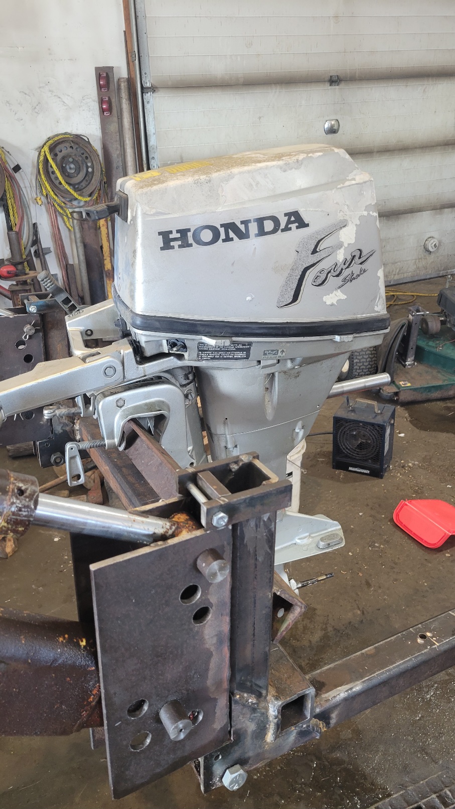

Acquired this little jem
siscoken

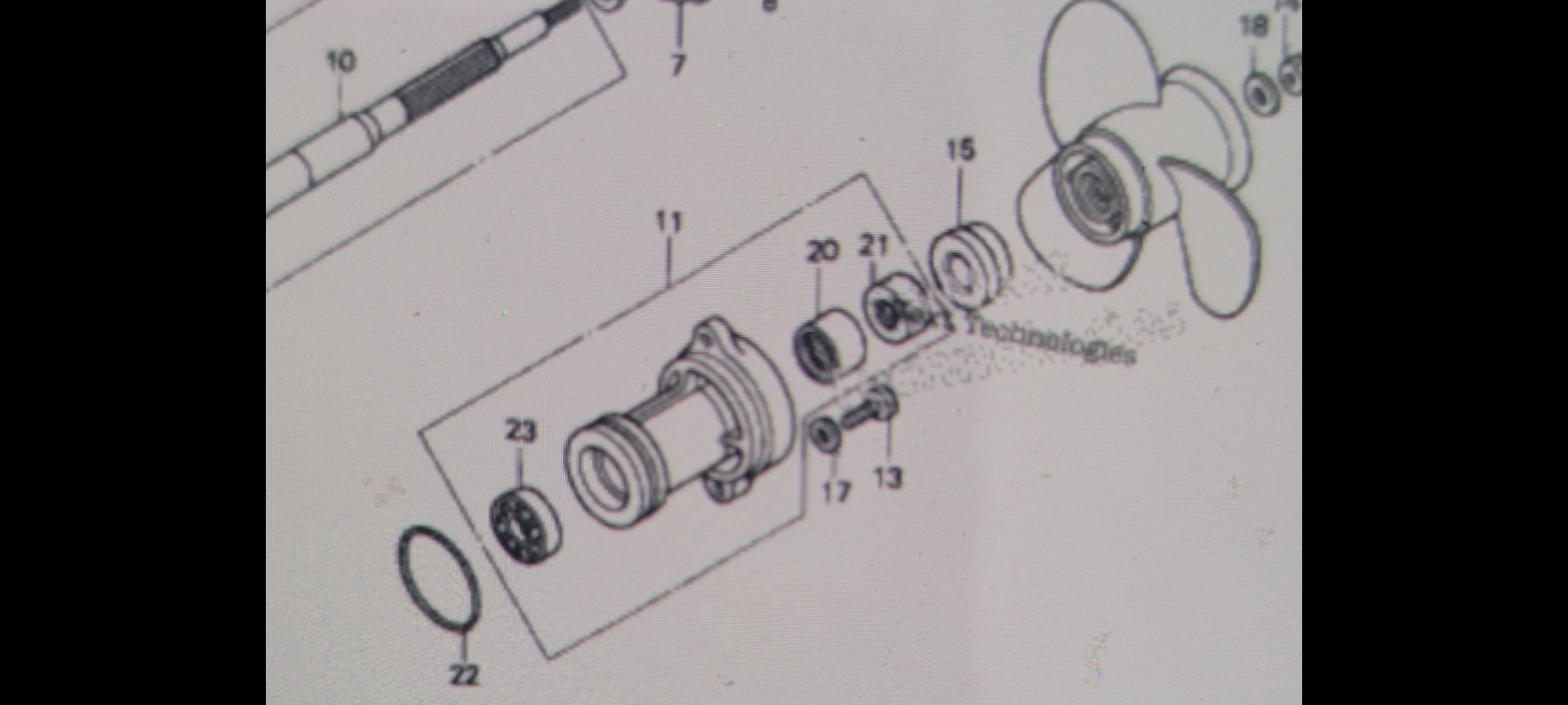

Mid 90s 15 hp baas .... after carb clean, starts and idles like a dream.... in need of lower unit parts.... #11 in diagram.
What is wrong with your bearing housing ?-----Not repairable ?----Your location ?
The prop shaft bearing support is broken ... not repairable... when I look up by part # 41200-ZV4-040ZB ..... part is not available .... is another part that may supersede .... that is 41200-ZV4-010ZA .... but I am unable to confirm fitment.

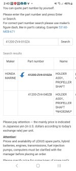

I typed the part number
41200-ZV4-010ZV
Into yumbo.jp.com and it does say that it's the "part number replacement" for the discontinued 41200-ZV4-040ZB.
But.....
There is a line through the number and no price is given so that makes me wonder it that number (part) isn't available anymore either.....???
I don't know.
But if you found a propshaft holder with that number then it should be a good fit IMO.
I'll attach a screenshot of the page you can examine.
Good luck.

Hi siscoken,
Nice find.
41200-ZV4-010ZV
But.....
I don't know.
Good luck.
