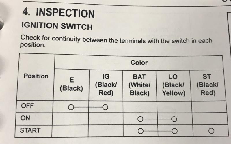

according to the manual the start wire off of the ignition switch is the Black/red wire. I’m installing a Blue Seas ACR battery isolation system and by hooking up this wire it isolated the house battery while starting the engine, eliminating all shunting of the electronics on startup.

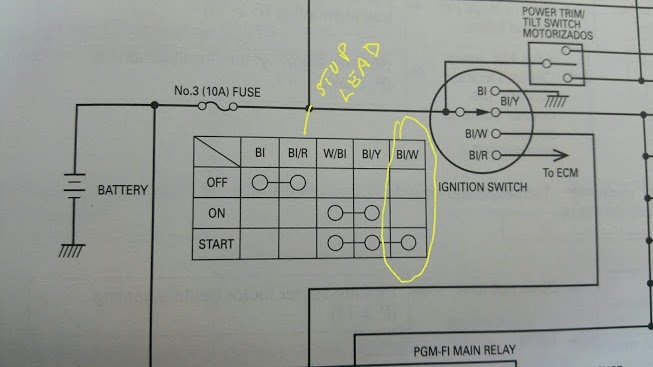

I am not sure where you got that diagram, but it is not correct. The red black lead is the stop lead. When the key switch is turned off, it is shorted to ground.
Here is a different look at it.
If you are in doubt, use a test light to see which of the two leads has positive 12 v on it when the key switch is turned to start.
Mike

That diagram was out of my shop manual. Well...that’s stinks ....I’ll take a look with a test light this week sometime and make sure. I have plenty of heat shrink crimps on hand so it’s an easy change.
Thanks Mike
