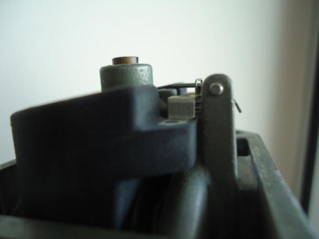

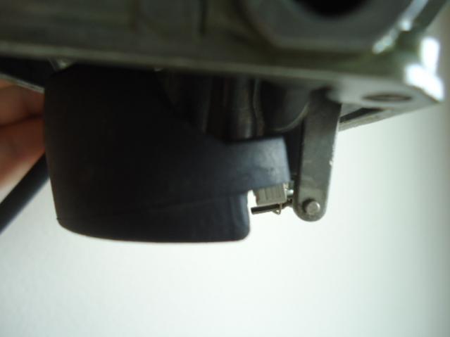

I am attaching photos of my carb. The float is NOT parallel to the casting. Perhaps the metal tab is bent?
Bob

Looks off to me. You must check it when inverted. When inverted, the float should be parallel, It is adjusted by bending the tab. That's the shutoff point for the gas. When upright, it needs to drop down in order for the needle to open and the fuel to flow.

Time to go through the motor systems methodically. Your problem and the fuel vent event may be coincidental. Check the spark plug color. Black soot is way too rich, white is way too lean. Should be tan. You didn't specify exact model -- If this is a 4-stroke (carb looks it), check crankcase oil level. Must not be even a drop over filled. As for the needle, if it completely shuts off flow when the carb is inverted, and flows freely when upright, it should be OK -- but if you see an indentation in the viton tip where it was jammed against the seat, it should be replaced.
