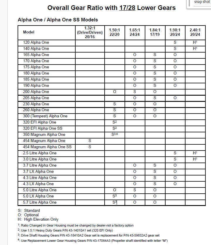

I have a Alpha 1 Gen1 with the # OD463386 on the side of the upper 3 inches below the vent screw. There is no Gear Ratio number. It is a 22' 1992 Bayliner Ciera Series 2255 " sunbridge" 305cu. in. GM engine 175 hp. I have been told # OD463386 is a model 5010198CS with a 1.98:1 final gear ratio. Also been told all lower gear ratios were 1.62:1. I have counted the gear teeth in the upper a number of times and get 22 teeth on the driving gear, the shaft with the U-Joints, and 20 teeth on the vertical drive shaft for a 1.1:1 ratio.
1.62/1.1= a 1.47:1 final gear ratio. What am I missing here????

With the # OD463386 it is a 1990 unit, I have checked that out with Mercury dealers.
I cannot find anyplace in the manual that lists the 22 tooth drive gear and a 20 tooth driven gear.
I also cannot find in the manual a reference to lower gears that would give me the 1.98:1 final ratio.
Thank you, What I think happen is the upper housing that has the # OD463386 on it is a replacement. I did 5 turns on the drive shaft to the lower and got just a tad over 3 turns on the prop shaft So with the 22& 20 gears on top and the 17 & 28 Gears in the lower it would be right about a 1.50:1 final . once again THANK YOU
