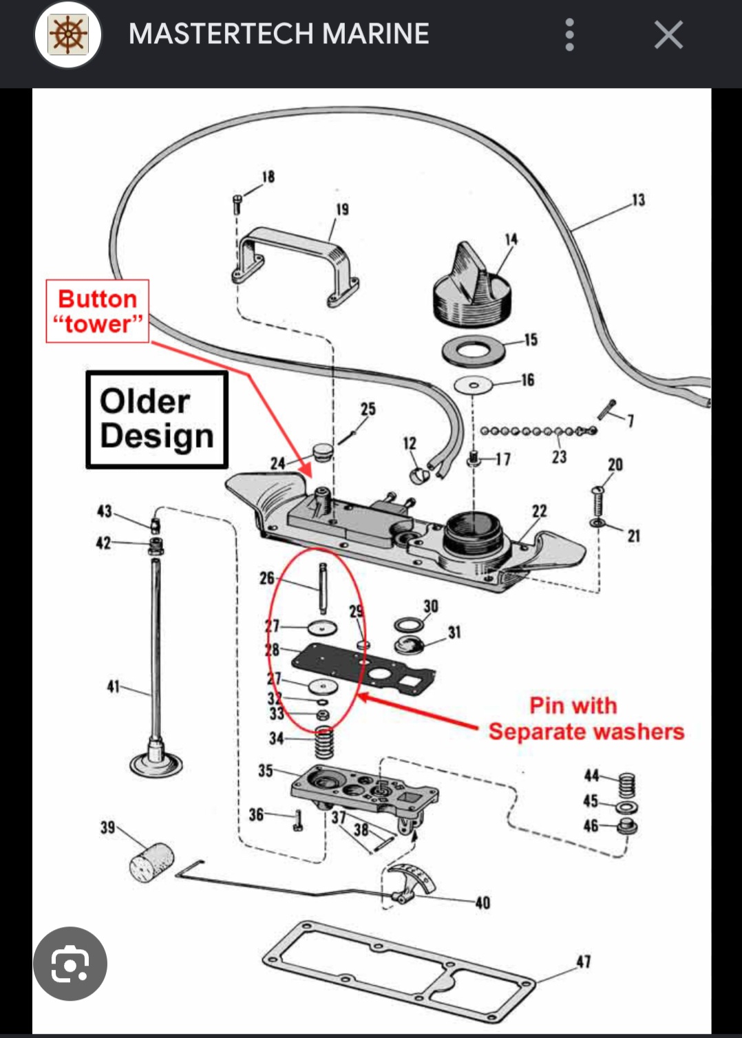

I need the pressure unit that mounts on top of the tank rebuilt.
I believe its a ‘57

I rebuilt it last year it leaked this year took it apart now it wont build press.
Im done messing with it ill gladly pay someone a fair price to do it for me.

Ya know after rebuilding it, it worked fine however it leaked so I took it apart put it back together it didnt really seem to build press that well.
I got flustered and am looking for someone who lnows what there doing and have them rebuild it.
