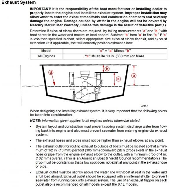

The Thru-Transom exhaust outlets will also need to be 95mm capable.
I didn't know if I needed to create some type of back pressure when running straight exhaust, or if the back pressure from the mufflers I'd use would be enough.
Best to acquire as little restriction as possible.

The MERC install manual for 305/350 SBCs stipulates either a minimum single 4" exhaust outlet or dual 3"... and a SBC is an SBC regardless of whose decal is on the engine for most things.

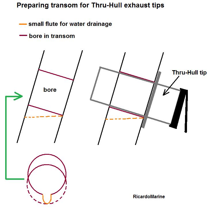

Thank you Sand, for the info. I figured it would be somewhere around the 3" mark for duals give or take some. I'm just gonna run with 3's then I guess. When I drill out the holes for the exhaust tips, do I just use epoxy on the transom wood and exposed core, to help seal and protect it, prior to final installation of the exaust tips?
FYI... I measured well over 6 psi back pressure with my 5.7 thru the 280 Y exhaust. When I went to thru transom w/ mufflers ( NJ laws!) , I instantly got another 450 RPM... and it was quiter @ cruise at the helm than the original 280 exhaust port. Sounds neat @ idle :)
The exposed core of the transom should be well protected before you install exhaust tips.
thru hull exhaust outlet bore.jpgRicardoMarine gave me this when I did mine. I did coat my holes with a thin later of Marine Tex when I did mine also.
