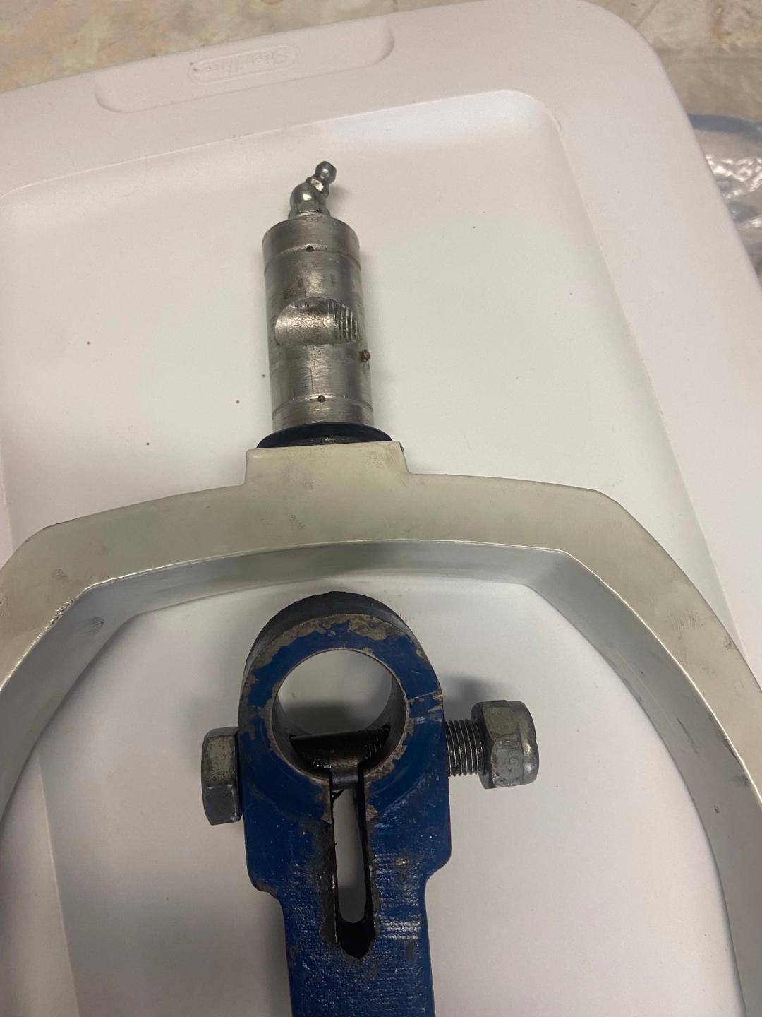

OK, success and I indeed have something different than what I've seen on the board here.
1) No splines on fork shaft, nor were there any it appears
2) There is indeed a half cylinder recess milled into the shaft for the steering arm bolt
3) Steering arm is a beast. Holman Moody part and it has no splines either.
shaft diameter appears to 1 3/32. Is that a standard size I can get bushing and a seal for?
steering arm pinch bolt has no real effect on gap...can tighten bolt to the point of near breaking and it has no effect on the opening. Whoever installed this (I assume original) really screwed up. Would suspect there was little play at first, but in no time I presume (because the shaft is aluminum) there had to wear to introduce the slop I see today. 54 year old boat so it probably at least worked for a while.
Not exactly sure how I'm going to solve this, but very likely, per RichardoMarine suggestions, i'll cut the groove deeper in the arm and very likely cut out a section opposite that groove to allow the pinch to actually happen somewhat more uniformly.
I THINK i've attached pictures, can't say until I submit.

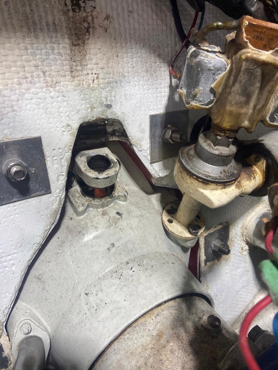

The picture of the transom housing and shaft boss includes a shot of the tilt motor encased in some kind of, what looks like epoxy...anybody run into this in the past? Potting that stuff like this was probably a good idea but 10's of years later it is breaking down and will now hasten corrosion by trapping moisture. I'm all ears on how to get this stuff off and any ideas on how to make a more secure connection between the steering arm and steering yoke shaft.

if you have access to some machine shop facilities.... cut ( mil) a slot to take a woodruff key 180 degrees across from the slot in the arm. Cut a corresponding one in the shaft. Many years ago I had to do something like this on my brothers circa 1973 Datsun 240 Z when the keyway on the end of the crankshaft got sloppy and the vibration damper started to wobble. I cut the existing keyway on the vibratin damper wider and deeper with a hand file while it was in a vise and opened up the keyway on the crank ( while still on the engine in the car) with a stone mounted in a flexible shaft tool.
If you do this, don't get the location of the keyway off by 180 on the steering fork :) Alternatively if there is enough meat in the fork for the next larger bolt, mill/file the "groove" to a v profile to wedge the larger bolt. If I was doing this, I'd go with a key.
IF you're doing the key, be sure that the final fitment, i.e. the widths of the slots in the arm and shaft is done with a hand file, just a few strokes at a time... you want a smooth, snug fit.
Was thinking same thing with square key instead of woodruff.
Shaft would have to be milled all the way to top, then when installing, stop when yoke shaft at bottom of boss opening..'surgically' place key through top of boss opening then continue to move yoke up. Key will be held in place by upper boss.
Is that about what you were thinking?
I know there must be a reason, but hard to figure how this approach to the connection was better than the spline connection from Volvo. The steering arm is 15/16 think, don't know if all Volvos of this type have an opening for that thickness.
Volvo Penta dealer/service center says no way am I going to find the bushings and seals. Showed me the yokes on the drives sense and easily 50% beefier. Mine is apparently from way back (is indeed an AQ250) and that style had a tendency to bend in certain conditions. Based on the later ones he showed me, I get it.<br>

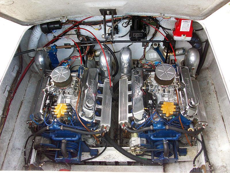

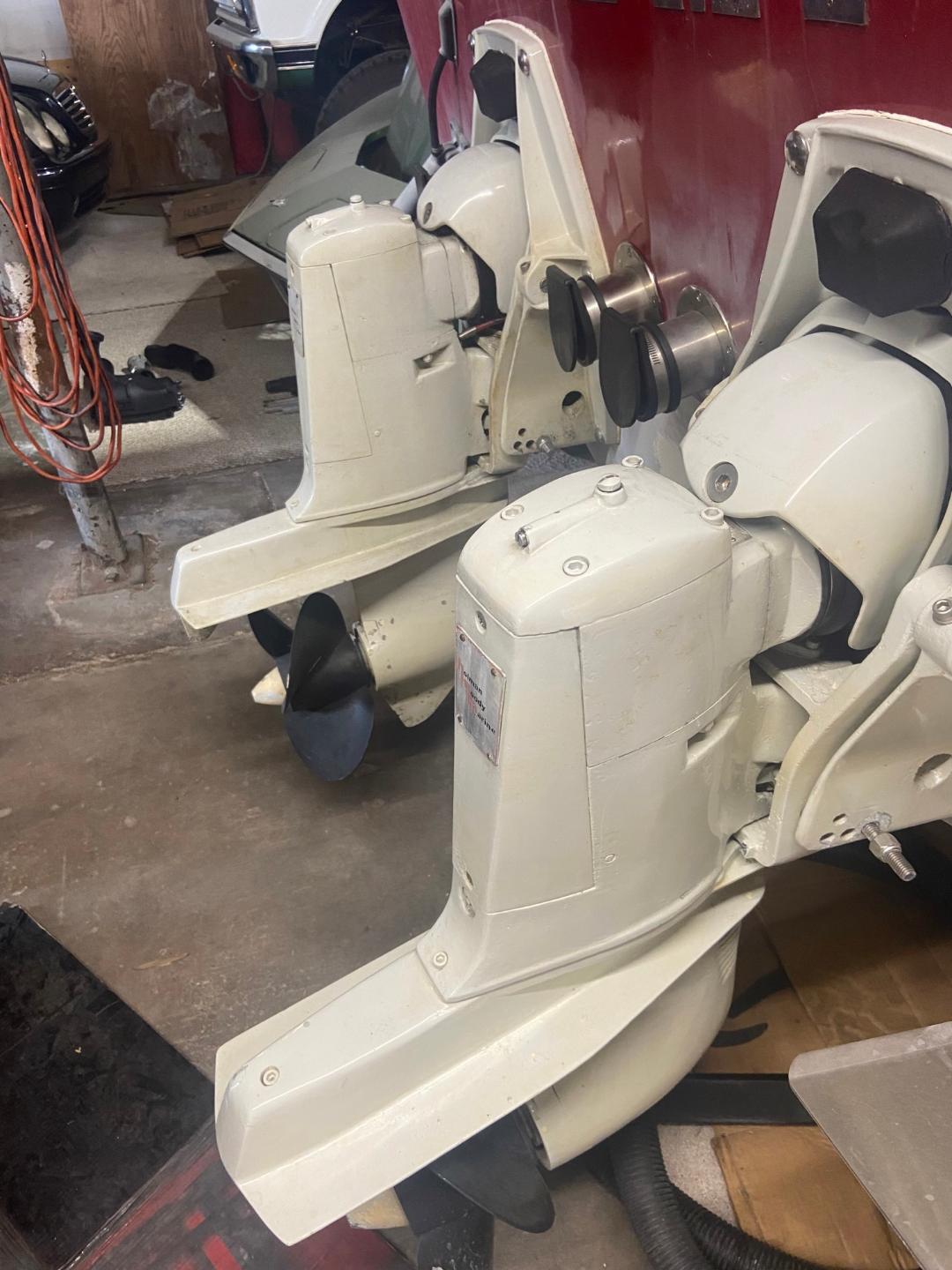

Any one have a line on parts for what appears to be some kind of unicorn?<br><br>Included some pics of boat to explain why I'm trying to get this one solved : )
