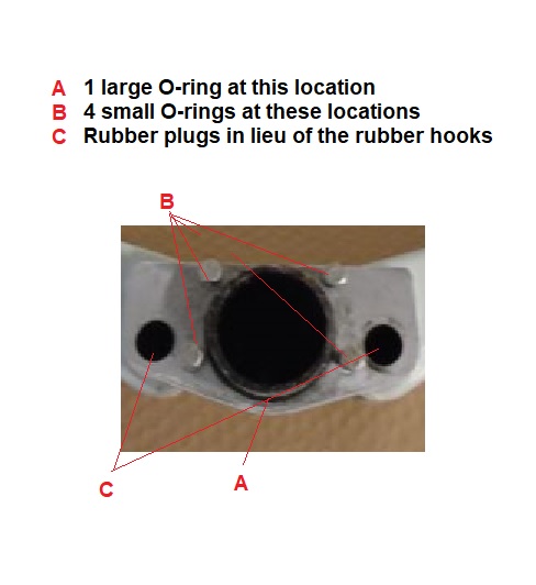

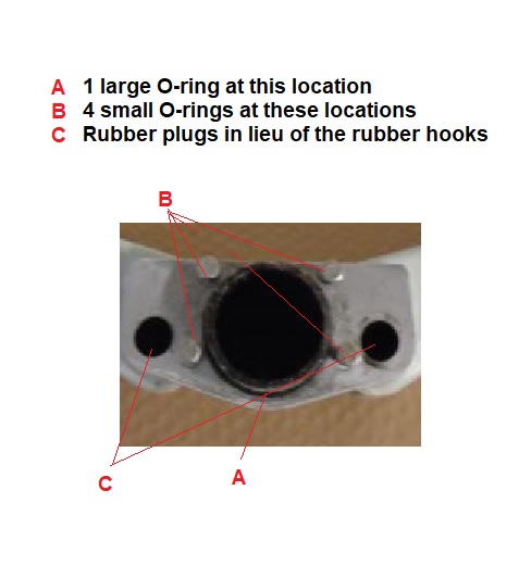

You'll be hard pressed to find an OEM block-off plate for the early 280 PT application.
Suggestion:
Remove the OEM Y-pipe.
Use the Y-pipe mounting surface as a pattern for a properly made block-off plate.
Build this plate from a material of the correct thickness.
Use O-rings similar to like what the OEM used.
Use the 3M 5200 if so inclined.
Take several good pictures of your block-off plate and how it is mounted and sealed.
Hire a marine surveyor to examine your block-off method and to write up his assessment of it.
Send the info to your insurance company and ask for their blessings.
While some insurance policies will cover owner errors (aka "stupid"), I would still take these precautions.

I think I'm gonna take the blockoff route and make a plate similar to OEM or better. Should the blockoff plate be made to sit on the inside of the transom like three current y-pipe is, or does the blockoff plate need to be made for the outside?
- I'm assuming to use the exhaust surface to make the blockoff plate for the inside.
- 5200 it on the inside, along with 5200 the thru bolt holes and relief holes.
- tighten marine grade stainless bolts gently snug and let 5200 cure.
- then come back and tighten up stainless bolts a little more for a little extra sandwiching effect of the 5200.
Does that sound about right? Or, should I be looking for some type of o-ring and cut recess grooves into the blocking plate to hold them in place and use those for sealing?

I would make one for the inside area, and would use the OEM bolt pattern/holes to secure it.
But again.... run this by a surveyor and/or your insurance agent (if you insure this boat).

Most all O-rings come to rest within an O-ring grove/recessed area to ensure that they become properly compressed and that they do not slip out.

I think that you'll be hard pressed to find anything for an older 280 PT drive.
Eureka!!! I found a full OEM block off kit from a local boat shop for $100 for the 280 w/dual relief! It's old 'new stock' someone never came to pick up or whatever.
It has 2 rubber plugs/puck looking things for the reliefs, a thick O-ring for the main exhaust hole, and a wide backing plate with 4 bolts. So, looks like I got super lucky. Should I still have an appraiser/insurance check it out afterwards?
Before I found this, I already ordered two new rubber hooks (was going to use the base of those (installed normally) as the "sealers" for the reliefs, and find an o-ring for the exhaust port and just make a plate.
So, if anyone needs any AQ rubber hooks I've got a brand new pair on the way I won't be needing now.
Given stated corrosion issues with drive, make sure the "Seating" groove ( and opposite mating surface for the O-ring is in good shape. Normally O rings only need , at most some lube on installation, If there are any pits or voids, I'd consider partially filling the O-ring groove ( or mating surface if corroded) with a flexible when cured sealant. Good find on that blocking plate !!!
Don't forget "flaps" on the external exhaust ports!!!

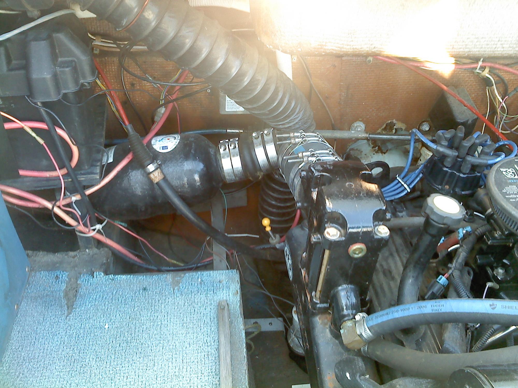

My thru hull exhaust project was complicated by NJ rules on noise that ended up with having to use mufflers ( shorty fiberglass ones) inside the transom.
BTW... I got an extra 450 RPM at WOT when I went thru transom w/mufflers. The Exhaust passages thru the 200 series drives are woefully too small for 350 CID/ 5.7L engines... The Merc installation manual for the 5.7 MIE ( 260HP w/carb) specifies a MINIMUM of a single 4" dia hole for a single port exhaust, and even the 280s with the dual reliefs are TOO SMALL. I measured the back pressure with my stock 280 drive and thru drive exhaust and it was over 6.5psi....waaaaay above factory limits.
Yeah, I went with dual 4" thru hull slashed exhaust (no mufflers yet, because there's literally ZERO room from the elbows to the exhaust tips. But, I do have internal flappers and plan on adding internal baffles before this season.)
I gained SERIOUS top end difference vs before with all the restriction. I had to readjust my rockers to compensate, but definitely much better having the thru hull. The only con is the louder noise at high speeds, but I think the baffles will help a lot with that.
I had room for mufflers because Chriscraft used an extended housing that allowed the use of "bob tailed" , i.e.Chris manufactured, engines. For that matter any "Borg Warner" patterned engine, hence my crate 5.7MIE. That expended housing moved the engine several inches forward. My center rise 4" merc elbows go to a 4" to 3" elbow which allows room for a pair of fibergalss mufflers to be oriented parallel and down ward to 90 degree elbows out the transom at the extreme port/starboard ends of the transom, at the recommended distance above the waterline. I had to do some work to relocate the batteries as they used to be on the deck next to the engine.

Yeah Sandkicker, I wish I would've had room to go 90-degrees off the elbow like you did, but unfortunately I had ZERO room for any other option than to just go straight out the back... Which, left me no room for internal muffler. So, I think im gonna just build baffles to slip into the aft side of the exhaust tips. I'd put them in before, but my tips have shutters in them and they're near the front 1/3 of the tips near the engine side.
The FIRST time I did a thru hull exhaust on a Chriscraft, it was on the same series hull. I had installed a Chrysler LM318 engine with center rise exhaust manifolds. I reversed the manifolds/elbows ( right to left) and the elbows and had them pointing FORWARD. Then I put in a short stub hose and a 72 degree elbow, DOWN, then hose down to just above the waterline, then a 90 degree elbow aft and hose back. I installed the mufflers directly on the transom UNDER the exhaust manifolds. A pain to change spark plugs, but it worked. Was not able to do that with this particular MERC as there was waaay too much in the way ( remote oil filter mainly) for the forward/down/back route. Back then, I used Salisbury neoprene mufflers.
