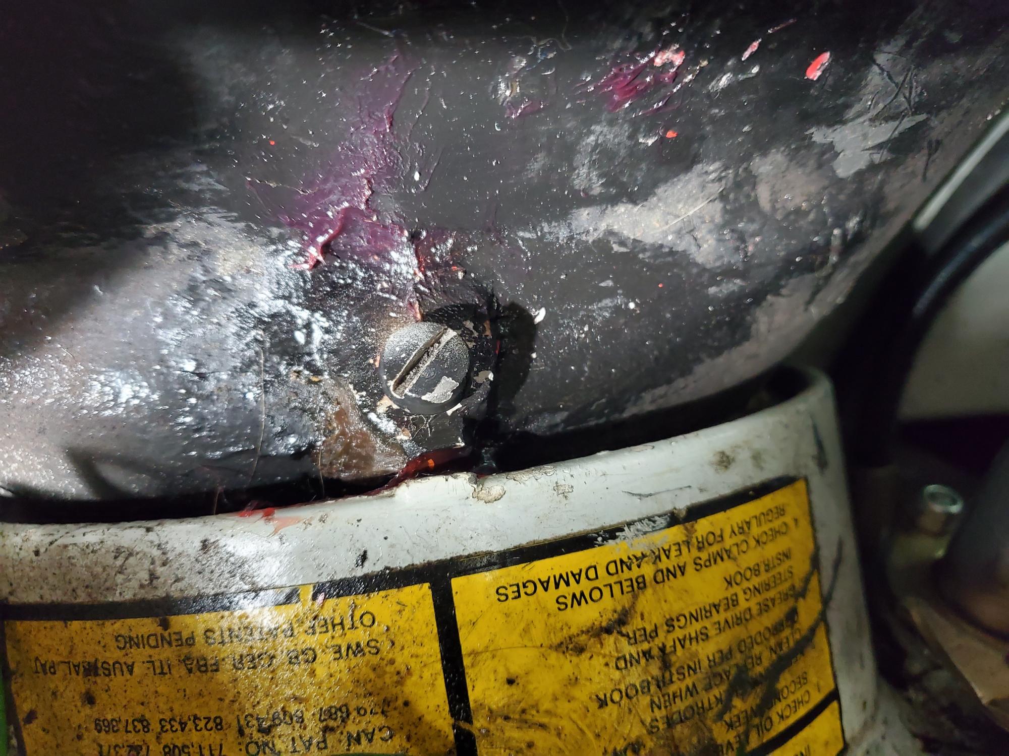

Where are the grease fittings in the bearing crosses?
They should be in the apex of the cross like shown below.
shopping
If they are in the bearing caps, they will contact and damage the bellows.

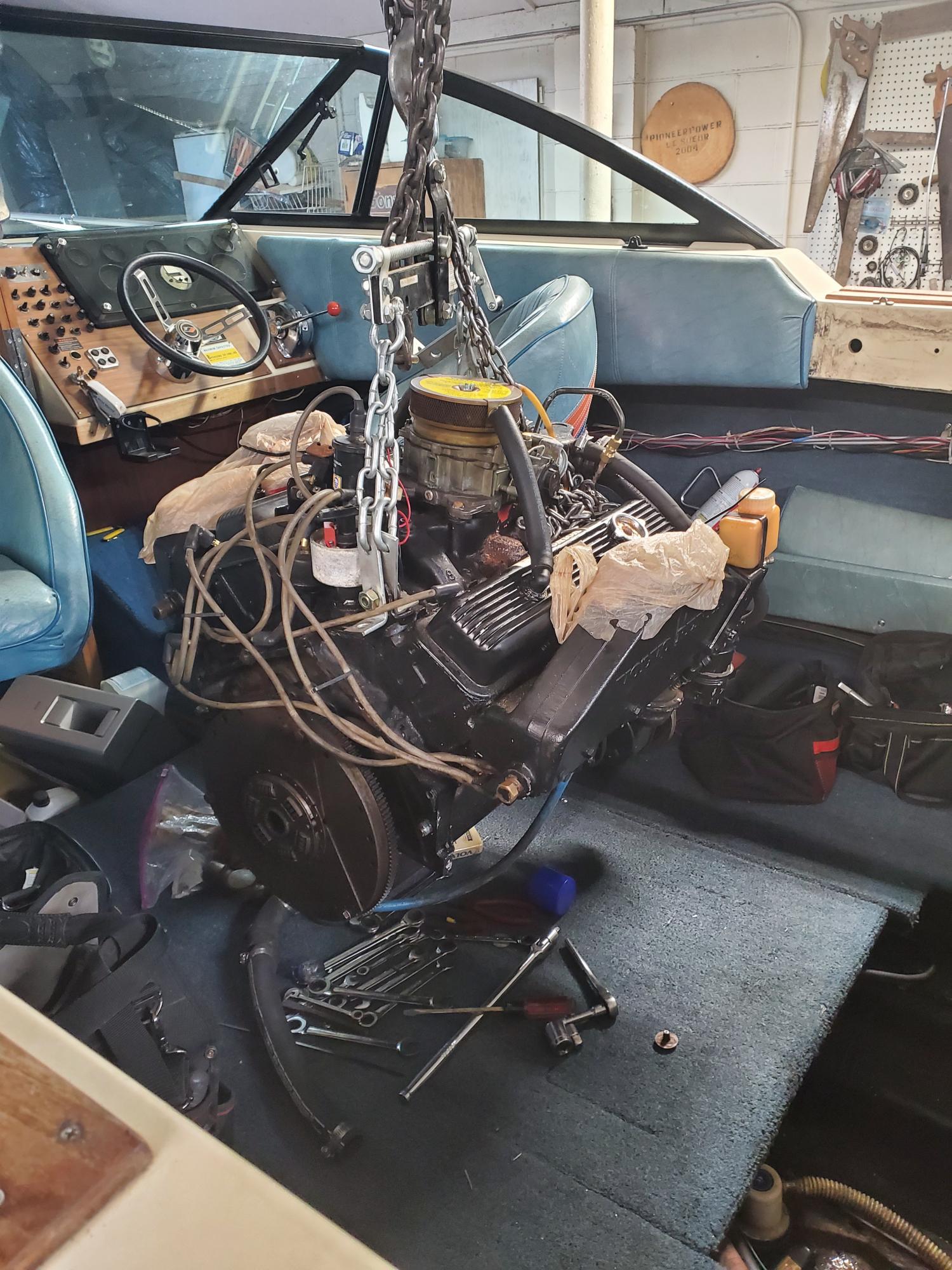

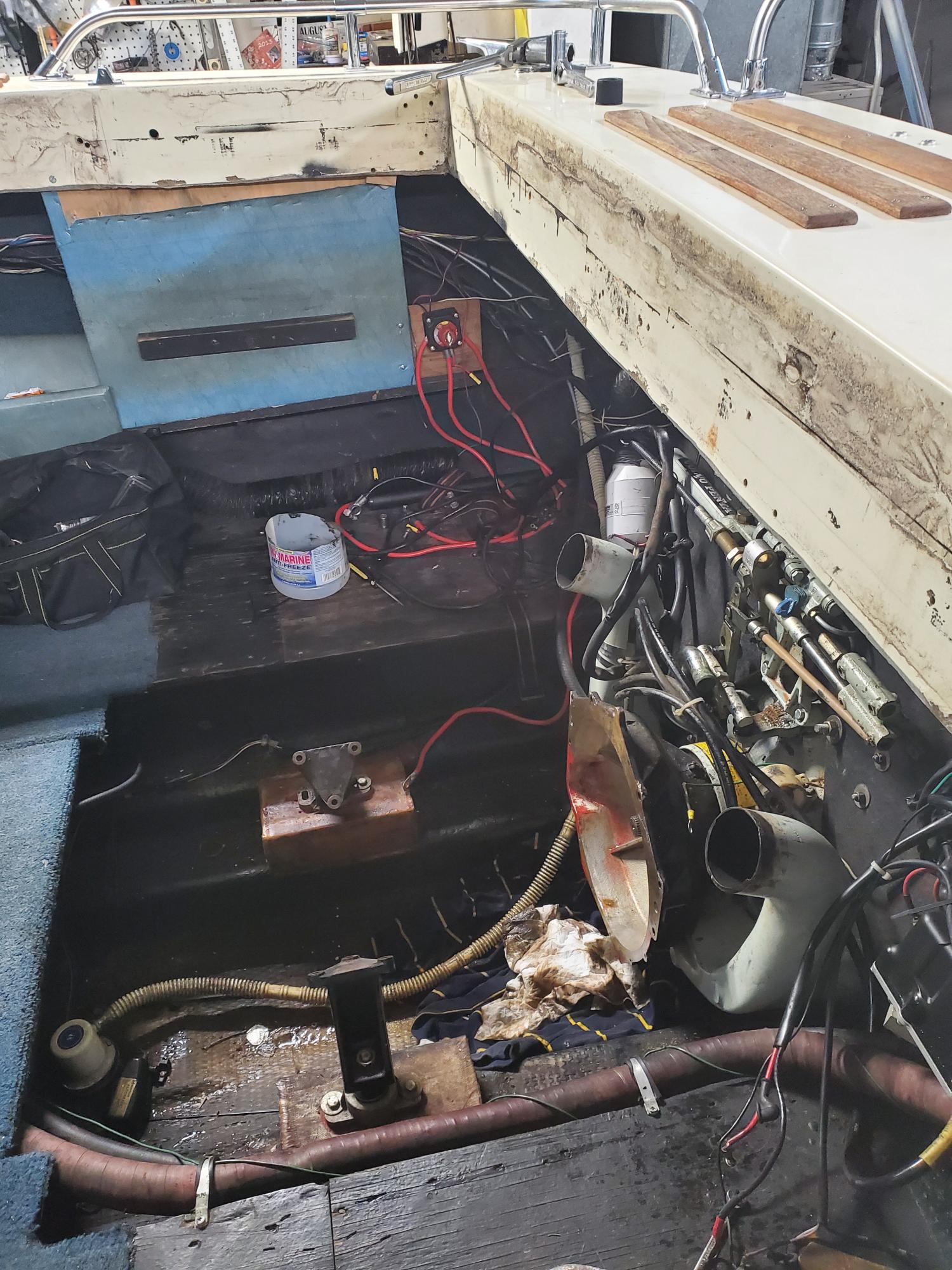

Found a friend of a friend with a rolling hoist in a shop. Got the engine out, PDS replaced per instructions, and got everything back in. Greased before placing the forward seal, and I glued that seal in. The previous seal had blown out and was hanging over the PDS, the aft PDS bearing was not receiving grease, and before I disassembled everything, the bearings sounded awful. I'm very pleased with the results and tackling this job. I suspect this will eliminate much of the droning I was feeling through the hull.
I will be reviewing the triangulation procedure once I have more time, I'll have to loosen up the tap bolts a bit I think. I was unable to remove the lag bolts from the stringers, I suspect they are corroded or might have been glued in for some reason. We sheared off the head of one of them, and stopped. There was enough room in the engine mount bases to predrill the stringer block, and run a new lag bolt. Stringers are dry as a bone, which was great to see for a 40 year old boat.
I didn't move the mounts to the stringers because of our frozen lag bolts, and marked them with a paint pen for position, but I suspect since we had to remove the bolts that held the engine mounts to the block, the alignment is going to be off a bit. The locating pins on the flywheel cover made placing the engine back into position a 10 minute ordeal.
Here are a couple pics!
Update!
The FWD seal installs first, and yes, it will be either glued or staked in place..... or both.
You want to add the grease while spinning the PDS, before installing the AFT seal.
Please note that the AFT seal installs in the non-conventional direction (lip and tension spring visible).
Yep.... I've seen that many times.
Yes, and you will have prevented eventual and catastrophic and expensive damage.
Yes, good to hear that!
If the front elevation of the engine has not changed, you might be OK as is.
You can still check the alignment by taking the triangulation measurements. The main objective is making sure that the rubber cushions are able to do their jobs.
