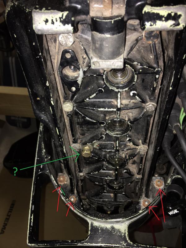

Has anyone changed the head gasket on a motor like this? The bottom bolts are hard to reach, do I remove the engine mount (marked with red arrows) in order to access them or do I have lift the entire powerhead out? Also what is the bolt next to cyl 3 indicated by the green arrow?

There is no cylinder head gasket on that motor.----There is a water jacket cover gasket.-----The " bolt " is a pipe plug for a place the get pressure to a gauge.-----You can pull it over with a rope.

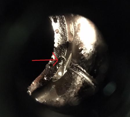

Ok so I got the coil pack off, had to pry a little, think it was glued to the intake cover. With the intake cover cone I could see the side of the pistons and on no 3 there was damage. In the intake channel I found 3 pieces of wire approx 2 mm in diameter (dont know where those came from??), another of those pieces were jammed into the top of the piston as can be seen from the image taken from the inlet port. Its not easy boroscoping the cylinder from the spark plug hole with a iPhone 6s in one hand taking pictures and a flashlight in the other shining through the inlet port :) but I got an image - I dont know how clear it is - of the piston viewed from the top where the wire piece is visible (red arrow) and unfortunally theres a scrath mark in the cylinder wall that seems to go all the way down to the port :( So i guess that explains the lack of compression. I dont se any other solution to this than boring out the cylinder and installing a oversize piston which for me is beyond reasonable repairs for this motor. So i guess thats thats but I want to thank everyone especially you racerone who contributed to my efforts in getting to the bottom of this.

My guess is that those " wires " are the wristpin needles.-------Take this motor apart.----You will learn a lot about simple , precision machinery.
The bearing between piston/crankshaft? Yes probably. Actually its gone now went to a new home, some guys bought it for parts hopefully it will come to good use. Sure I could have learned from it but that would have been it I wouldnt have got it running again
