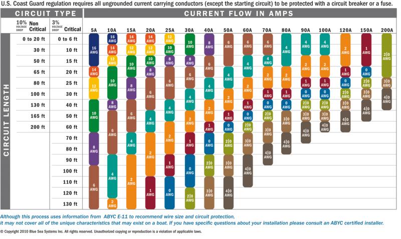

Attached is a really good guide that complies with all USCG requirements.
Thanks Chawk. That is a great guide and I do have that chart saved on my phone for quick reference as well. I guess at this point does anyone know how many amps the Bf225 draws on startup? From what I’ve read on the hull truth and few other forums 1 AWG should be more than sufficient. I source all my wire thru Greg’s marine wire and they rate their 1AWG at 245 Amps. Even factoring in the distance of run this should be sufficient.
