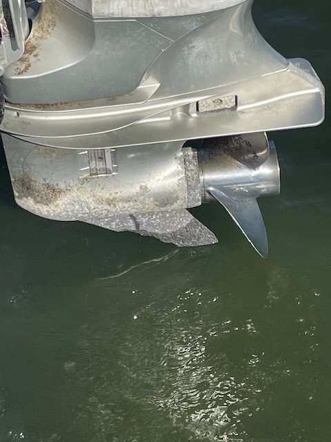

New to Forum. Just purchased a 2005 Honda 225 (350 hrs) on pontoon boat and used only in a freshwater lake, South Texas. Lower unit is severely corroded, skeg (leading edge) is 20% eaten away. Body housing below cavitation plate pitted. No Leaks (yet). Appears lower unit below Cavitation plate rested in water and anodes were not in water. Plan to replace lower unit in couple of months. Desire Forum's thoughts concerning corrosion on / inside block or where? No water intrusion in engine oil. Just got this rig at decent price (scares me) and have not dived into exhaust / water jackets etc. Thanks in advance...

Anodes on lower unit in good shape. Appears the area below cavitation plate was submerged in freshwater lake. Unit never in salt water. I was not able to get to lower unit to get depth reading of pitting.

Those anodes could be toast, I weigh mine to compare old and new.

Was this boat spending time on a dock plugged in to shore power? I’ve not seen a lower unit pitted like that and I’m a salt water only guy.
That looks like damage from hitting rocks and gravel- unless the casting is very inconsistent, it shouldn't erode that much in any single area.
Do a continuity test from each part to the battery- if you don't see low DC resistance, your continuity wires may not be intact and the bolts/mating surfaces for the anodes in place may be corroded.
Is this brackish water, or inland? Those anodes don't look good- most have an even appearance and those are very crusty. YOU may not leave it in the water, but it seems that the previous owner did- even the stainless prop has stuff on it that shouldn't be there. Where was this used before you bought it?
