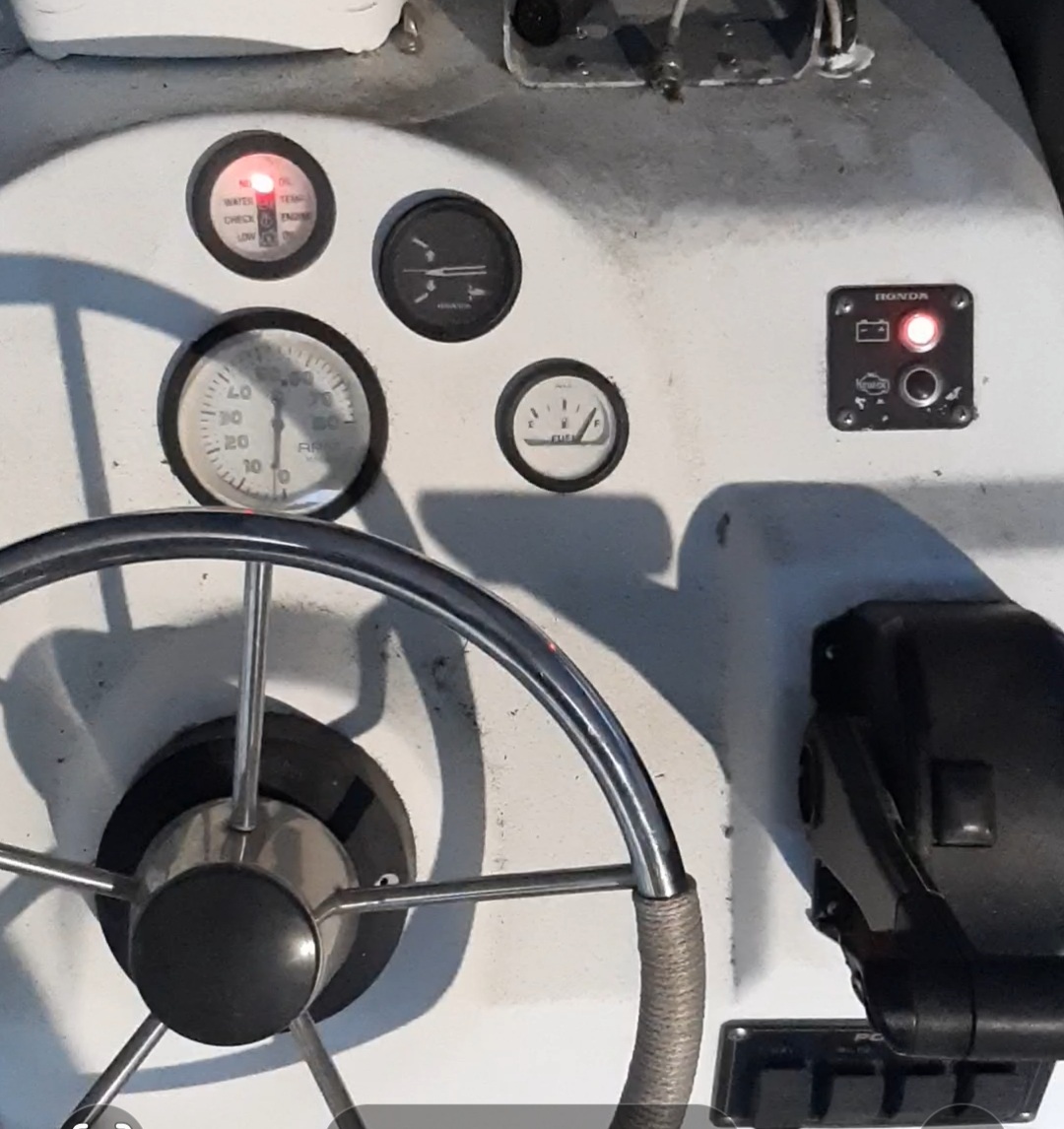

I have a 2000 BF115A and the "no oil" light remains lit until the motor starts and is running.
Pic with key on, before cranking. All lights go out when engine starts.
I don't even know if that "gauge" is Honda or not...

Ok, I located a pdf.shop manual with wiring diagram for a 115A but I'm not sure what years it applies to.
One of your 30 amp fuses feeds the White/red wire going to the main relay to power the fuel pump. BUT it shows the W/r wire turns into the White/black wire after a splice before going to the main relay 8 pin connector. Check that there is 12 volts at the W/r wire and also at the W/b wire in the 8 pin main relay connector.
The diagram shows the 30 amp fuse is wired directly to the starter motor battery positive stud so the fuse should be hot at all times.

My 1999 130 which very similar to your 115, when you turn the key on, it beeps and the oil light and gen light by the key switch come on, but the oil light goes off before it starts.
There is a table on page 18-9 for "operation" section of the shop manual that explains the warning buzzer and lamps at engine start.
Hooefully the link I sent you worked.
Mine stays on. I think it might be a built in safety feature to not allow the engine to run if it thinks there is no oil.
