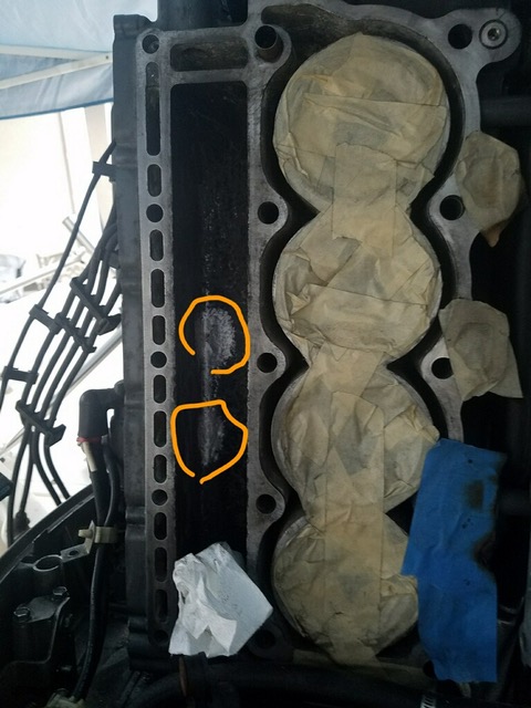

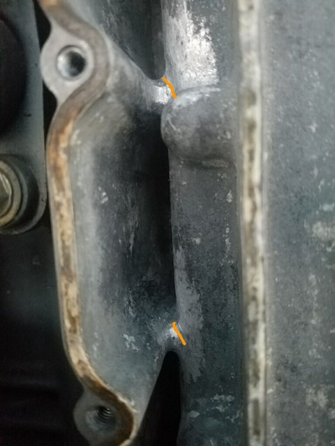

BF130 case crack locations on my motor
92wahoo
Photos of Cracks that go from the exhaust chamber through to the webbing in the center section of the water jacket that I had welded up. Thought I would share just in case anyone with a BF130 wanted to pull water jacket cover to investigate. Be prepared to tap & helicoil any water jacket cover bolts that break off!
