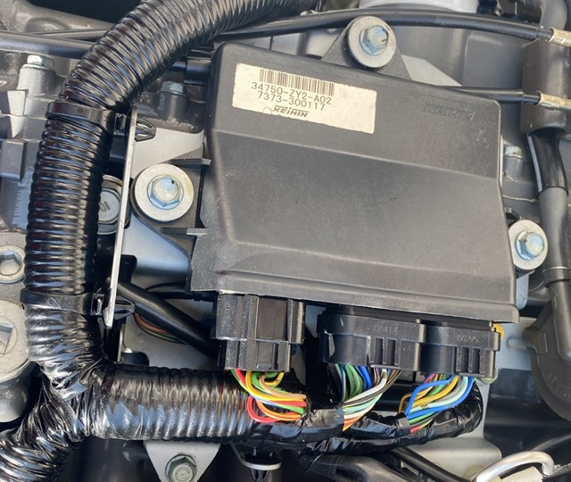

Ok so there doesn’t seem to be an adapter and I got all the model numbers for engine and ECU that’s installed. Not sure the part used for new sensor but as I said no adapter and I can ask for sure.
(See pictures)

The engineer there said the engine is running fine but the ECU is only requesting a check/sending signal each 3 minutes to the HO2 sensor not every 2-3 seconds as it should. So they tell me the ECU is shot and that Honda Greece said they stopped making them 2 years ago and can’t supply.
I saw 1-2 new or used -A04 versions mentioned in the bulletin available online but they said this might not be compatible with EU version/emissions or fix it.

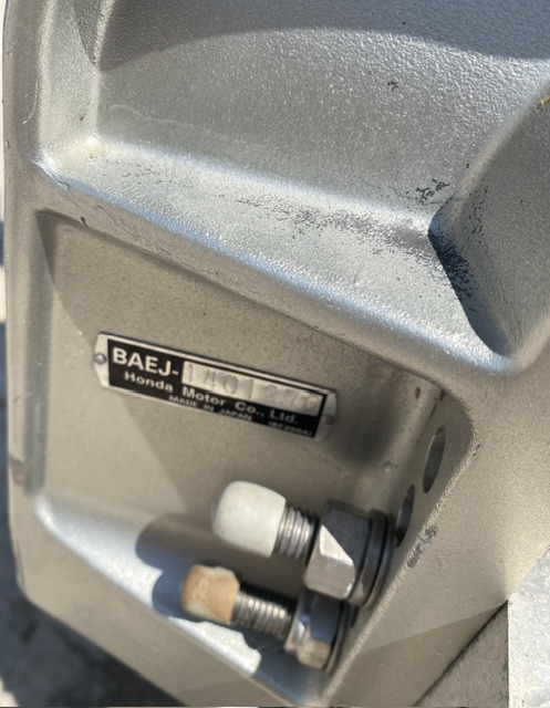

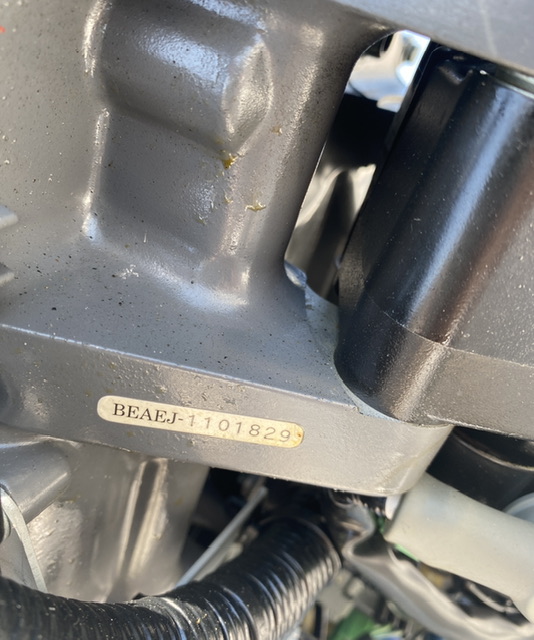

P.s. the tag on outside and Dr.H say it’s BAEJ14….. but a sticker on the engine Dundee cover says BEAEJ11….. seems odd
The BEAEJ is the frame number, not the engine's SN, which is 1401270, which makes it an A6 model, per SB #70. So, your repair shop should have replaced that HO2 sensor with the new part number and ECU listed on page 7 of the service bulletin. HOWEVER, this SB may not apply to European models, I don't know one way or the other.

Apparently it’s almost identical with HO2 sensor heating up fine and everything running perfect but the ECM isn’t sending any check signals out until around 3 minutes later and then every 3mins rather than continuously until after 3,000Rpm (then the checks stop apparently).
Recommendation is now ECM (if I can get one of the A02’s somehow).

After much escalation to Honda Marine Europe and messing about they finally confirmed in writing that SB70 applies and the newer -325 kit can be ordered (I’ll omit the pricing chaos but we got there). So now we wait for the kit and hope it arrives before Greece shuts for August.

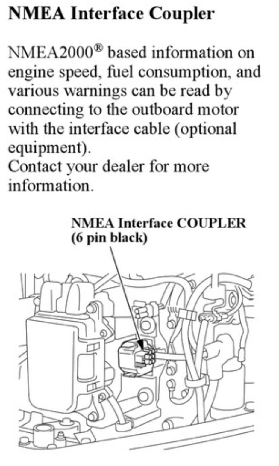

I have one new side question… with the later ECU model is it possible to now connect to NMEA/get engine data on my MFD/GPS? The 2006/7 model didn’t have that but I’m hoping the post 2010 ECU might enable it as a side benefit? Or maybe not?
Starting with the 2010 models, Honda does interface with NMEA 2000 protocols, at least in the US. Not sure for the EU models. And I don't know how the interface plugs up.

I guess I am hoping that upgrading to a 34750-ZY2-A04 ECU makes it a post 2010 model and NMEA compatible. I wonder who would know? Any idea when the A04 ecu started being produced?
There is a Honda specific cable that plugs into one interface on engine look and outputs to NMEA from my previous research (went cold after I saw only on later models and my 2006/7 model was a no go).
Somewhere, there needs to be a native program that translates the Honda proprietary signals from the ECU to the NMEA 2000 recognized signals. Whether or not that is native to the upgraded CPU, I don't know. You ought to discuss that with your dealer, if trustworthy.
I purchased two NMEA cables for my Garmin Echomap 92SV Plus and twin BF200´s. Only issue was the instance number change on one of the engines as both had the same instance number. Did that with Dr. H. God knows why they don´t use different instance numbers for counter-rotating engines. Connected the engines to NMEA 2000 multiconnector, setup the Garmin and worked like a charm. Even have the "ECO" indication.
