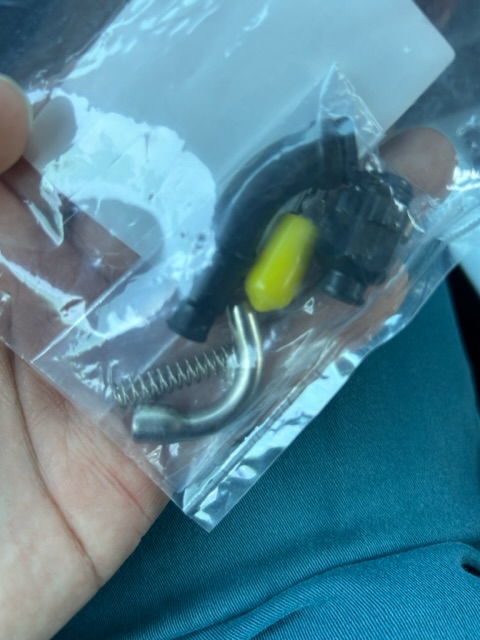

Ok, so this is what arrived. Which of these pieces do I need to replace? And which part has the pre-installed cable?
Oh man! I am so SORRY!
As soon as I opened this and saw the picture, I just wanted to go hide somewhere!
Clearly I was wrong about the cable coming pre assembled with the guide and boot.
It used to I know because I've ordered several in the past but that's obviously changed.
I think you're only left with the option of buying a new cable or using your old one to install in that guide assembly. I couldn't find another part number for the whole assembly so I don't think it's available anymore.
I know it's a pain but I wouldn't try using the old cable with those new parts.
My sincere apologies for steering you wrong and wasting your time.
It seems that I've simply become of date.
Yes, it's not worth taking the chance of using your old cable with the new guide and boot parts because, if that cable is stretched or fatigued in any way, the whole affair will be unusable and you will need to start completely over.
I say that because it's no picnic mating the cable and those "valve set" parts together. That valve set rubber boot is critical to tthe way that set up works and it's very likely that the boot wouldn't fair well if assembled then disassembled and reassembled again.
Very sorry my mistake put your project so far back.
