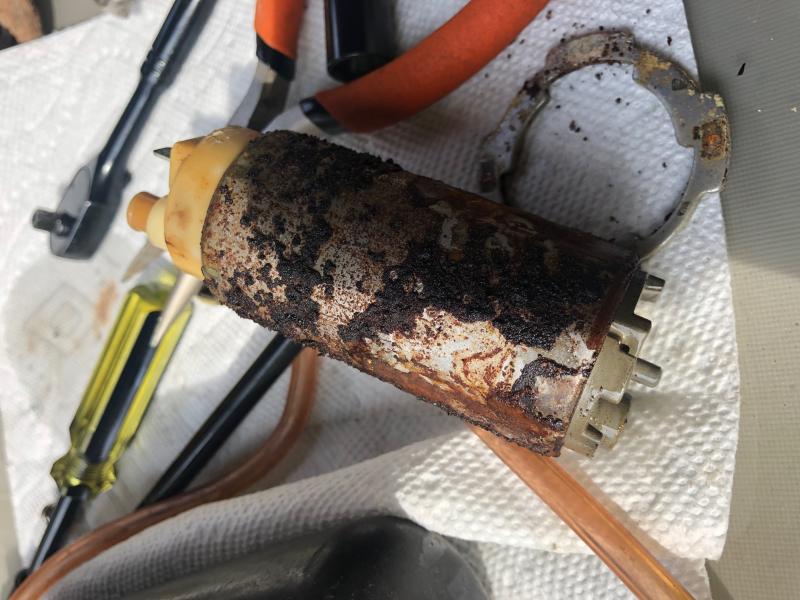

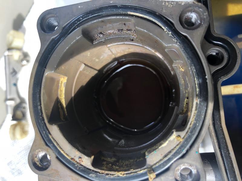

Removed everything to make it to the VST (again) and this time I extracted the fuel pump to get to the insulator and the screen.
To my surprise, everything was stuck in a lot of rusty sediments. See picturea below
Remember that the previous owner was running the engine with no low pressure fuel filter and when I got it, the high pressure filter was crushed by pressure
so now after cleaning everything, I orders the pump insulator and I think I’ll order a brand new pump also. Engine is 2003 and I don’t feel like going back to the VST a 3rd time
what do you think ?

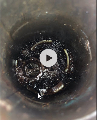

Thans Chawk-man,
the pictues didnt load up from my iphone. Here are the picture.
Picture #1 :High pressure fuel filter I changed first time i got the engine on On June 15 2019.Engine had only 335 hours but had been sitting for a couple of years.
Picture #2-4 :picture of the fuel pump that i took out of the VST yesterday night.
Should I look at the other filters (like the one on the fuel rail) and should i be worry about the injectors ?
I was taking of doing the injectors cleaning/replacement this winter since the boat was running other than the fuel starvation.
Currently waiting 4 days for the parts to arrive from boats.net since my local Honda Marine Dealer had nothing on stock here in Montreal Canada
No pictures. But sediment in the fuel pump bowl is the likely culprit. If so, there are other screens and filters that could have been affected. See the attached for a list of all the filters and fuel screens on this engine.

Well, I think you might hope that that HP filter did it's job, even though it is in a sorry state. So clean out everything meticulously, put it back together and see if that cures the problem. If not, go back to my post #6 and start from there. You may need to get to the injector filter and injectors, but recommend that you take one step at a time.
Once you get it back together and running, check your fuel pressure. There is a fuel pressure relief bolt on top of the cover to the HP fuel filter. Remove that and install your fuel pressure gauge there. It's 6 mm, so you may need an adapter. At idle, fuel pressure should be between 41 & 48 psi. And when you remove the vacuum tube from the fuel pressure regulator and block it, fuel pressure should jump up a few psi. If fuel pressure is too high, then you may need to attack those downstream filters and screens.

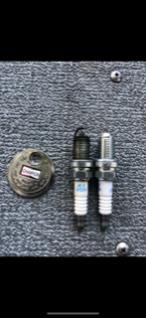

My bad, every time i try to upload pictures from my iPhone it doesn't work,
here is the pictures from my computer
To answer your questions :
1. Yes the boat was fulled with 292 liters of premium gas 94 octanes (no ethanol). Thats a full full tank
2. before toping gas, my local local mechanic (that doesn't know too much about hondas, mainly does mercury) add injector cleaner to treat 250 Liters of gas in the tank. We then put 292 liters of fresh gas without running the engine and left for our fishing camp. Run the boat for 240 km(150 miles) so i probably burned 134 Liters of fresh fuel.
3. I havent pull codes yet, but when i bought the boat in May 2019, I brought it to the Honda dealer who connected the computer to it and told me that the engine had 350 hours on it and that the only code was the Intake Air Temperature. He didn't had the part on hand so we didn't change it back then :-( Now, i recall this and maybe i should have order that with all the other parts i changed in the VST and the high pressure pump :-(
4. For pulling the code, can i use a car OBD2 reader on a marine honda engine ? Wouldn't mind investing a bit of money on a machine like that since the boat that i bought doesn't have the lights near the key anymore. Remember, i bought that boat/engine from a guy that had a project to put them back together but he never did. Lots of stuff were not done properly on this rig.
5. Plugs were all changed at the same time as i changed the high pressure pump (2 weeks ago) and yes i used the NGK IZFR6F11
See picture from when i removed the plugs 2 weeks ago.
6. I'll check the plugs again later today.

That first picture looks like an oil leak coming out of the bottom of the upper cowling. Pull the upper cowling and see if you can see where it is coming from.
Looking at the plugs in the second picture, it looks like you are running too rich. When you pull codes, if you get a code "1" that is likely a failed HO2 sensor, although a bad coil, a bad plug, or fuel pressure out of spec can also throw a code "1".
