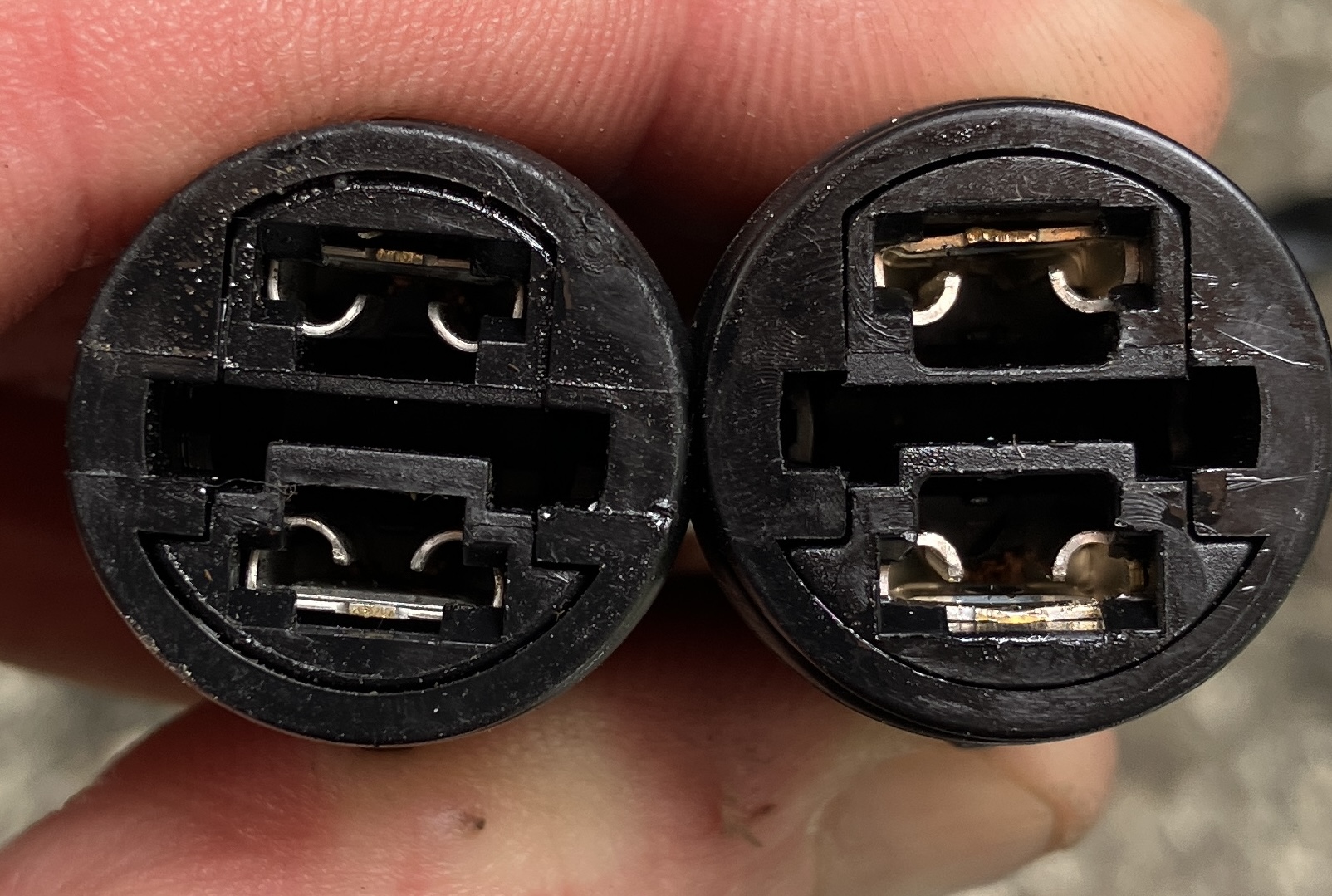

Only other observation is at first felt like the new Honda style plug from AP didn’t fit but turned out the spade lugs were very close together so needed opening a hair.
Honda left. AP right.

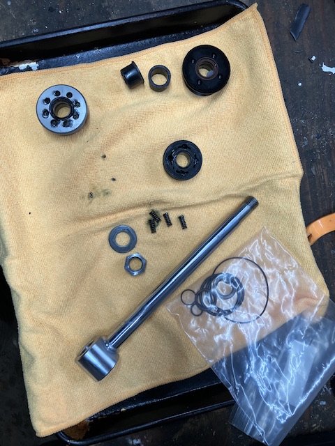

Also worth a mention that when you dismantle tilt ram to put new cap on - use great care undoing the 24mm nut. springs and tiny bearings in there to look out for.
Black cap is the new one from 5 star marine.

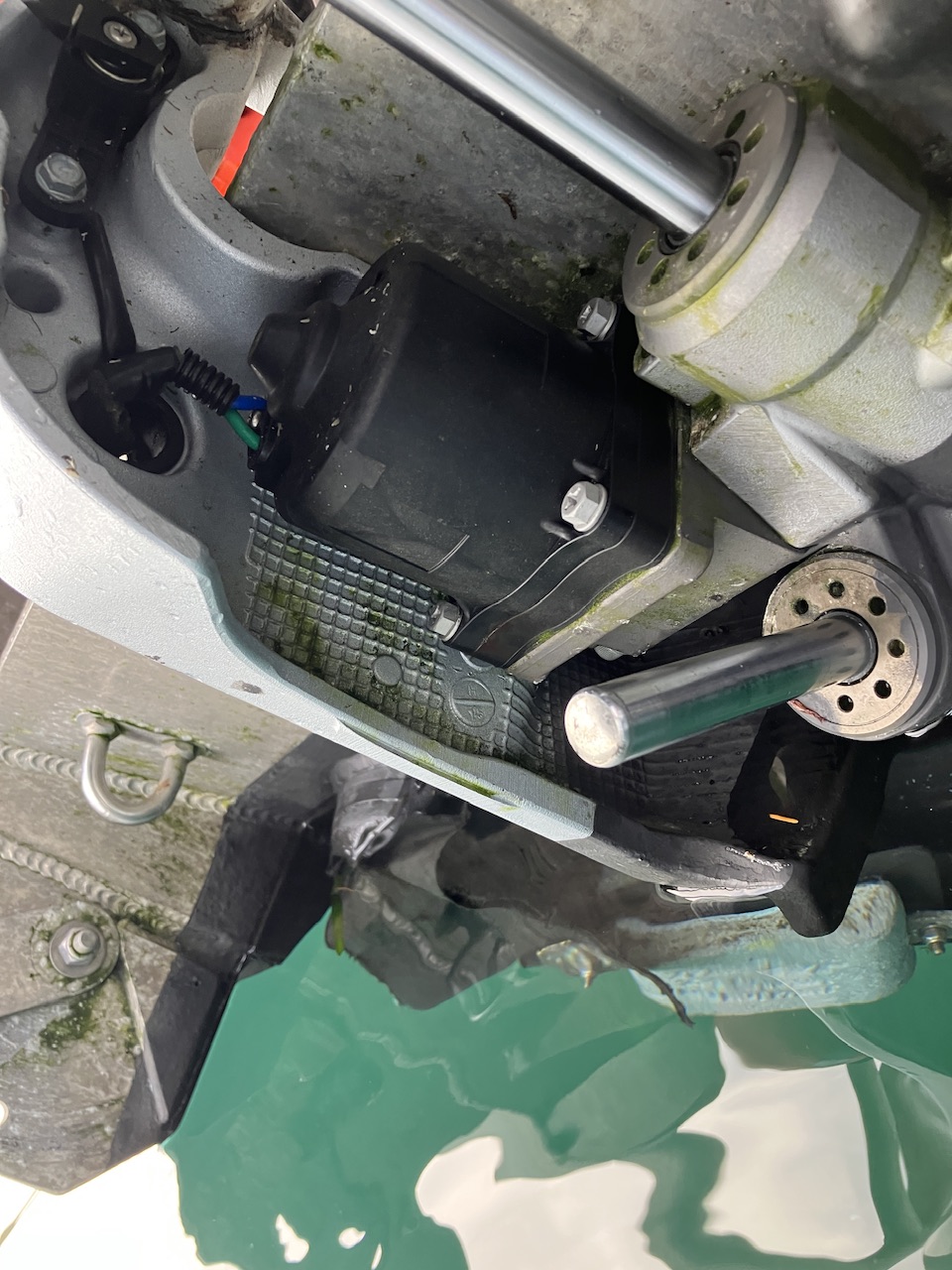

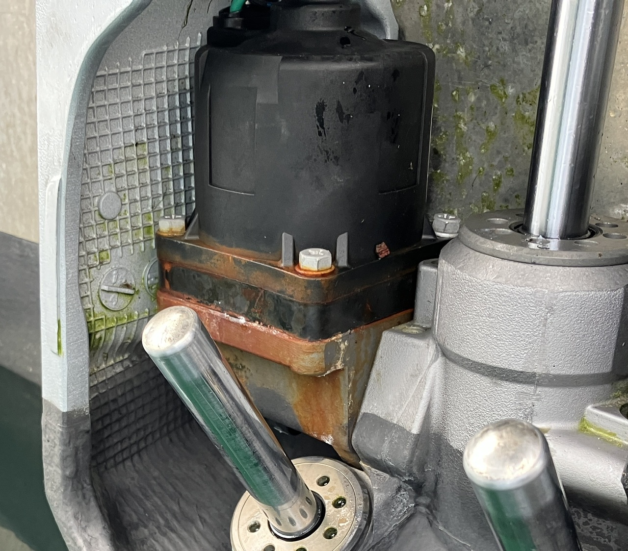

Six months in and my AP motor is showing some weird rust / brown stains at the base.
OEM motor on port engine photo for comparison.
Weird. I used the old mounting hardware if I recall - so not sure where the stains are coming from …

Looks to me as if they used carbon steel to stamp out the motor housing case. Might just be more of a nuisance for you than anything else. You'll probably need to keep wiping it down as NSDON suggests. I wouldn't worry too much about it as long as it works ok.
There's a reason they are less expensive than Honda.

Maybe the 4 motor casing crush tubes aren't s/steel?
i bet that is it! i did put a decent amount or pure-silicone caulk on the wire-entry per @jgmo comment at the time i was doing it, so would be surprised if there is egress inside the housing. looking at the rust right under that bolt-head though - the crush tubes would make a ton of sense...

Update: where there is smoke there is fire. Or rather, where there is rust there is impending doom. ;)
API tilt-motor gave up the ghost today. For the the last week, it's started flaking on me - first started with failing to lift once - with just spinning motor noise - then trim has been delayed for a bit compared to other engine, to the point it just stopped working. I hear the relay click - but motor does not engage at all. I assume the rust is a symptom of water ingress at this point - so will have to pull the boat and investigate and probably go with OEM motor next time. Live and learn...

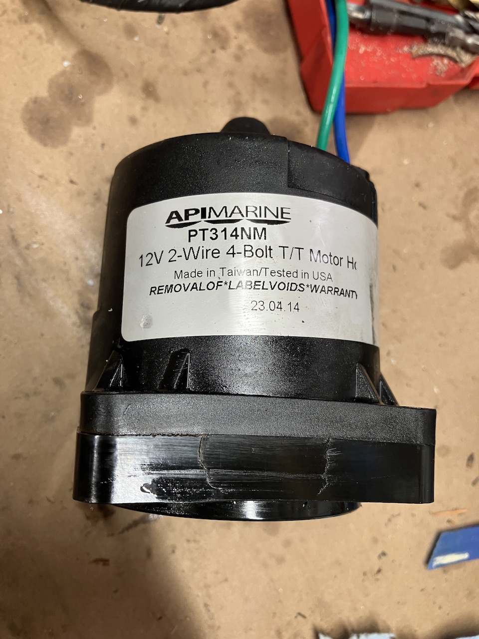

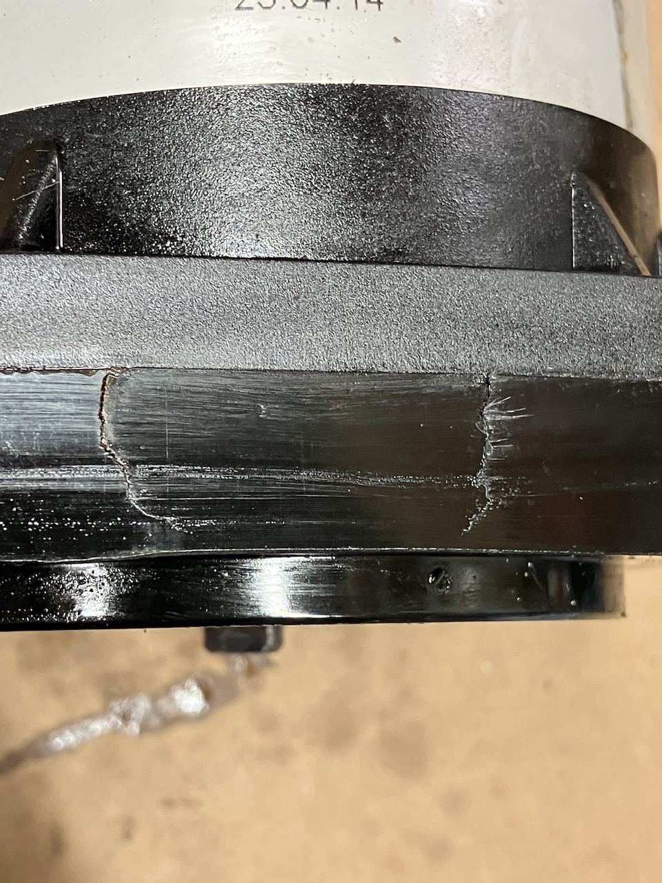

Api motor cracked lower housing on all 4 sides. Bolts were torqued to Honda spec of 4.9NM / 43 inch-pounds.
Comparing with OEM motor only thing I can think of is that API included a fatter diameter oring than OEM one and maybe that impacted things? Or defective?
Well, the fatter (how much?) Oring could very well have been a factor. It does look as if the housing was in a bind via the mount flange..I actually thought "over torqued" when I first saw the photo before reading your comment about how you tightened it down.
Either oring was wrongly included by a factory worker...it happens...
...OR it was a change API made to seat THEIR housing.
You have no way of finding out except to ask them really.
If they are going to warranty it for you, they may be interested in getting it back to do a failure analysis.

a fair amount thicker. i would guess 1.5x - 2x, I had to double-check the Honda part # as it seemed so thin compared to the API one.
Yeah, that's quite a bit and might certainly be enough to set up the stress it takes to crack that plastic/nylon house. It would be a shame if that's what it was that caused you all this trouble.

Just an update that API deemed the motor faulty and replaced under warranty. The included Oring still looks way too fat to me...

You may very well be right about the oring being "incompatible" with the Honda trim unit.
I'm sure those API motors are intended for other trim units and they might not have gotten the Honda fitment "perfect" in this particular case.
