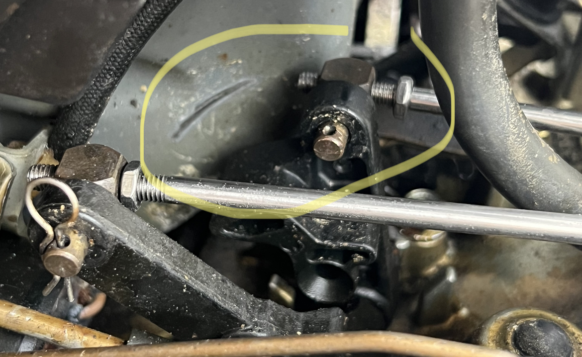

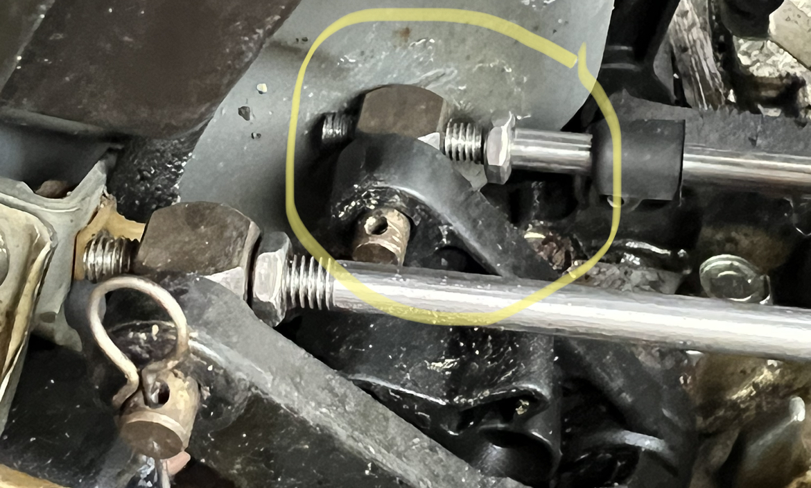

Secondly, it’s hard to pull the lever into reverse and just found that the shift rod is binding against the engine where the cable connects at the front of motor. Is my shift cable hooked up on the wrong side? It looks like i could pull the connection off and insert it on the outside of mechanism. Maybe a previous mechanic put it on backwards or something. I can’t even find a picture on what it’s supposed to look like. Thanks for reading :)

Ok looks like it is on backwards from the manual. So just need to figure out the shaking motor. It’s not struggling to run IMO. I want to mention in addition to doing the water pump i also put an OEM flywheel brand new on the boat. The magnets were delaminating and making a tapping noise. I did timing correctly and pretty sure everything is seated well. Was just thinking what could contribute to shaking
Noah,
The picture makes it obvious something is not right with that cable head hitting like that.
By all means I think you should try flipping it around and seeing if it works.

Thanks for the response…the manual shows that cable elbow the other direction with the pin on the inside so i will switch that.

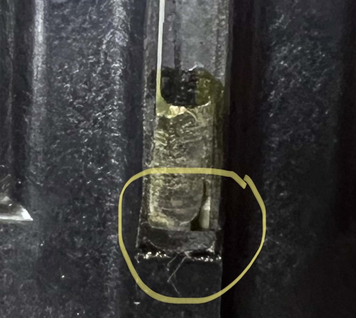

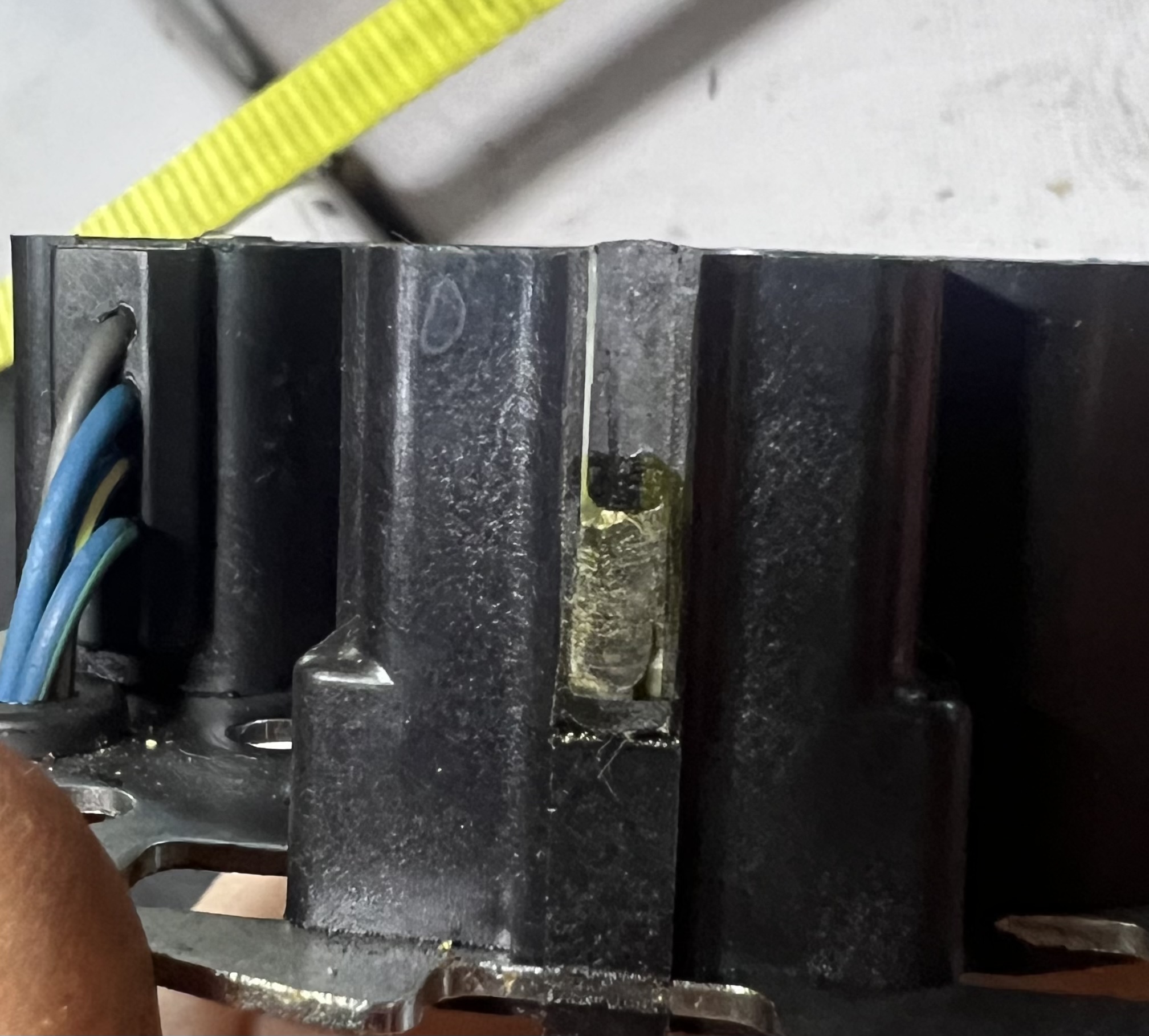

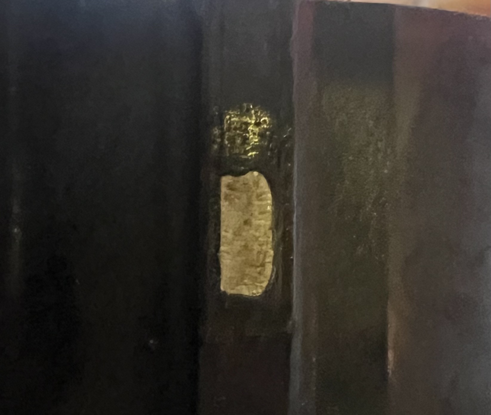

i think so we tried to look at the spark multiple times here was the old pulser compared to the new one. You can see the cracking and entrance for moisture and heat

i feel like there is no way the carbs could be fouled i really cleaned them severely and they weren’t even dirty. My dad agrees we looked hard and did not see a spark. I realize now how faint the spark is but i can see it now in the gap and arcing onto the motor. I guess will see
