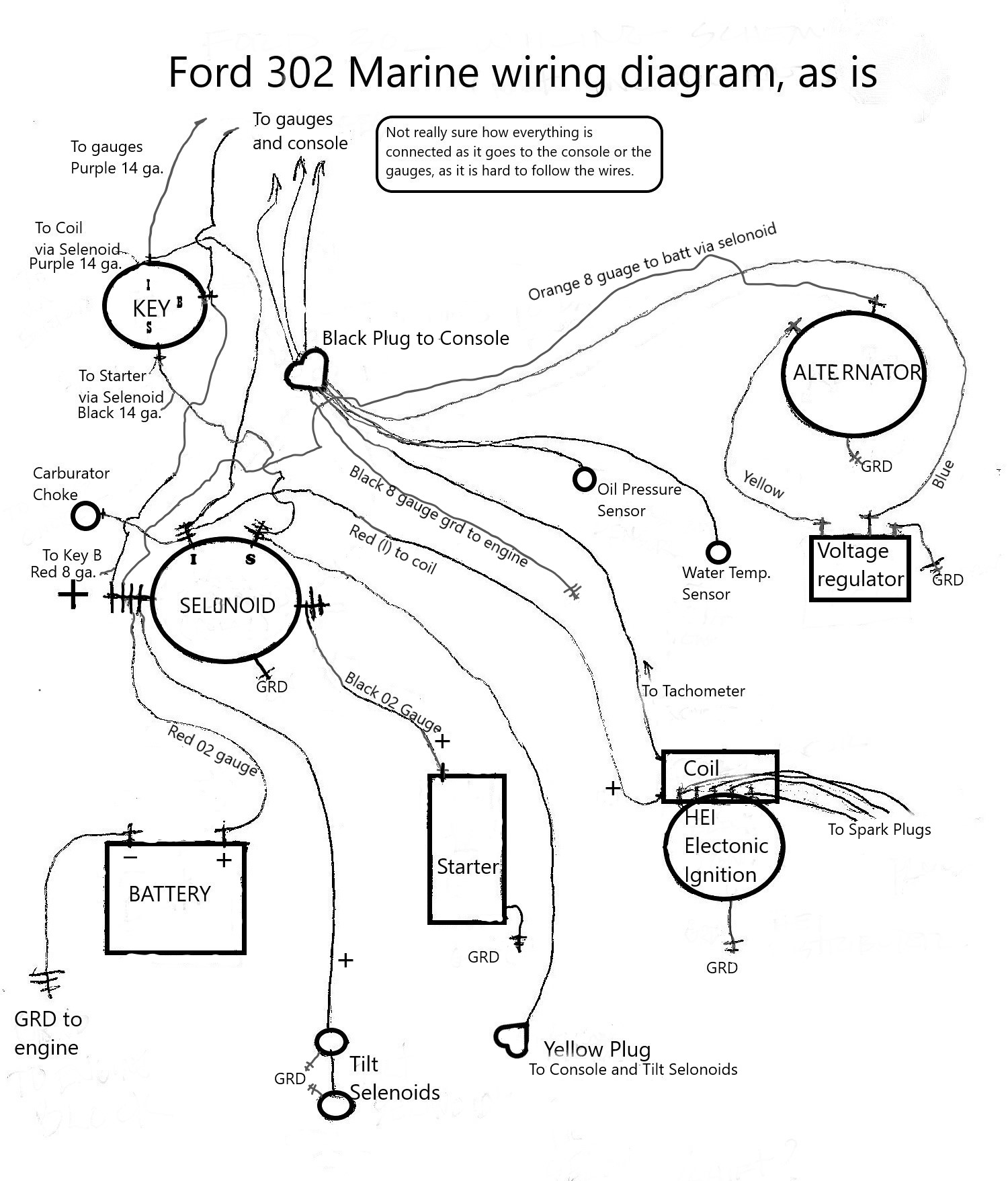

Blew another seloniod on 1976 Ford 302
Neal Franson
I did some exploratory and found that the black 8 gauge wire attached to the starter side of the selonoid is the negative ground to the gauges, and the red 8 gauge wire on the battery side powers up the key switch (B) and the gauges. Still not sure where the wire from the (S) terminal goes, except to the yellow plug which looks like it goes to the console, but it didn't seem to make any difference when I disconnected it, so I hooked it back up.
I didn't find any fryed wires anywhere, but did clean up a few connections. It still was a slow crank and only about 10 seconds of crank at all, the last time it was cranking.
I went to start it today and nothing except a single click from the selonoid. So I will have to get selonoid #5 just to get it to turn over.
Any ideas, let me know.
The wiring is old, and when I cut the wires back to put on a new connection, they seem somewhat dark and corroded. I am wondering if I should just re-wire the whole thing, maybe get new gauges (although they seem to work fine)? All the high amp wiring through the selonoid is new, clean and huge from the battery to the starter (02gauge).
I stands for ignition and S stands for starter on marked solenoids. The S post on the solenoid is coming from the key and is what activates the solenoid. If you touch a wire between the S post and the battery side post the solenoid will activate. You can also buy a solenoid with a button to activate when in the engineroom. The only reason I can see for a new solenoid to fail is either the wrong voltage or a bad connection. When searching for a bad connection, remember to check the ground, too, all the way back to the battery neg post.

Thanks for your reply. I do have a remote switch to jump the + and the (S). As far as wrong voltage or bad connection, do you see anything on my schematic around the selonoid that looks suspicious? Any wrong connection?
Your BLACK 8GA wire coming from the Gauges should go to the engine block and NOT the Starter. Depending upon what else is going on at the console, this change yield a substantial improvement...
Don't know what is at the console that requires a BATT connection, but I would be inclined to supply a separate (protected) lead for those loads.
I would also suggest that the ALTERNATOR output (ORG 8GA) go to the starter solenoid's Battery connection (or battery itself)....There is no reason to try to move that much current thru the key switch.
Verifying the ground wires are in good shape, as Lepke suggested, would also be a good net step....I would also suggest getting the battery load tested to make sure its delivers adequate current.
Probably a good idea to pull the spark plugs and make sure the engine will turn over easily (by hand)...if the internals are damaged, the slow crank may not be unexpected...
If the slow crank continues, I would suggest making voltage drop measurements to find the culprit(s). Typically you can also use an IR gun on the starter circuit connections....high current draws thru bad electrical connections = Lots of Heat....
and the 'yellow plug' may go back to the shift control and be part of the neutral safety switch wiring...that appears to have been bypassed based on your diagram...
finally, excess current typically kills solenoids by eroding their contacts prematurely...the only thing I see is that 8Ga black wire tied to the starter's lead on the solenoid...you can do a quick check by measuring the battery voltage (fully charged should show 12.8VDC or better) and then checking the voltage between the negative post on the battery and the solenoid lead feeding the starter while cranking....if it drops below 10VDC, that suggests excessive current draw....

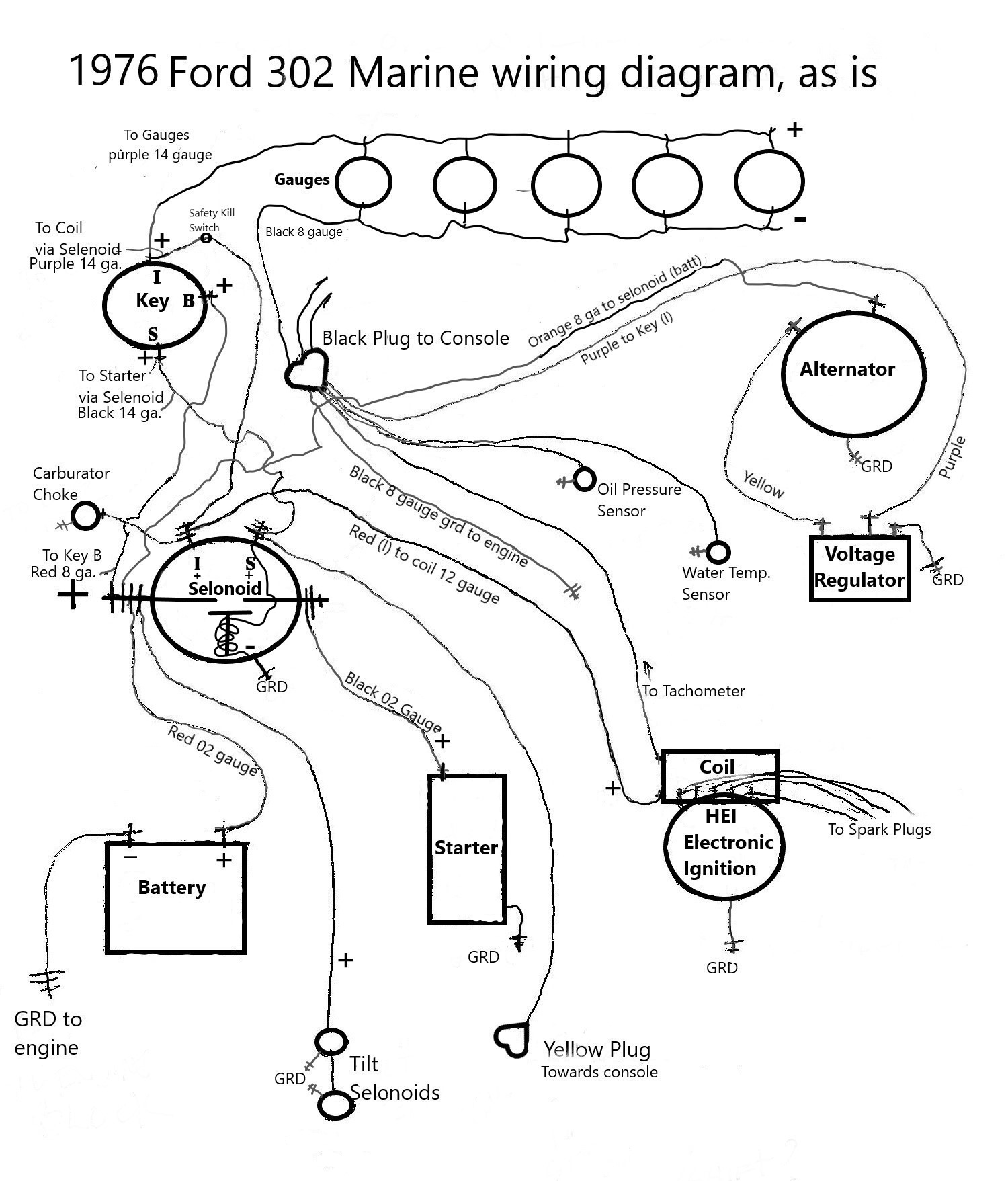

I am waiting for the new selonoid from Amazon, but made the changes to the wiring with the black and orange 8 gauge wires and also updated the schematic:
Dang! Still slow crank and only 15 seconds of crank time. Mark, I thought you really had it wired! All of your recomendations aligned with what I suspected.
Asside from re-routing the black and orange 8 gauge wires, I also re-routed the other accessories the were hooked up to the batt terminal on the key switch and also disconnected the ancient fuse block that was also attached to the gauges, so there is little left that would cause a drain of current that I caan see.
I guess I will re-do the load tests for slow crank and see if I can make any sense out of it with the new schematic.

Here is the updated schematic:
schematic.
I wouldn't worry about a compression test until the starter will spin the engine at a 'normal rate'....Doing a spin check with the plugs out would let you know the engine isn't dragging (mechanically)....since you mentioned 'newly rebuilt' - have you primed the oil system? checking the initial timing would also eliminate another 'rebuild variable'.
If I were doing the detective work, I'd check the starter draw (as is) ... If you don't have a high current amp meter, next best thing would be a voltage drop test done along the current path for the starter...do each component between the connections and start with the ground lead to the block...given the age of the engine, the wiring may be degraded - looks fine on the outside but corroded on the inside. A qualitative alternative is to run an IR gun along the path (while cranking) looking for a hot spot...
Did you mean the new high current cables are 2/0 AWG in size or just 2 AWG - I've never seen "02" used to quantify wire size...??? Are they made of Marine Grade cable?
