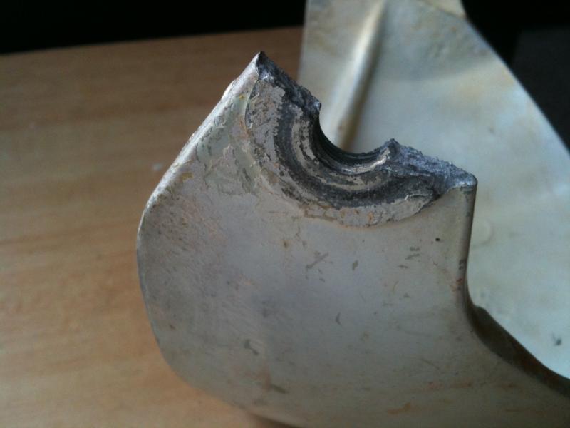

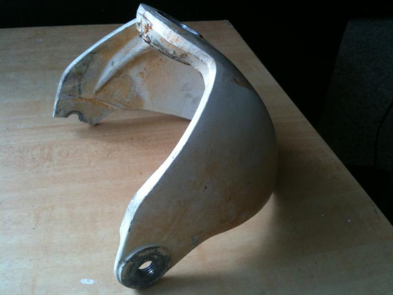

This is the third time that I've snapped a steering helmet. WTF is going on here. I've looked on ebay for replacements and the two I've found don't look like the one I just snapped. To make it worse, I can't even read the part number on it. I'm hoping one of the senior members here can help me find a replacement. I have the one with the larger diameter shoulder screws. According to wellcraft, my drive is a DP-C1. The drive serial number is 3102147931. However, when I've taken it in to dealers they say it has been modified and its a 290. I've included some pics to see if you can help me find the right helmet.

If I were desperate to get back on the water, I would be visiting a machine shop to get it repaired.
Good luck
Rob
I am desperate, 4th of July weekend is coming up. However, taking it to a machine shop will not be impossible because the missing piece is in the lake somewhere.
Volvo Penta's high grade aluminum components are typically TIG weld repairable, but not so when we see corrosion like what appears to be the case with this helmet.
It must be absolutely clean in order to TIG it.
With the presence of what looks like visible corrosion, this is a non-TIG weld repairable item.
This Helmet is also no longer available via Volvo Penta as a separate item! (must be purchased as an assembly $$$$$)
If you find a good used one that uses the large shoulder pins......., grab it!

This one happened to snap when I beached the boat. I heard the pop and knew it had to be the helmet. It was a bit windy and maybe I had the drive turned to the side more than I should have when it was beached and it may have put more pressure than the helmet could take.
I did search through my older posts (thanks marineengine.com) and found some corresponding part numbers to the steering helmet:
852864

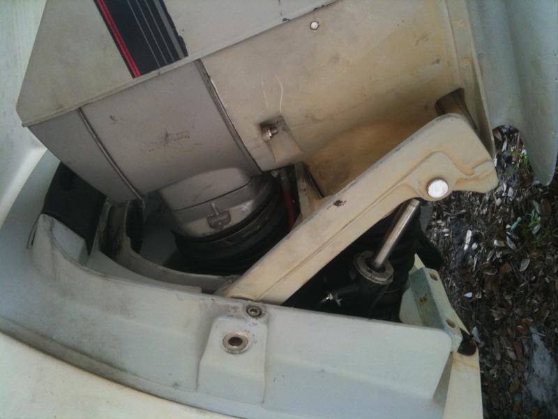

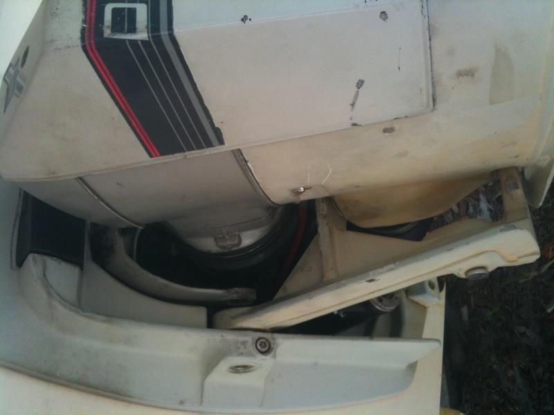

I am interested in distinguishing the drive I have whether it's a 290, DP-C, or DP-C1. The boat is on the trailer and I can take pics of the drive and its connecting components quite easily, if needed.
It does have power steering and the trim fin is installed.
  1. I am interested in distinguishing the drive I have whether it's a 290, DP-C, or DP-C1.
  2. The boat is on the trailer and I can take pics of the drive and its connecting components quite easily, if needed.
  3. It does have power steering and the trim fin is installed.

Here are some pics, let me know if you'd like me to take closer of farther pics of different components.

  1. Are you adjusting this as per the OEM suggestion?
  2. Just to clarify, I did not say that there is no 290! There is indeed a 290/SP/DP drive that is within this model range. All of these use the: REV Latch, Anchorage Bracket, Small diameter hinge pins, mid-size angular contact bearings, etc.
However, once the REV Latch, Anchorage Bracket, Small diameter hinge pins, mid-size angular contact bearings have been eliminated, this is no longer a 290 style drive.
Note how your cylinders make a direct connection to the "main suspension" fork.
Note the diameter of the hinge pins.
Of course it can be fixed, and a good machine shop can. They would weld on a new piece and bore it out, possibly even make it stronger than the original.

1. To be honest, I don't think it was. I had it tightened in the 12 o'clock position. It is now as close to the 5 degree the manual states.
I definitely don't have the latch that the drive you posted does.
I measured the diameter of the pins that go through the steering for that attach the hydraulic rods and they are about 1/2 in.
I took a pic of the top tag on the drive and there does not appear to be anything stamped on it.
I would just like to know what type of drive I have so I can search for the right helmet.

Can you post a photo or a link to the auction for the helmet that you found?
I just looked at "completed listings" and did not see the correct helmet.
The correct helmet will use the larger threaded bores for the helmet shoulder-pins.
This helmet material is also a tad bit heavier/thicker.
The part number of the helmet I bought is 852864. It has the smaller diameter should bolt screw holes. The last ones I bought did as well, what I do is bore them out and use a tap and die set to accept the larger diameter shoulder bolt screws that I do have. Only, once have I been able to find a helmet with the larger diameter shoulder bolt screws already in the helmet.
