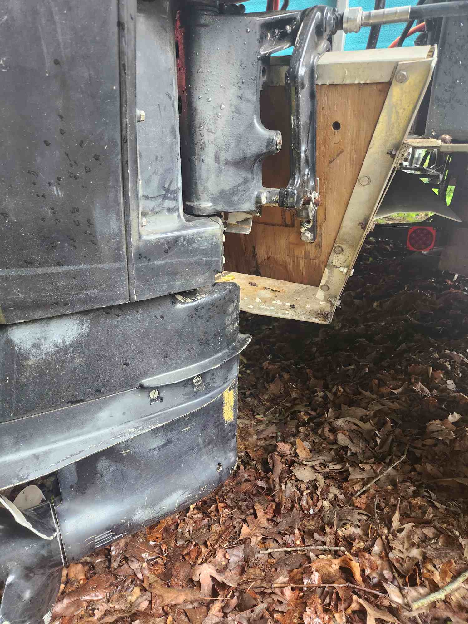

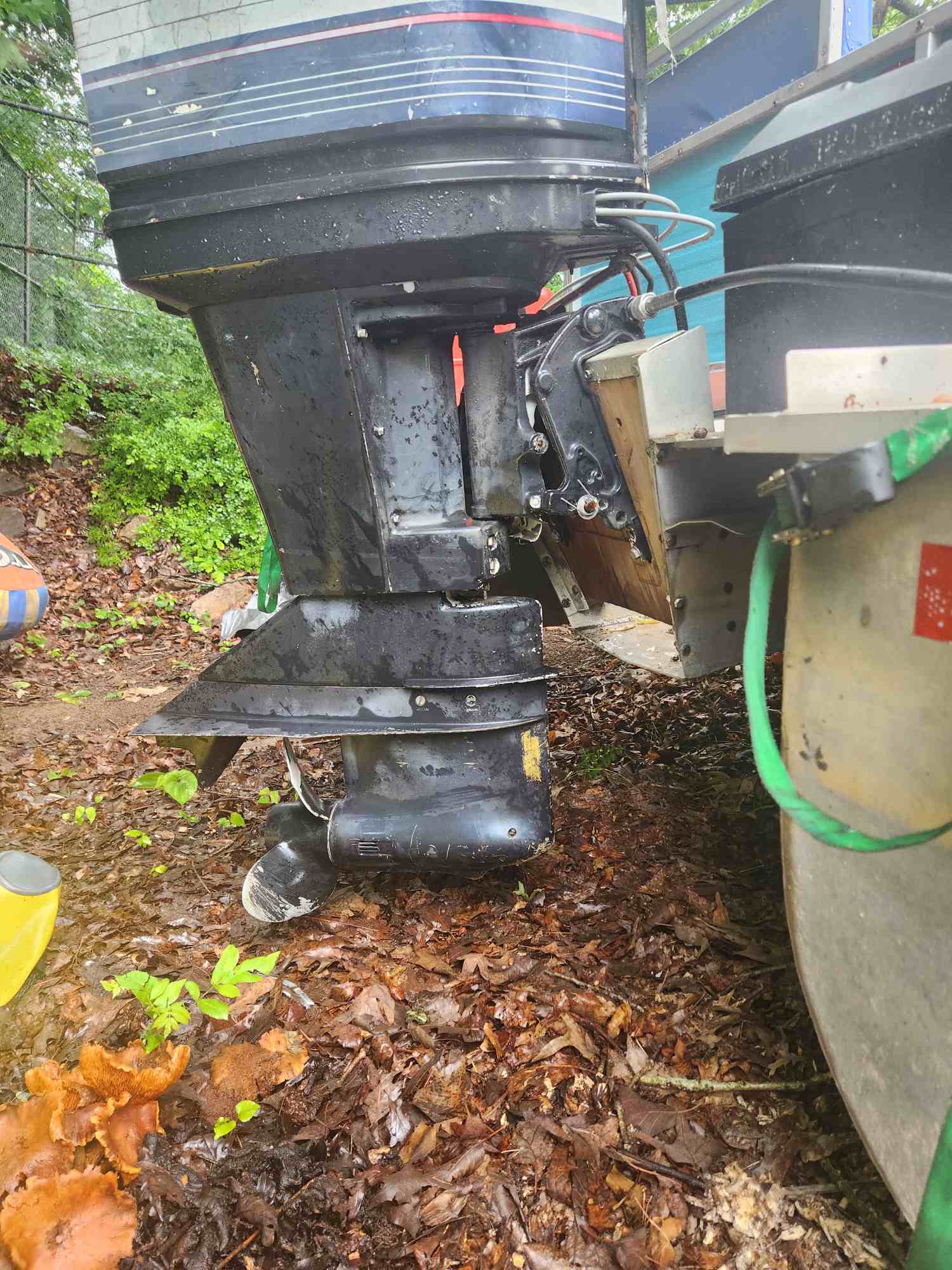

Size your photo to under 1Mb & it will post. It may look like a thumbnail, but if you click on it, it comes up full size.
Voila

On a toon!! That makes a difference.
Google: how to measure a pontoon and outboard for the cavitation plate
Open the video and that should show you the right way to measure it.
Missing the skeg!! that makes a difference in the way it handles.

This guy says to set the motor at least 4" below the waterline. If I drop this engine more than an inch, I'd have my steering cable laying on the aluminum surround. See the photos above to see what I mean.

Now that I've looked at the pics again I see the problem.
When you said if you moved the motor down it would hit.
You have a short shaft motor(20") on a boat that needs a long shaft(25").
