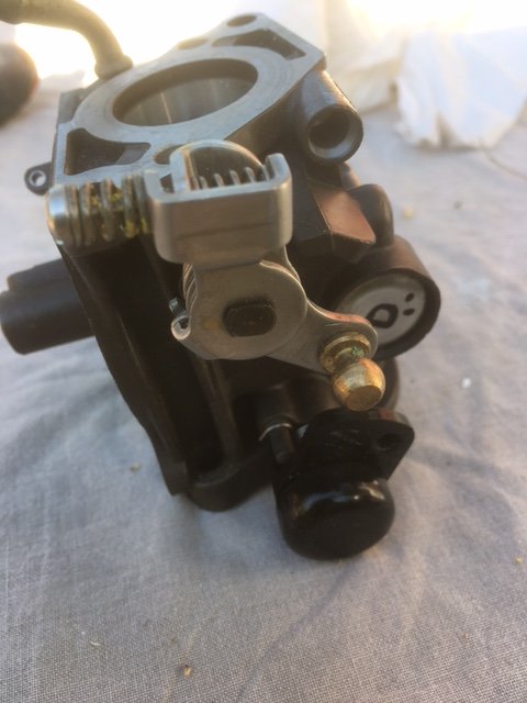

PROBLEM SOLVED!
It was to hight friction between "inner" and "outer" trottle valve arm. I had no control where
#1 carburetor trottle valv was positioned. A little oil and exercise solved the problem with "dead carburetor!
Thank you for your advices. It gave me new ways of thinking. Erik
