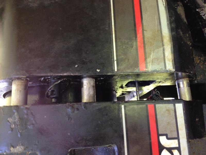

Good day all,
I just performed a gimbal bearing service on my Bravo II. The bearing is aligned as far as I can tell, the splines line up when re-inserting the driveshaft. The problem is I try to push the stern drive to mate with the gimbal housing and it gets stuck about an inch from mating. I believe the issue is somehow related to metal retaining ring for the driveshaft bellows? Here are some pics.... What do you think?

Pull the drive back out a bit. Make sure the shift contol is in neutral.
There should be a clasp that is open on the drive side inwhich the cable end must fit into.
If all that is good and you are sure the splines of the drive shaft are engaged into the hub the use your foot and drive the drive in.
It could be the orings on the drive shaft or slight missalignment of the bearing.

Thanks Jack,
The cable is not the issue and the splines line up without a problem. I do not have an alignment tool but I have made a tool comparable to it and can feel that the backside of the bearing is seated flush as it should be. This might also be a clue, when I try to take the stern drive off again it gets jammed up and requires quite a bit of prying to break free from the gimbal housing.
Yes the bearing needs to be seated and the gimbal bearing outer race (inside the aluminum carrier) is spherical in design, the alignment tool is used to align it and when the tool is thru the bearing but not in contact with the coupler you can "rotate" the bearing. Not round and round like it would normally spin but the entire bearing will move left or right or up and down in a small rotational manner.................Hope that makes sense...........
If it is off a bit it can make it difficult to slide all the way in.
When you removed it did it come away easy? If not then you may actually have an alignment problem.
You can also remove the two orings and see if it will slide in easier............if it does then the orings are causing the friction.
I got it! After I greased the driveshaft I could see that it stopped moving when the bearing hit the O-rings, gave it a couple swings with the mallet, slid in after a couple minutes. Thanks for the help. Now I have to figure out why the shifter is so hard to move from forward to reverse! Have a good night.
